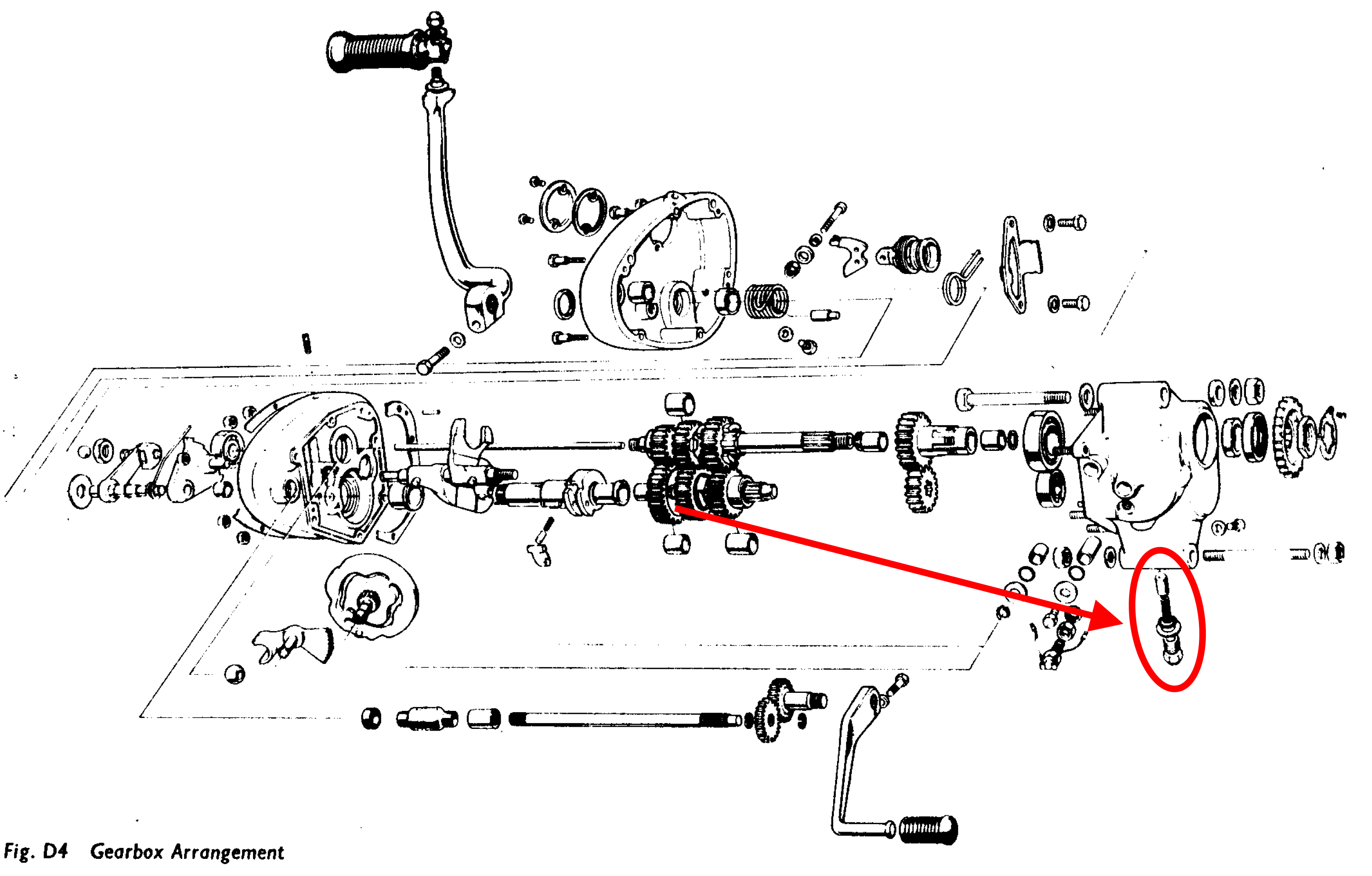

The parts list shows nothing:
gearbox parts

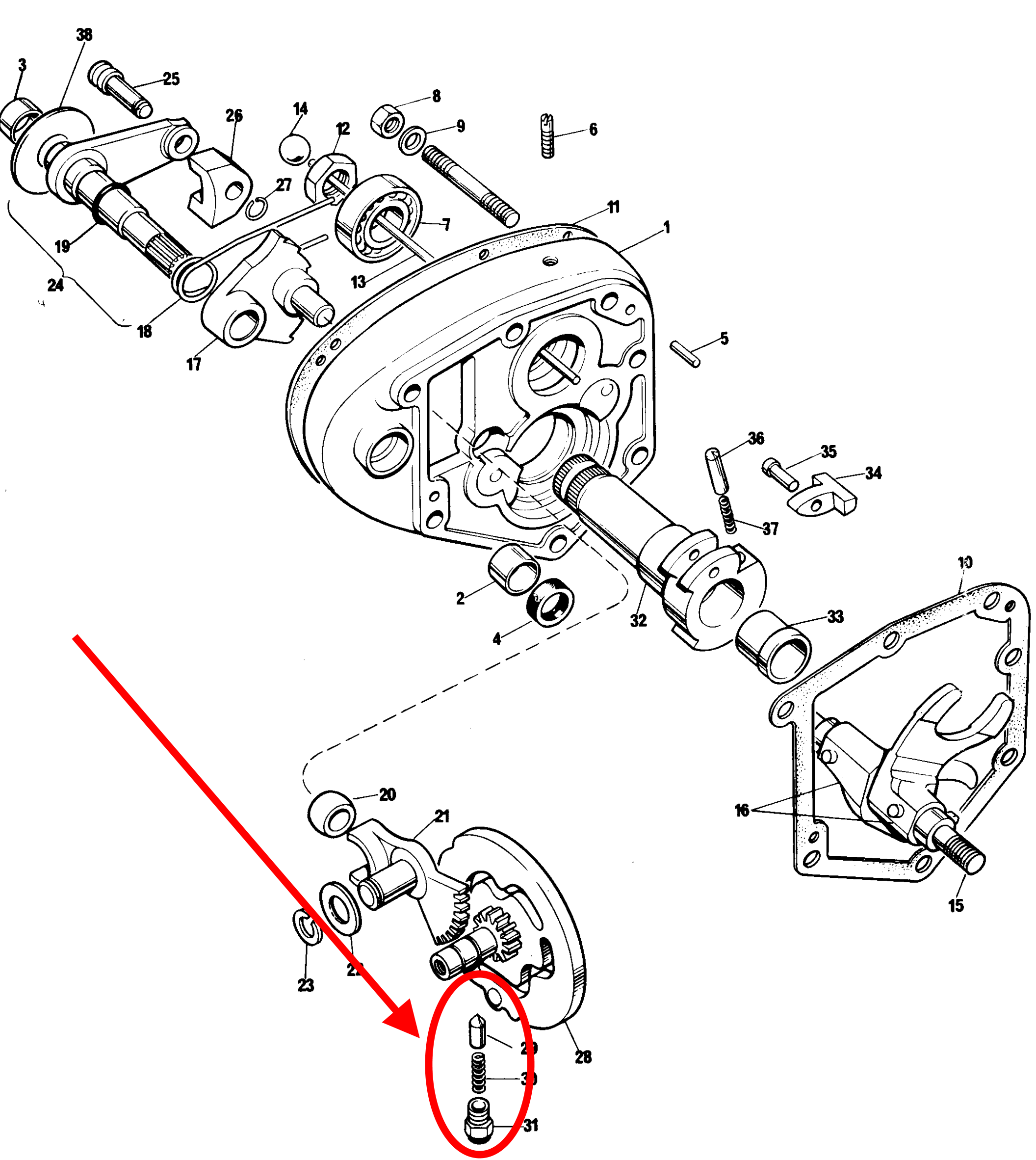

However, the workshop manual does show a washer:
gearbox
