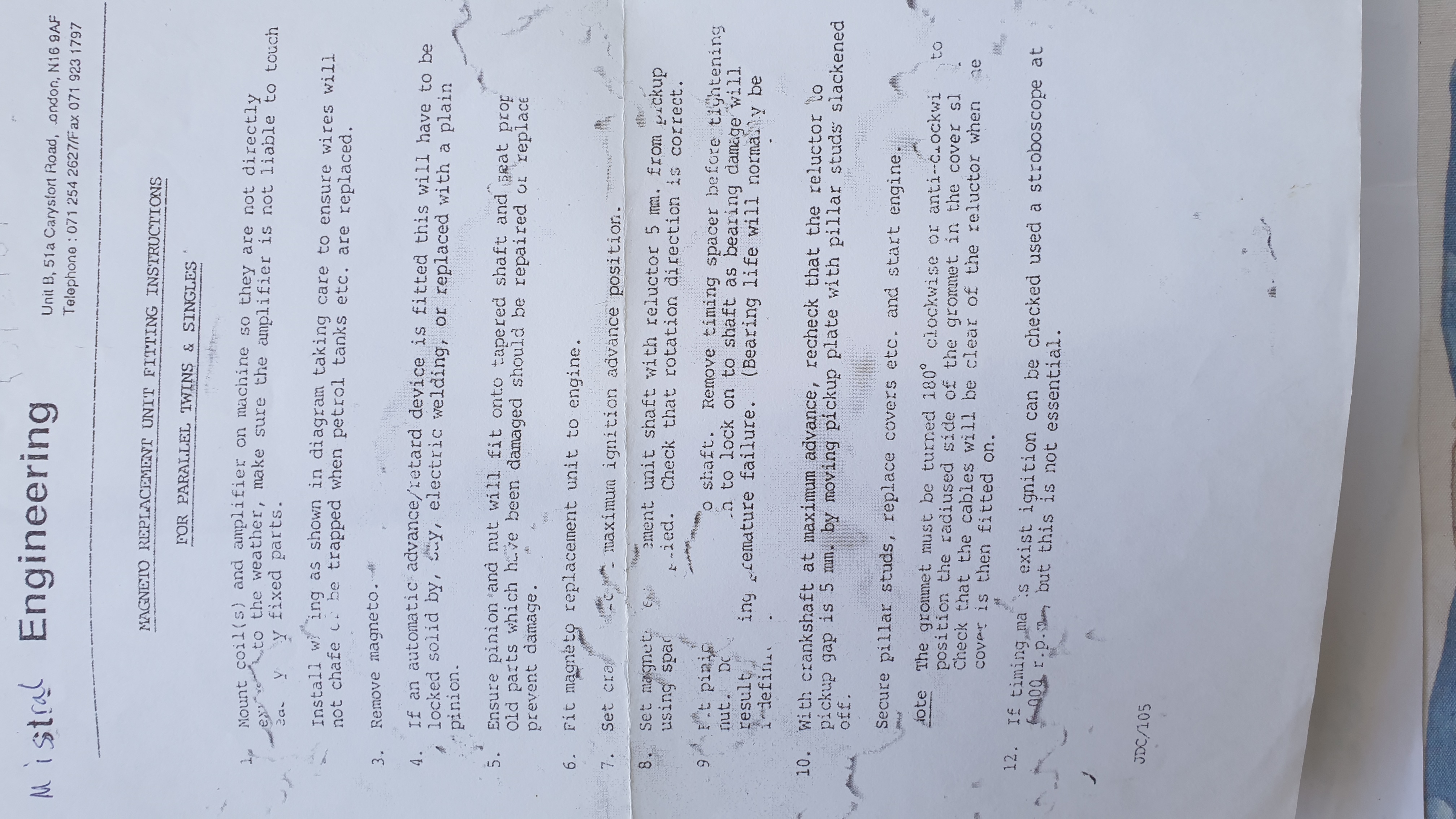

A little diversion from my normal query. With the crank slot used to show position on firing stroke 28deg BTDC; do you then line up the trigger device with the “reluctor” and that’s it? For a points setup if makes sense but I’m a bit confused how the electronic gets set same way. Strobe is on order....
There is a little loose tab…
Perfect,
... now it all makes sense with a 5mm strip. I also found a copy of your document at:
(https://britishonly.com/partsbooks/pdf_Files/rita/ritacombined.pdf).
The bike was bought with it fitted and after a little work on oil leaks I was left with a loose reductor. I couldn't work out if you set it to TDC and ignore the 28 degree slot or it calculated the 332 degrees (360 - 28) from the last impulse...
That will be tonight's entertainment.
Thanks David

Hi David, I have a Rita on one of my bikes ,but no information. Is there any way I can get a better copy?, Don't mind paying any x's, Bob.
I could try scanning the two…
I could try scanning the two pages I photo'd on my phone camera. They are already photocopies after the original was partly eaten by slugs! Hence the gaps...
Comprehensive details in the link
Robert; If you open the link I sent to David in the response there is a 30+ page document on installation/testing of a Rita for several models of machines, singles, twins, triples and even Magneto replacement.
If its not opening I'll email them to you... and some others I found whilst should be working....

There is a little loose tab that came with the system. It's probably hidden in a box somewhere. Easy to make another. I'll see if I can dig mine out later to measure it. This sets the gap (about 5mm) between the tip of the reluctor and one of the two tips on the rotor. I always have to look up the instruction sheet to get it the right way round. When I can't find the instructions, I google for them!
