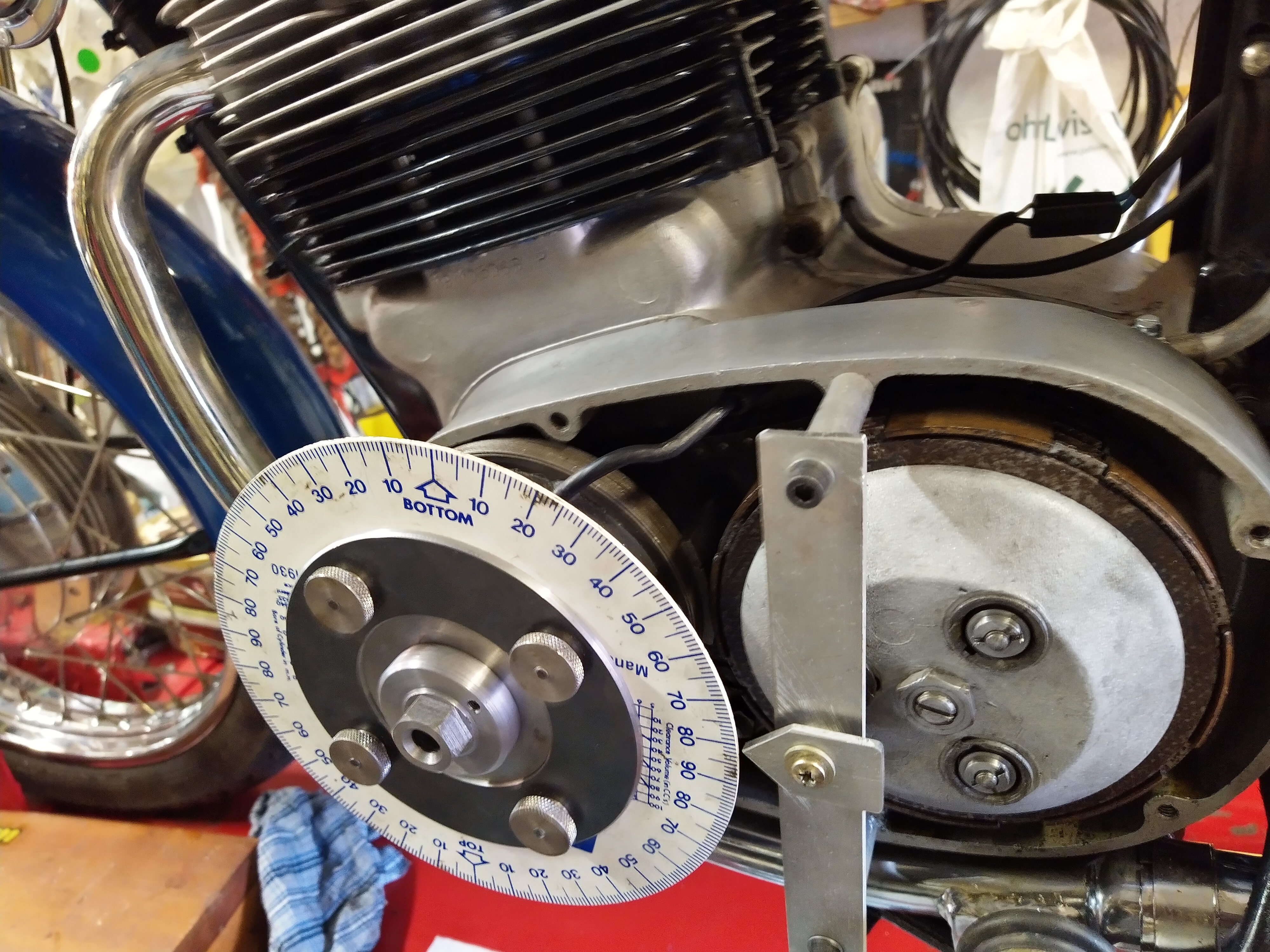

This is the setup I used for timing my Navigator. I set the Boyer system statically as described in the Boyer instructions then used a strobe to set accurately. Both cylinders very close, it got me thinking, has anyone tried dividing the ignitions stator plate to time each cylinder? (As with the points setup).
I made a nut for the crankshaft with a male threaded extension to carry the timing disc.
Why is it the Navigators timing is 24 degrees while the other lightweights are 30/32?

Strobe light mandatory!
I also have a Boyer which I thought was on spot with static timing. Lightweights are very sensible to corect timing. In my case the engine seized twice because timing was off 15- 20 degrees towards TDC.
Despite my "correct " timing marks ! Definetly use a strobe lamp to set the igintion properly.!

thats an impressive set up, I use a disc printed off the net stuck onto card with a wire pointer!
