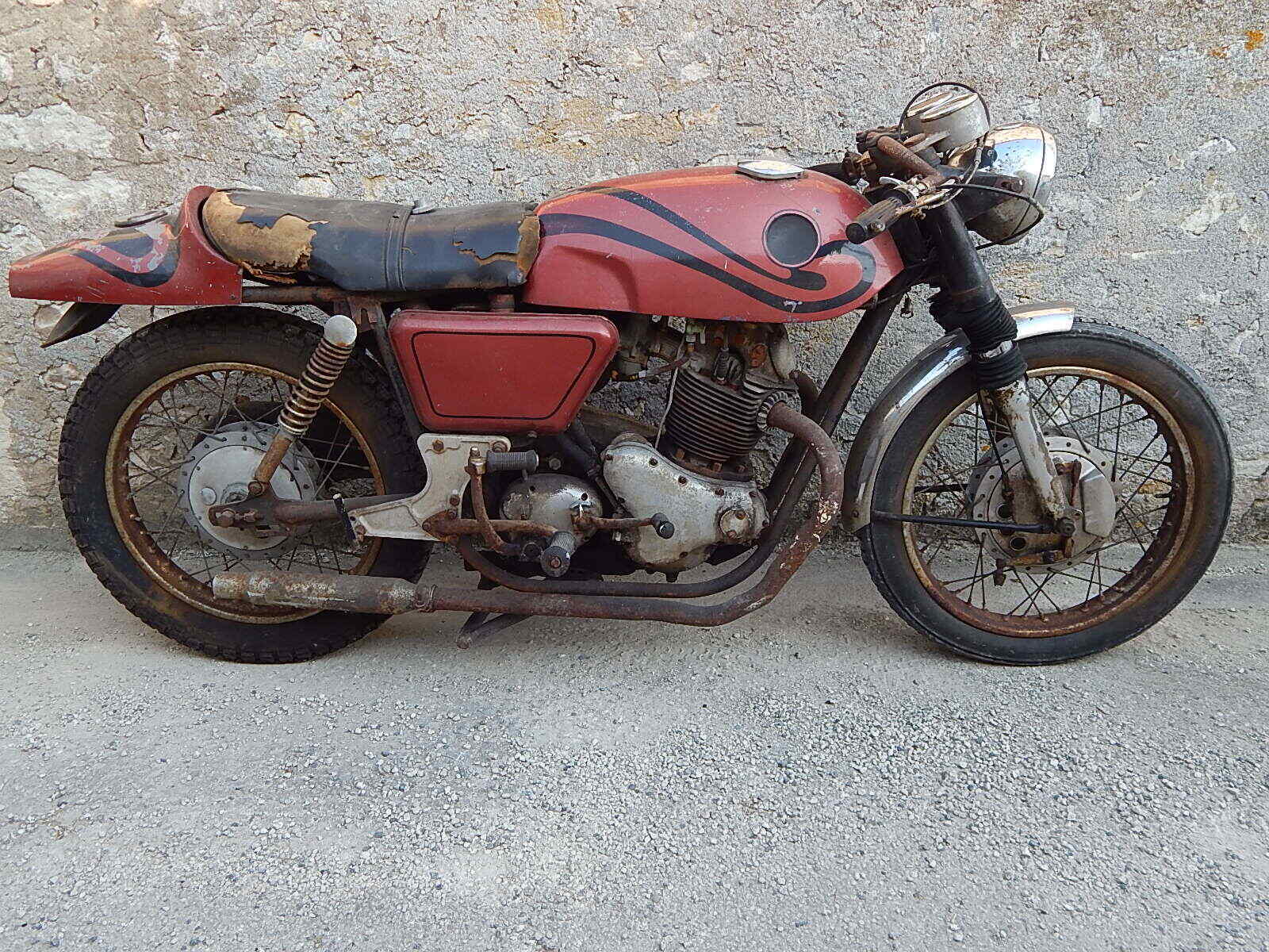

I come here as the new owner of 126188 Commando 750 Fastback. I believe serial:126125 was the first off-the-production-line bike?
It would be good to understand where in the line this bike might have been.
The bike is yet to be delivered so I can go through it. The previous owner (who bought it in the US shipped it back to restore) tells me he found original silver on the underside of the red painted tank. From the pics he sent it has the logo depression on the tank and faskback (so post exhibition), stacked coils, No recall mod to the headtube/ toptube. These are some of the easier things I can identify so I am obviously hopeful this one is indeed a very early pre-'fastback'.
I am aiming to fully restore the bike as original. It is very beaten up and (storage)seized so a lot of time and dedication is required. These are my kind of restorations!

I'm still trying to like the Fastback tail...
63rd ish off the line, so…

63rd ish off the line, so early but not rare, lots of Fastbacks about.
For the Widowmaker frame which will need the lower rail added.
