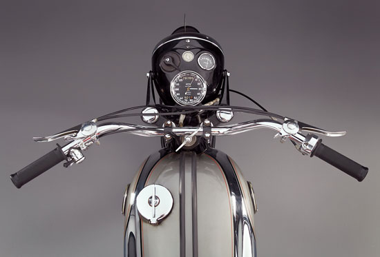

The early 50’s handlebars came with a shaped plate fixed to them with tapped holes to receive that switch.  (You can get them to clamp on also). That picture looks like a resto machine so may not be authentic.
