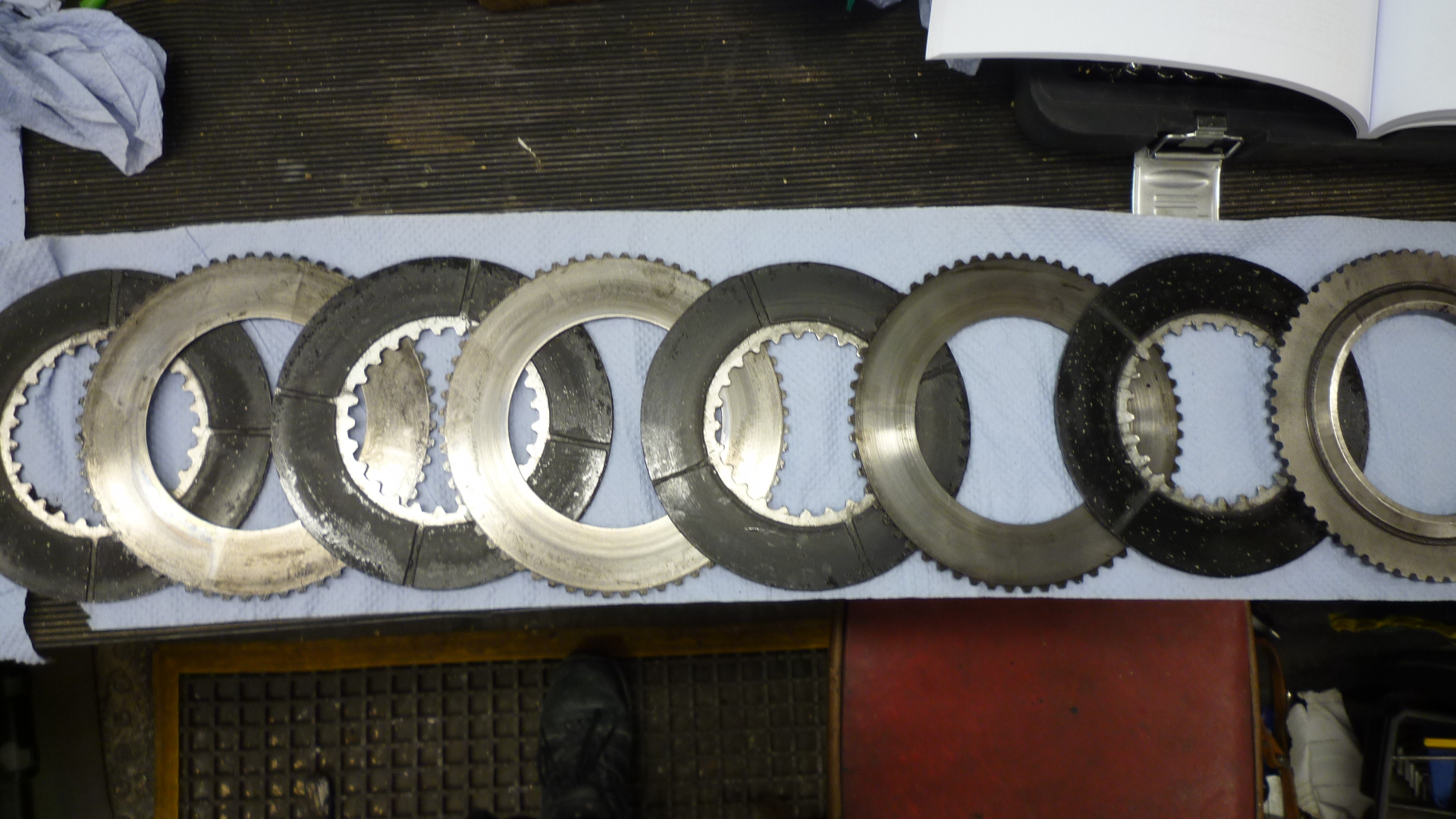

So it's apart and this is what I have. 2 friction plates are slightly under size approx 3.54 which I guess are meant to be 3.6mm although all seem to be visually in reasonable condition.
RGM don't have them in stock and Andover was £85+ vat for a full set!
The cable is attached to the box as in the picture and seems about right to the untrained eye however is the routing correct going through that bracket and grommet?
please see pics.
Oh and the oil is a bit manky what's the most common used?

Feels like success! I bought a 3mm and 4mm plate from RGM. Tried the 3mm and it did feel better but was still stiff so out with that and in with the 4mm. Still plenty of room for the circlip and still heavy for what I'm used to but more than usable.
Haven't ridden it yet so hoping for no slip but I can't see a reason why it would as there's still slack in the cable after adjusting it up. Just got to give it a go, thanks for the advice.
