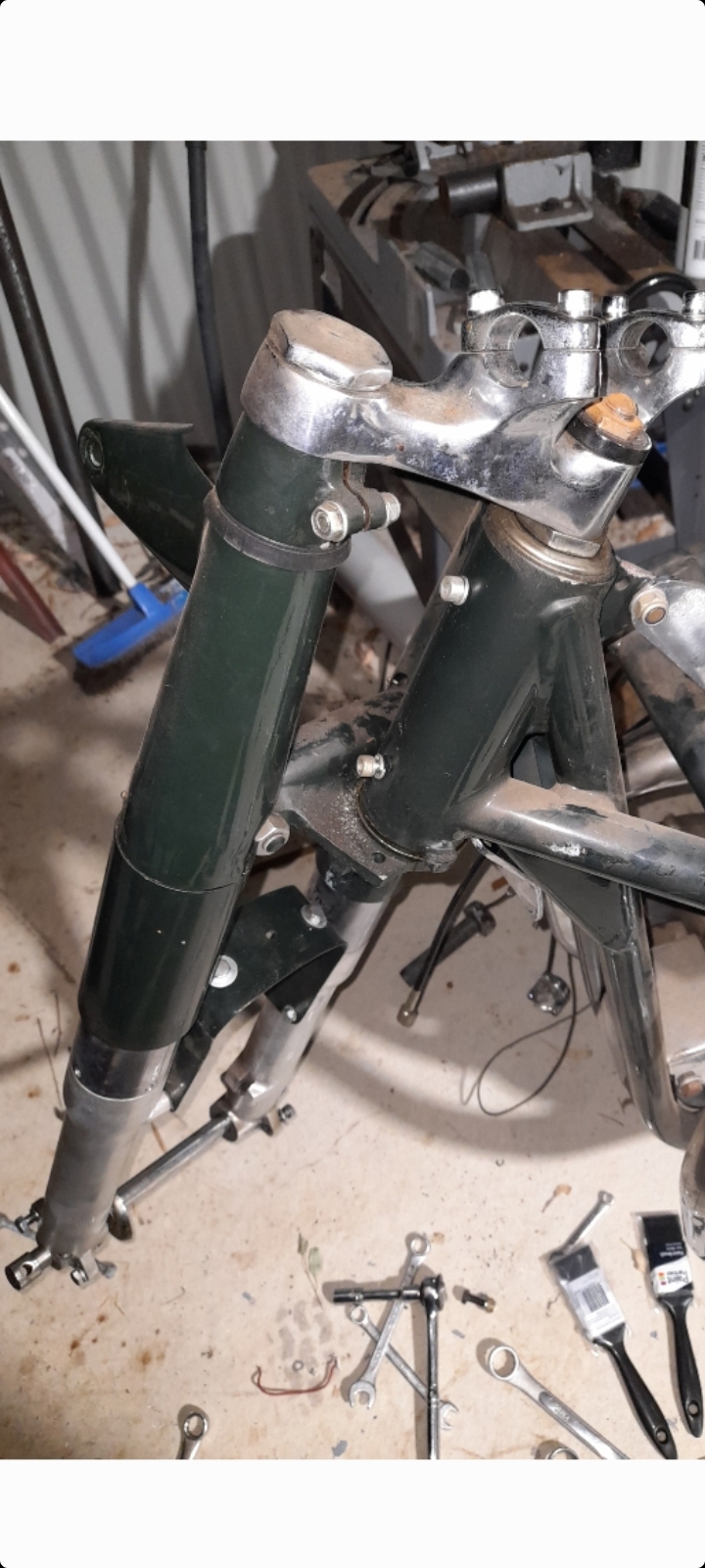

Can someone identify whats going on here.
Got a Model 88 off a family member and have started restoring it. Something doesnt look right. From photos of other bikes, the headlamp brackets should go to a rubber spacer then to the top triple tree. This one has some sort of extra piece ontop of the rubber spacer.

The rubber cushions engage around the top of the headlamp bracket and then there is about a further 5mm space until the top of the ears on the brackets. I suspect that you have the incorrect headlamp brackets for a set of short roadholder forks. Good luck, howard
I think Howard  Has  it right.  The HL brackets have been sawn in 2  and  the top rubbers inserted between the cut.   New brackets required  unless you want a very low position for the headlamp
Hi Steve,
   I think what someone might have done is to fit these forks to an earlier lugged type frame. The head-stock on these is longer than the featherbed, about as much as the extra spacers. I have done this by using a bespoke extra long top steering column sleeve nut. The benefit of this is to reduce the steering angle and make the steering sharper. Try loosely assembling the forks into the frame and see how it all fits up with-out the top pieces of the shrouds. Another method of doing this mod would be to extend the column tube on the bottom yoke (triple tree) for the extra length.
Robert - HL brackets dont appear to be cut and the spacers are not part of the bracket. They are thick, solid steel. Look like legit parts from something..
Richard - Shes a matching numbers bike. Slimline frame, motor, gearbox and forks all match records. Think i need to find out what the lengths the HL brackets should be and I guess column tubes on bottom yolk to see if they have been modified..
Steve
The top of the HL brackets have been  modified   so I would not expect them to fit  standard forks.
Just a thought, would clip-ons have been fitted at one time, then removed and the spacer inserted to make up the gap?

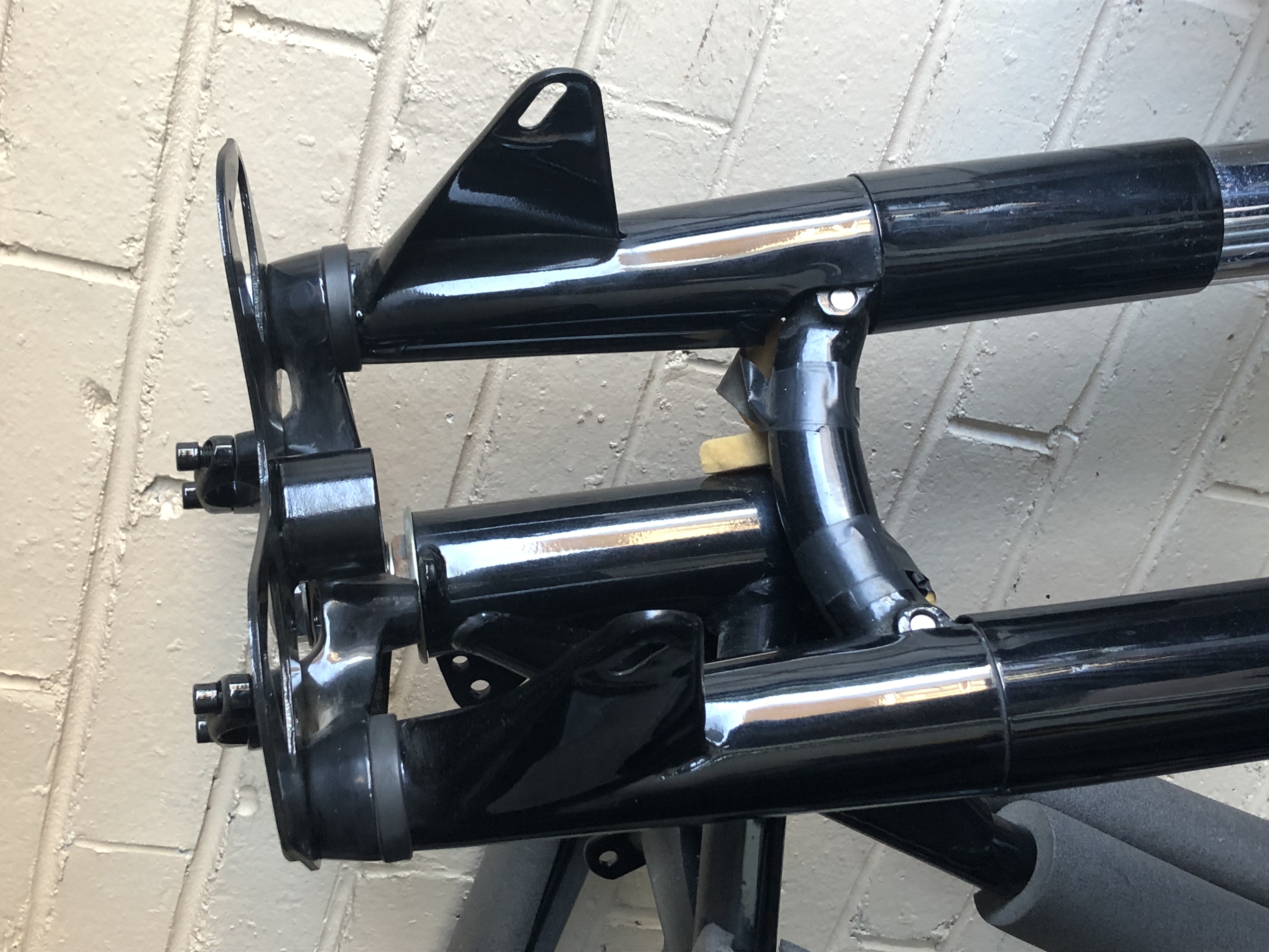

Steve, not sure if it will help, but here is a photo of my Atlas headlamp brackets. I cannot measure their length exactly with them installed, but from the top of the mounting rubber under the top yoke to the top of the lower shroud they slot into it is 205mm.  From memory, the engagement with the lower shroud was about 4-5mm and the slot in the top rubber was about that too, so 205mm could be about right.
Andy

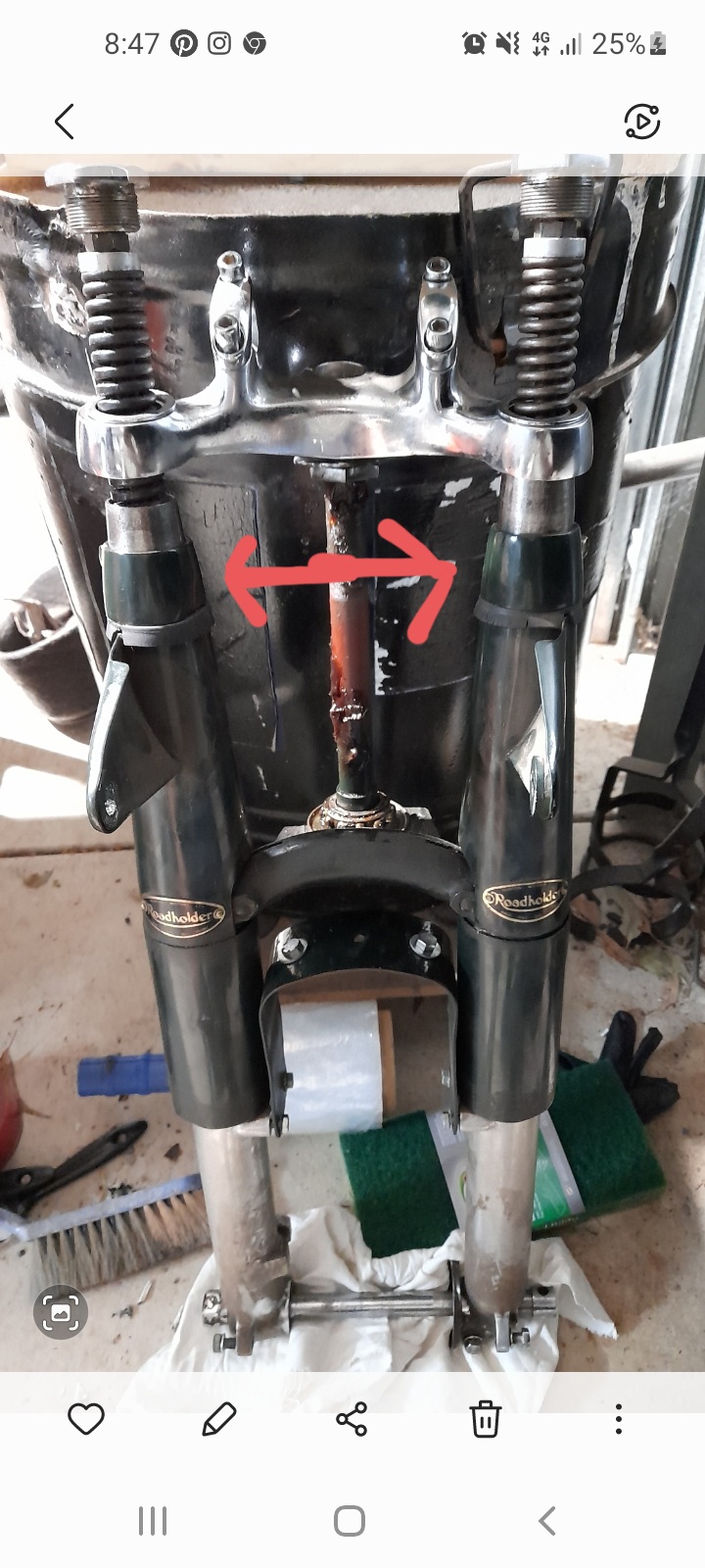

Found another picture from when forks were on the bike. I can only think the HL brackets have been modified.
