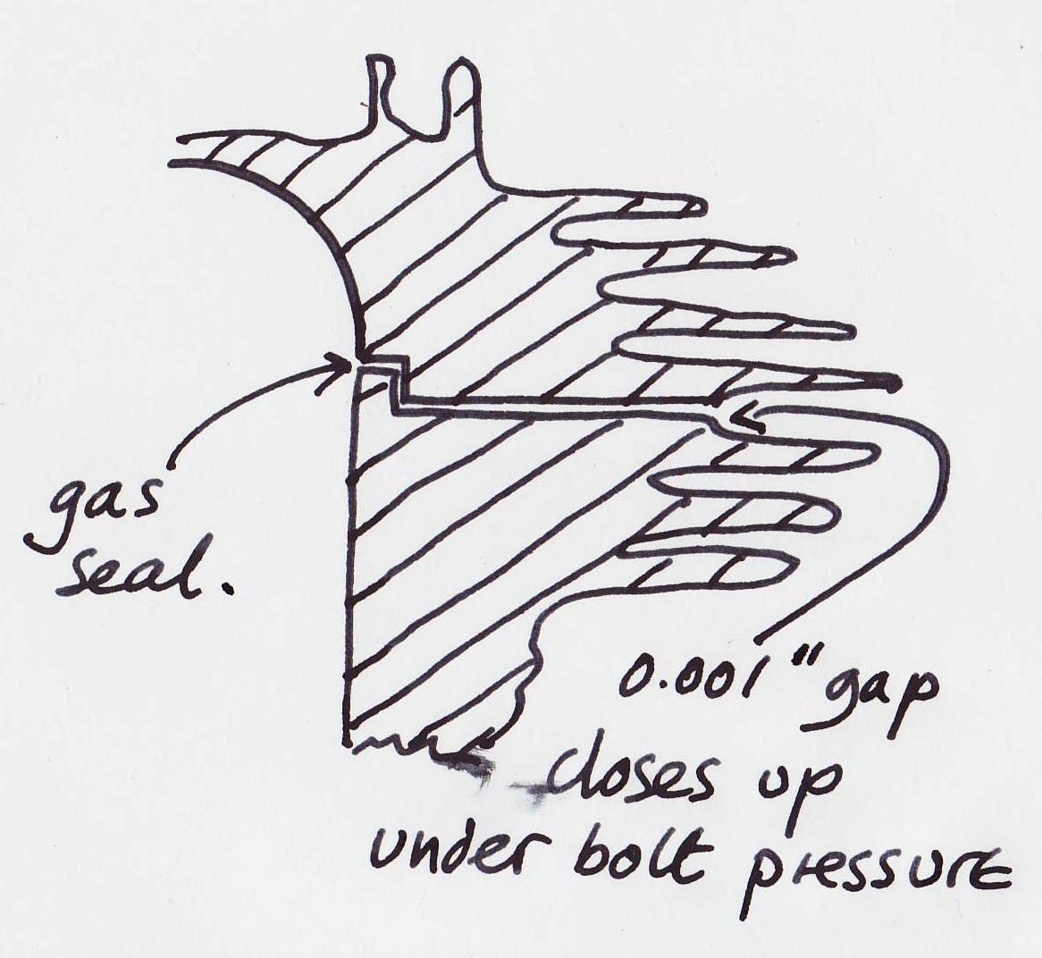

Head Joint Detail
Just to add a little to Paul & Richards description of the lapped joint, here is the late George Cohen's description and sketch.
CYLINDER HEAD JOINT
An all the single cylinder engines I have worked on (from an all iron head & barrel twenties OHV to an all alloy sixties DOHC Manx) the same principals and engineering apply.
There is NEVER a gasket. The idea is known as the “double ground joint”.
The theory is simple, the engineering a little more difficult.
The head joint comprises of two parts; the spigot interface and the wider head barrel joint. Say, the spigot on the barrel is 0.125 inch high, then the recess in the cylinder head needs to be 0.124 inch. This means that the seal is at the spigot joint and the wider joint is to prevent distortion.
The practically, especially on well used alloy top ends is a tad more difficult. If you measure the spigot height on the barrel, it is unlikely to be the same all 360 degrees around. The same applies to the wide surface on the barrel. With frequent and less frequent heating and cooling over 50 years the original manufacturing tolerances have been lost and distortion has taken place. On a fifties Manx engine I worked on last year the barrel, at the wide flat surface was distorted by 0.008 inch and at the spigot, 0.005 inch. The cylinder head was worse, with the wide surface being 0.013inch off flat!
Consequently these defects need to be corrected.
Mounting the barrel in the lathe and truing up and machining is relatively easy, but the cylinder head is more difficult. A special jig has to be made up to allow the truing up to be established. A good medium size lathe, grip true facility, magnetic face plate and some clever thinking is required.
The goal is to obtain a double joint with the spigot of the barrel mating in its recess . For Iron head and barrels, there is rarely any distortion and the easiest way to obtain a good joint is as follows: Hold the cylinder head upside down in the vice (securely but without causing any damage). Put some coarse grinding paste on the broad surface and fine in the spigot recess and add a few drops of thin oil to both. Carefully fit the barrel onto the head and with a anti-clockwise and then clockwise rotating motion, lap the two together. After a few minutes, wash of all the paste and oil and inspect. You should be able to see the lapping on all surfaces. Repeat until a perfect face on both broad surfaces and spigot are established.
Torque Iron set ups to 45 ft/lb and aluminium one to 32 ft/lb. You can use a very slight smear of either a hard setting goop or even a smear of oil or grease, which will burn hard.
Hey Presto, no more oil leaks.
To achieve the gas seal on the top of the spigot, and still close the gap on the wider flange, the spigot should be just 0.001" taller than the recess in the head. If you want to eliminate the aluminium gasket you should measure the spigot and recess on your components. You may find it necessary to skim the head to achieve the correct depth of recess (and note George's comments regarding distortion). Some years ago Mike Pemberton carried out this work on my 19S (Alfin head), together with the valve oil drain o-ring mod. Definitely the right way to go - until then I could never eliminate the oil weeps from the head joint despite frequent changes of aluminium gasket.
