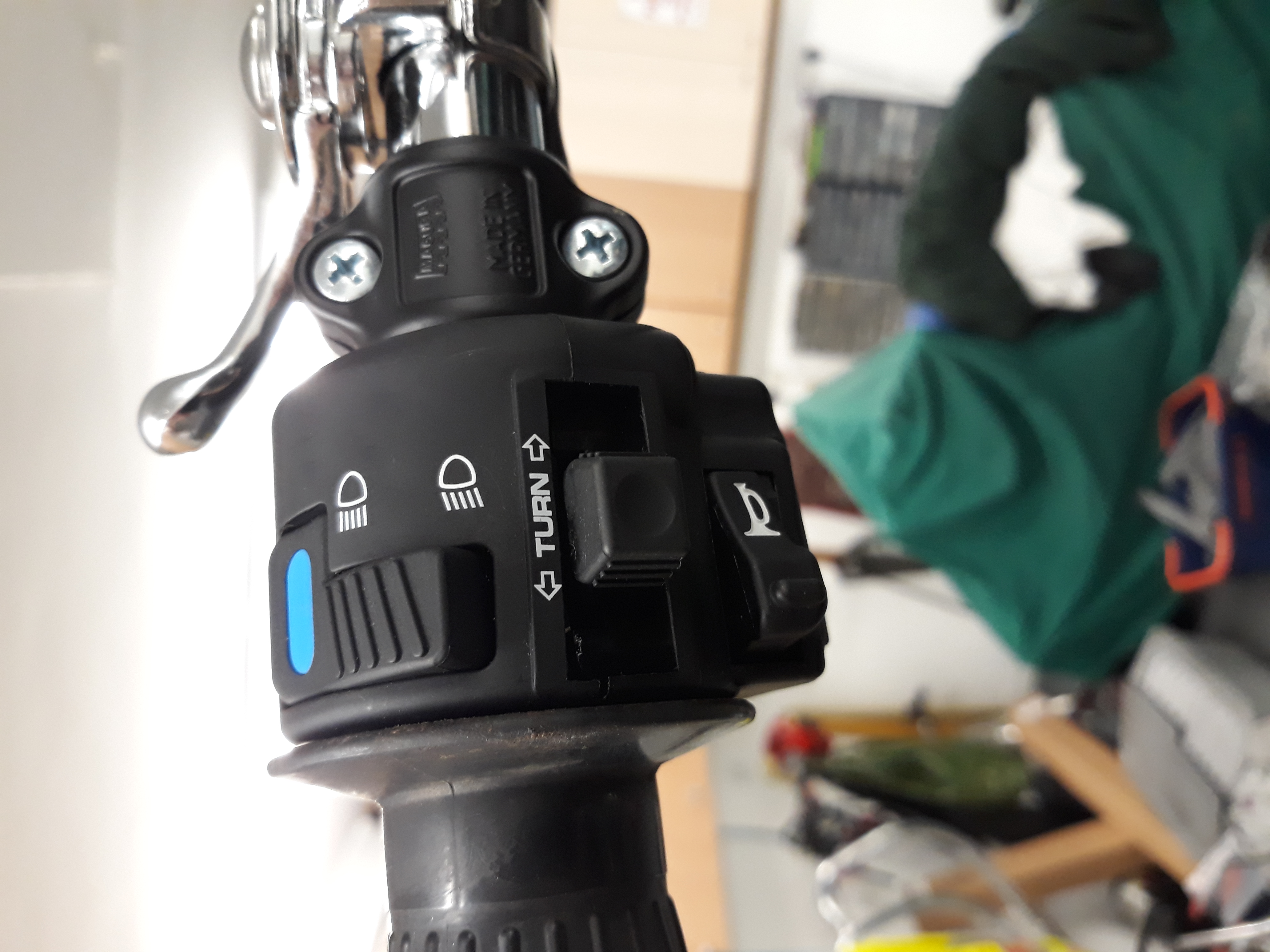

Hi Malc
I have managed to wire it, if used you will loose the ignition kill (no big deal to me) and all controls will move to the left side. It will free you up to use any master cylinder for the front brake.
I bought it from Colorado Norton Works.
