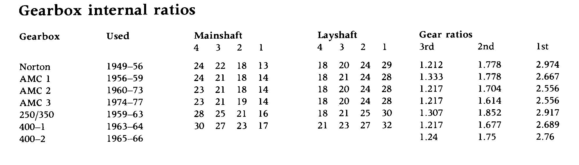

Robert is quite correct about the internal gear changes which created the AMC 2 box used in the post 1960 Dominator range. Attachment shows revised gearing. The outer, inner and kickstart spring plus its fixing position also altered. The problem with these AMC 1 & AMC 2 gearboxes is how easy it is to mix and match chunks. Like with the Norton Timing Cover there are multiples of options for the gearbox outer cover if you include some AJS/Matchless, Commando, Dominator and Mercury versions. The clutch cable entry point wandering all over the place to begin with.
I once purchased a Norton box which the owner had dismantled and could not remember how to re-assemble. He said that it was an AMC 2 box. It wasn't but for a £100 it was still a bargain and the gears and bearings all turned out to be in mint condition. A small investment in different outer and inner covers plus a new kickstart spring and 23 tooth output gear converted it to near AMC 2 status and suitable for my 650 Cafe Racer.
