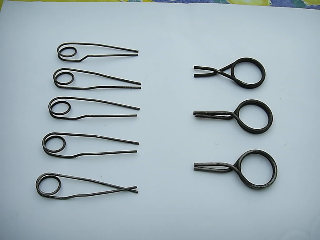

Mix & Pick
This photo is typical of what you can be up against. A small selection of AMC Gearbox springs all purchased at the same auto-jumble. Ony one from each set actually worked correctly.
4th one down on the left and…
4th one down on the left and top one on the right?
Agh! Selector pawl springs…
Agh! Selector pawl springs the AMC 'box Achilles heal let me down twice many miles away from my comfy bed.
