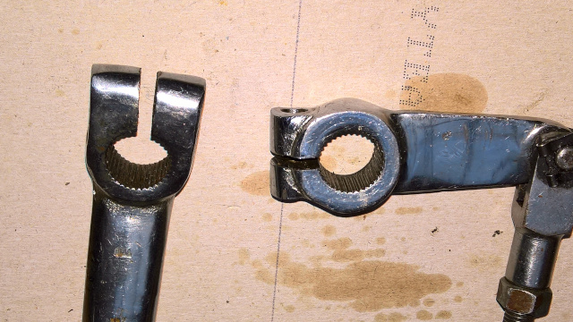

Other than chopping up existing levers, can anyone suggest a source for the gear lever spline coupling. No lever, clamping eyes not necessarily required. Unplated steel (or aluminium). Something to weld a fabricated lever onto.
I.e. the splined end of these:

What exactly are you after?…
What exactly are you after? A round steel boss with splines cut in the middle? I cut the splines for my rearset levers from alloy but can do steel as well.

I'm after some donuts (boss if you prefer) with a spline cut through the middle. I can then slot and add a clamping loop (or whatever you'd call that brazed on bit the bolt goes thru) and braze on a piece of 5mm flat to make the lever arm. I can weld aluminium but steel is easier to mess around with. I did wonder whether I could use an old shift shaft as a broach and wack it thru with a flypress - might work with aluminium. But if you can make them we should talk. I'll PM you with a bit more of an idea of what I have in mind.
