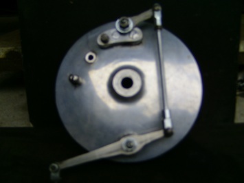

I have converted an 8 inch norton single leading backing plate ( later type ) to a twin leading set up. Basically I created a 1968/70 Triumph set up on the norton backing plate. I used 8" triumph shoes cut down 5mm on each side, Triumph spindles and springs. I built up shoe abutments, moved the anchor point for the cable and the backing plate to fork slider. I have followed the Triumph dimensions for the activating arms and clevises.
All seems to work well as a bench test. I will soon put the backing plate into service on a friends feather bed ES2. If it is a success I will strip it down, take some pics for anyone who has many spare hours in their life.

I have been toying with the idea of making my single leader into a fully floating brake by using triumph shoes and a modified pivot point, but the plan is on the back burner during the riding season.
I have attached a couple more images of the backing plate which might prove helpful to you with your project. I am having problems testing the brake, I will have to look into getting another bike with the right front hub.

Back again! It has taken time to fit and test the brake on my friends ES2. I have ridden about ten miles around the suburb where I live, working the front brake to bed it in. Considering such a short period I would say it has been a successful exercise. It seems to be on a par with the standard Norton twin leader at the moment but it is early days yet.
I am hoping that once run in it will perform as well as the Triumph twin leader it is based on. Once bed in I should get the same servo response that I get on my S8 Sunbeam which has the Triumph brake. The servo effect is very strong on the Triumph brake. This is because the self centering has a wedging effect on the shoe at the opposite end to the cam end. Hopefully when the brake is bedded in it will require less effort on the brake lever which is the case on my Sunbeam.

I don't really wish to be the harbinger of bad news but looking at the photo of your front brake has serious alarm bells ringing for me. In a normal set-up the top and bottom levers should be nearly parallel to each other in terms of relative position. Any position much different from this generally indicates an incorrect adjustment or badly worn drum. It looks to me like you only have one shoe actually doing a decent job. I suggest you use the search box (top left) to check out tips & hints on TLS adjustment.
Previously ian_soady wrote:
It does look odd but it depends on the cam profiles.
When I built this brake I spent a lot of time making sure it would perform and be SAFE. When I made the actuating arms I spent less time as I figured that it wasn't worth spending hours making them if the brake didn't perform.
When triumph made the arms they would have used a jig and a stamping machine to make the square hole which locates on the square end of the cam spindle. I used a hacksaw, drill and a file. I wasn't too fussed about the accuracy as I intend to make new ones which will be a copy of the shape of the Norton arms. These will be parallel and polished.
So although the set up looks wrong, I have set up the linkage so as the two shoes hit the drum in unison. The bedding in process will ensure this as it is likely that one shoe will be ever so slightly ahead of the other.
