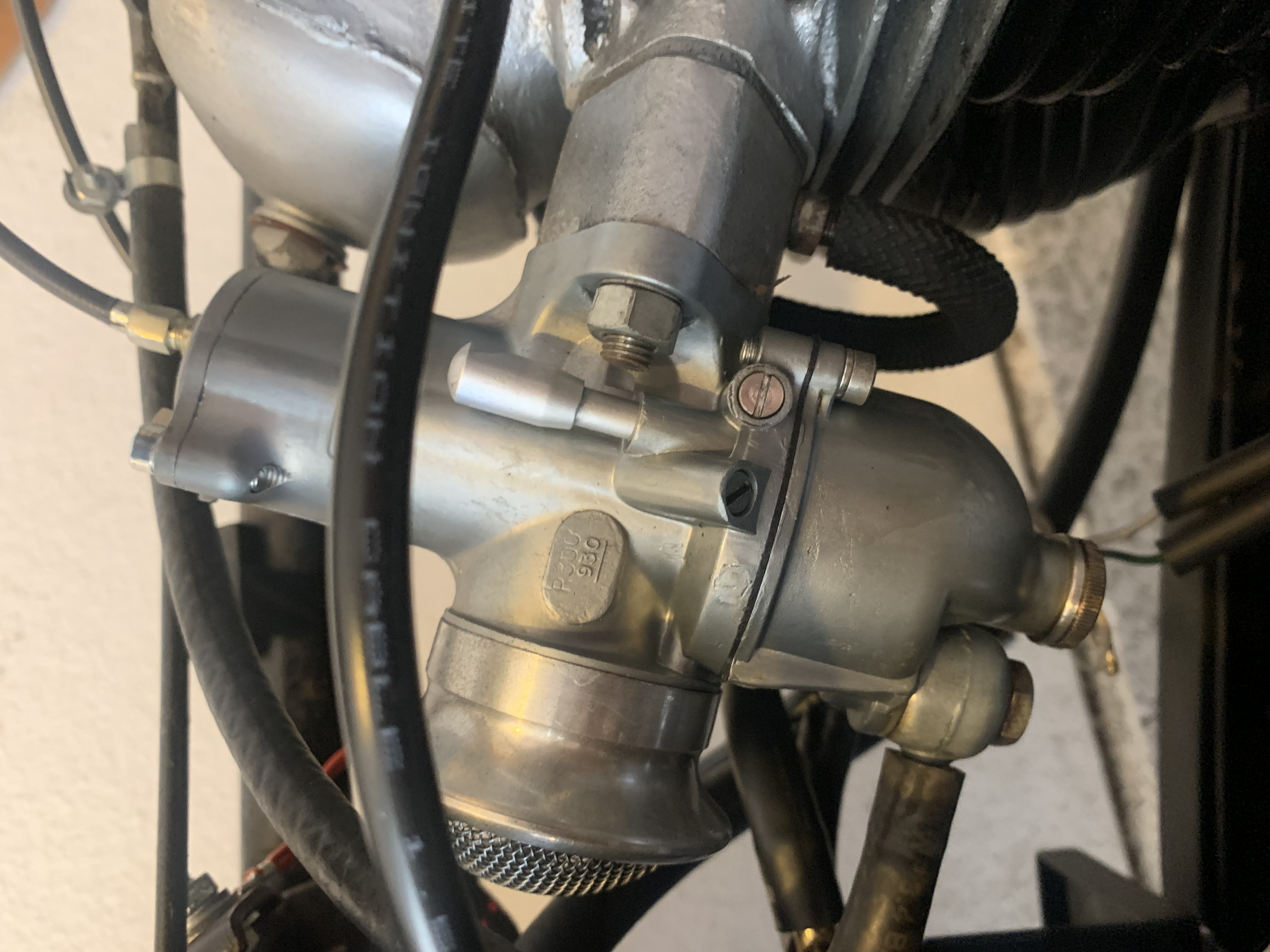

The right 930 carb on my Atlas is leaking and will be disassembled for inspection. Is there a clear way of measuring the float height adjustment?

The float levels were set to .080" below the float bowl, the bowl was filled with gas with a clear tube on the side of the carb, and this shows that the the fuel level is about 1/4" below the .210" mark. It looks like the floats need to be re-adjusted so that the level in the clear tube comes closer to the .210" mark.
Should the carbs be vertical when doing this check?
