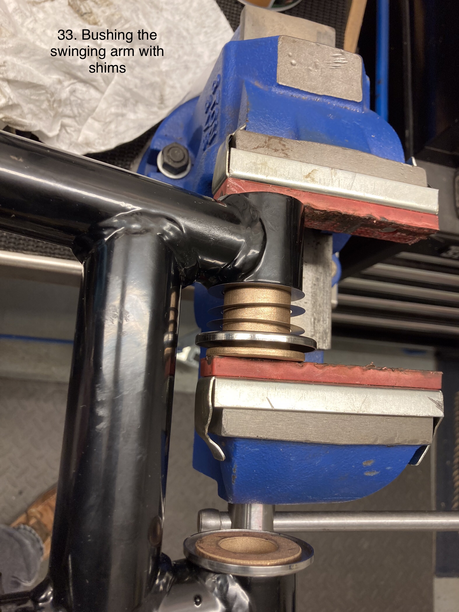

I have replaced bushes is a freshly powder coated swing arm. 1962 Navigator.
I blanked the holes so no paint went in the bores. I polished the inside of the bores with emery until they were shiny. I made sure the bushes were rust free on the outside.
By using threaded rod, (biggest metric that will fit the hole in bush) nuts and some washers of various size to suit bush and swinging arm I was able to pull the bushes into the bores relatively easy. Lightly grease the bores first.
Hammering at the bushes to fit them is not advised.

Great info & pic thanks Steve!
will give it a try.
