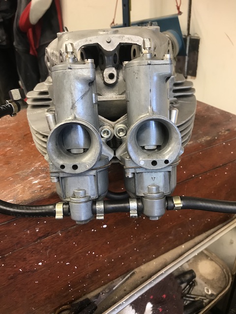

My rebuild/restoration of a '62/3 650SS is progressing apace. I'm aware that originally, this bike would have been fitted with a pair (well, one and a half) of Monoblocs. I don't have any of those but I do have a pair of 30mm Mk1 Concentrics. I don't expect that I'm the only one to fit these, so how do you get a spanner on the two nuts between the carbs? They are reduced hexagon nuts but with the concentrics in place, getting any sort of spanner on seemed impossible. The 'unused' casting for the throttle stop screw and air screw get in the way.
I know this will horrify a number of people but I removed some of the unused carburettor casting and also reduced to outside diameter of a 3/8" drive 3/16" Whitworth socket. With that done I could just about get the nuts tightened.

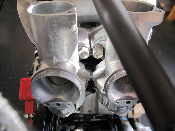

Remove the studs and replace…
Remove the studs and replace with Allan bolts as per attached picture

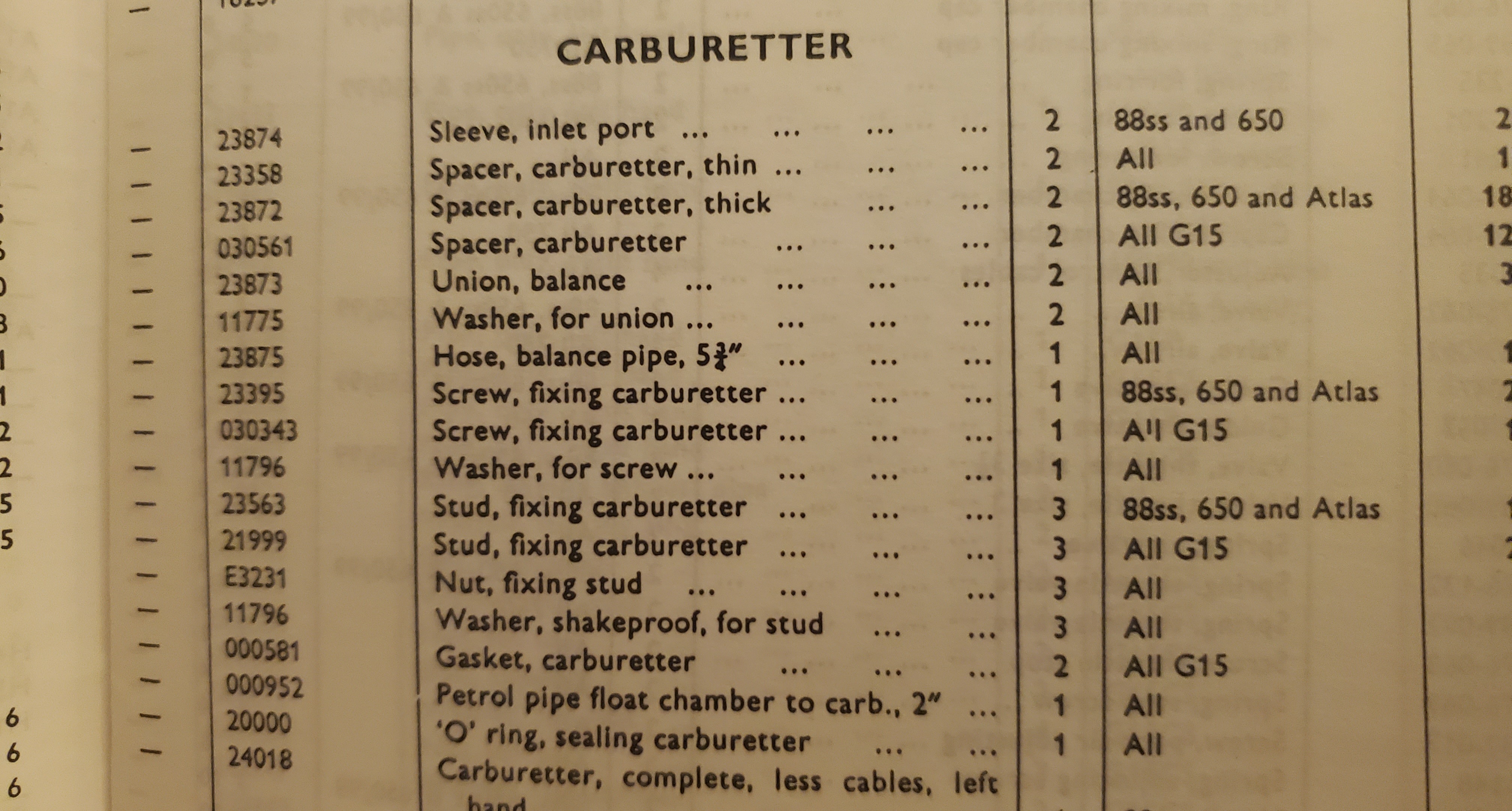

Extract from parts list…
Extract from parts list shows 3 studs + 3 nuts + 3 washers, and one fixing screw (without a washer).
Yes, I realise that now... I…
Yes, I realise that now... I bought a "Carburettor fixing kit" from a well respected Norton spares supplier that consisted of 4 studs, 4 reduced nuts and 4 washers. I'll know, next time...
It's fairly common practice…
It's fairly common practice to file a bit off the blank bosses, to fit Concentrics parallel.
I have Concentrics on my 650SS. To get around this problem I used Allan bolts instead of norm bolts and no longer a problem, no other modification required. Good luck
