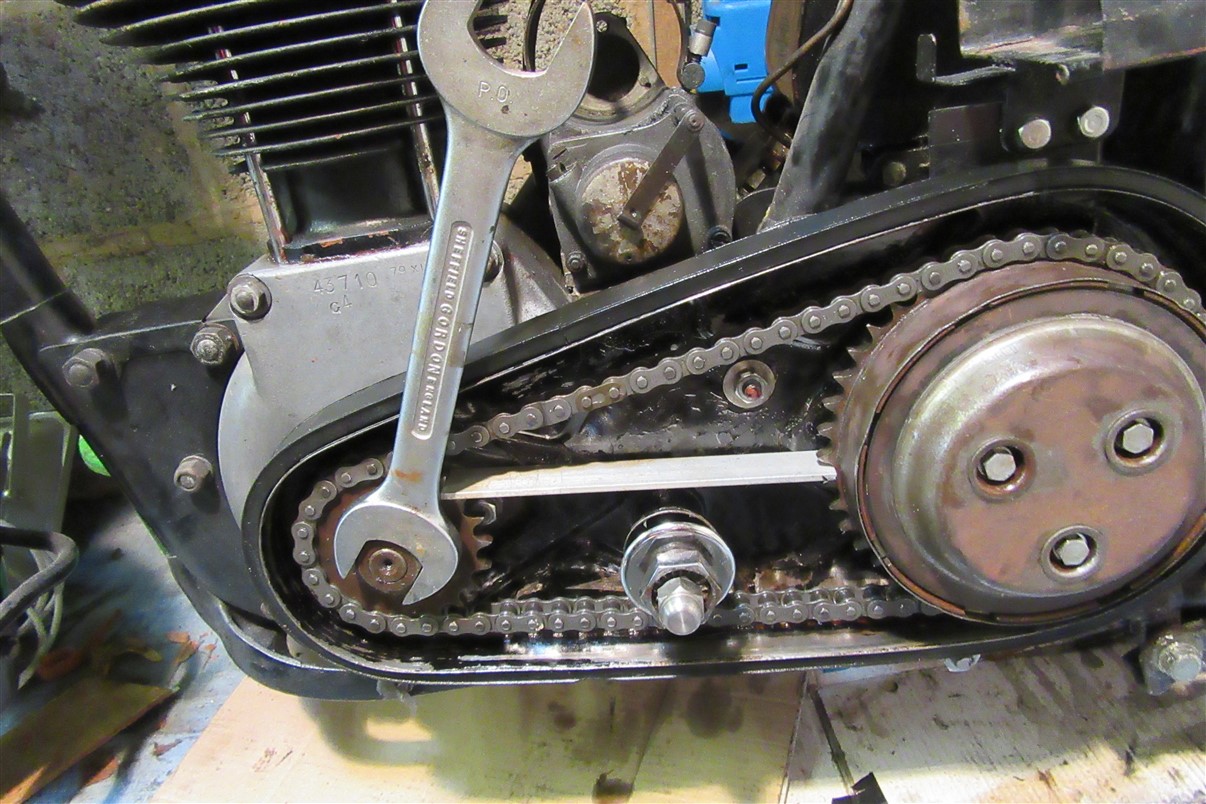

I always use a sprag for engine sprocket nuts as I think it's kinder to the power train - and never wedge things between the back wheel spokes as some barbarians do!
Any old bit of alloy or mild steel will do provided it's strong enough to take the compressive force. The pic shows it in position for tightening.

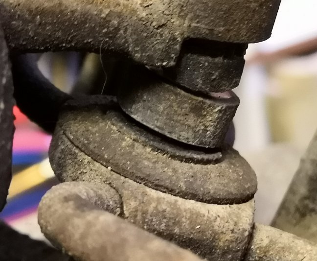

Well don't know if it's really the valve adjuster, because there is a screw and a nut on the rocker to adjust.
Looks like a "pellet" to protect the stem. BTW we had 0,6mm of play on admission valve and 0,7mm at exhaust.

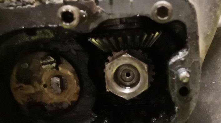

Today we managed to take the big nut off the crank LH side with a 1"3/16" socket. Might not be exactly the good one because we had to help it jump on the nut with a plastic hammmer.  But with an impact wrench, I prefer a little too tight than a little too lose. And double check the thread before you press the button. At the end, some small marks on the flat parts of the screw, but not on the edges.
For RH side, we are going to need to be a little smarter not to spoil the bevel gearing. And the nut looks to be left handed. Is it true ?
I've already seen the vintagenorton caution, thanks ;-)
Hi Christian,
   The photos show the tappets are correct although you have a valve cap on the exhaust but not the inlet. You need to take care with the rocker adjusters as it is easy to break the fragile split adjusting part. Before trying to dismantle these it will be best to heat the rocker ends and use some penetrating oil on the threads. First make sure there is a gap between the valve and tappet then undo the small locking nut while holding the adjusting hexagon still. Unscrew it a couple of turns but do not try to turn the large adjusting hexagon. Next use a piece of alloy to protect the centre contact pad and small lock nut so you can tap it gently with a hammer to loosen the taper fit where it fits inside the tapered adjuster. Remove the small lock nut and then carefully try and undo the adjusting hexagon. Do not use excessive force, if it does not move use more heat and oil. Be just as careful when you re-assemble and never try to adjust the clearance with the taper tight together. This set-up is tedious as you have to tighten the lock nut and check the clearance. If it is not correct then loosen it and the taper for each adjustment so it may take several attempts to get it right. Inlet is 0.3mm and exhaust is 0.5mm.
   There may be a similar problem when you remove the left-hand nut and the half-time pinion from the crankshaft. This gear is also a taper fit into the crankshaft bevel gear. If you try a sprocket puller and use too much force it's easy to break or chip the gear teeth, use heat and a tap with a piece of hard wood and a hammer before using the puller.

Glad to learn that there is a bucket only on the exhaust, was wondering about needing to file the stem's head to get the inlet valve off from its guide because of the hammering.

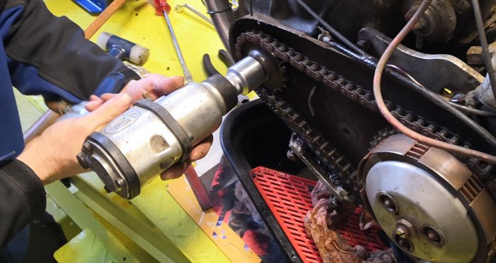

Really easy to take the LH nut off with an impact wrench. Took three tries to adjust step by step the power of the tool, and zzzzzzz it went off.

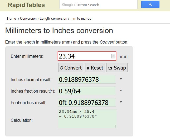

In a conversion table I can see that what I measured on the bike, 23,34mm, is 0.91889" or 59/64".
But when I then look at dealers shop, nobody is selling this size.
When looking on the net for a 59/64" Whitworth socket, all I can see are "square" ones.
Still have a lot to learn, so where am I wrong?
I have a note on the workshop wall where it says 1/2W = 23.37mm. 1/2" Whitworth sockets are quite easy to get.
Am I wrong?

Ah, I see what you  mean .  The Bucket on the EX valve is common mod but not standard as I know.  It helps when setting the angles with respect to valve stem length, rocker/ cam wear,  valve seat intrusion and of course a replaceable wear item instead of hammering the top of the valve stem.    It is more common on the exhaust valve due to the extra heat

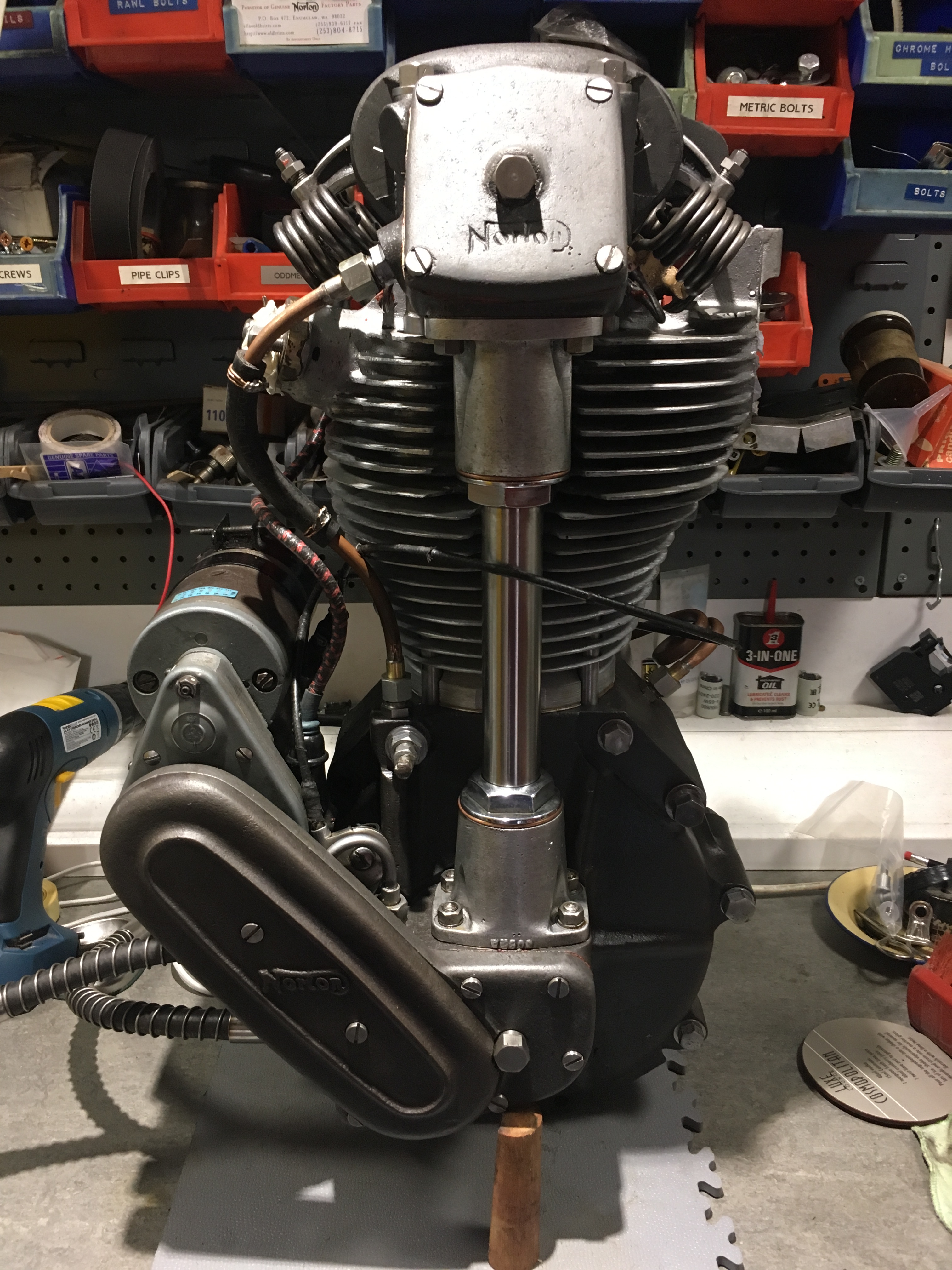

Cracked mag platform necessitated a weld.  Outside my skills so Stu got it done for me.  On the basis it had to be stripped to deal with the crack, decided to get the casting dipped in the di chromate tank.  Needed to be stripped of all ferrous and non ferrous fittings  then when complete all threads cleaned out and rebuilt. That took a 12month period. All items cleaned, bearings replaced, bore honed, new rings , cam box repacked, reassemble, timed and sealed up.  For an 82 year old engine there was little wear and it it had clearly been well cared for.
