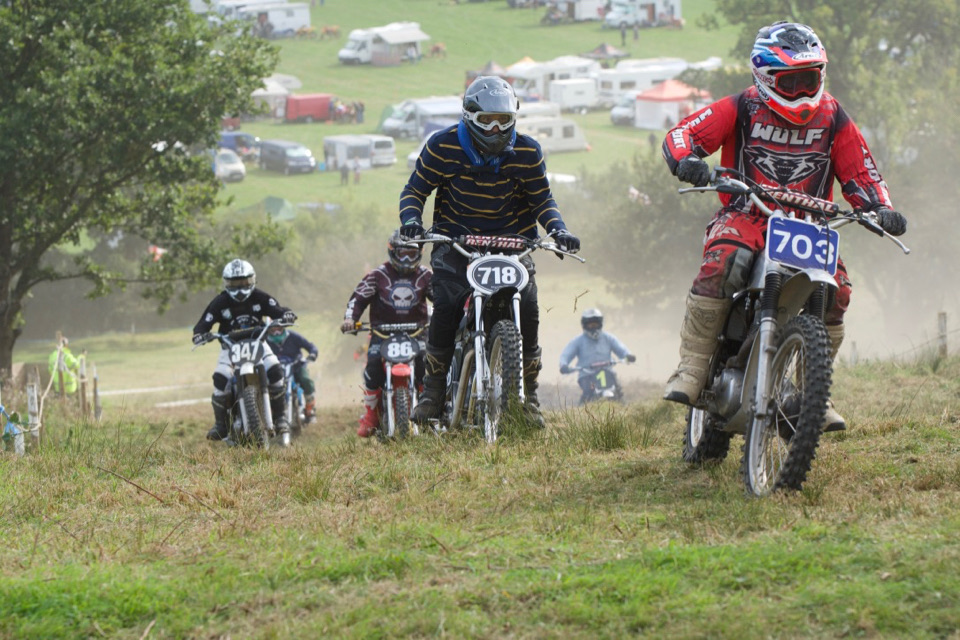

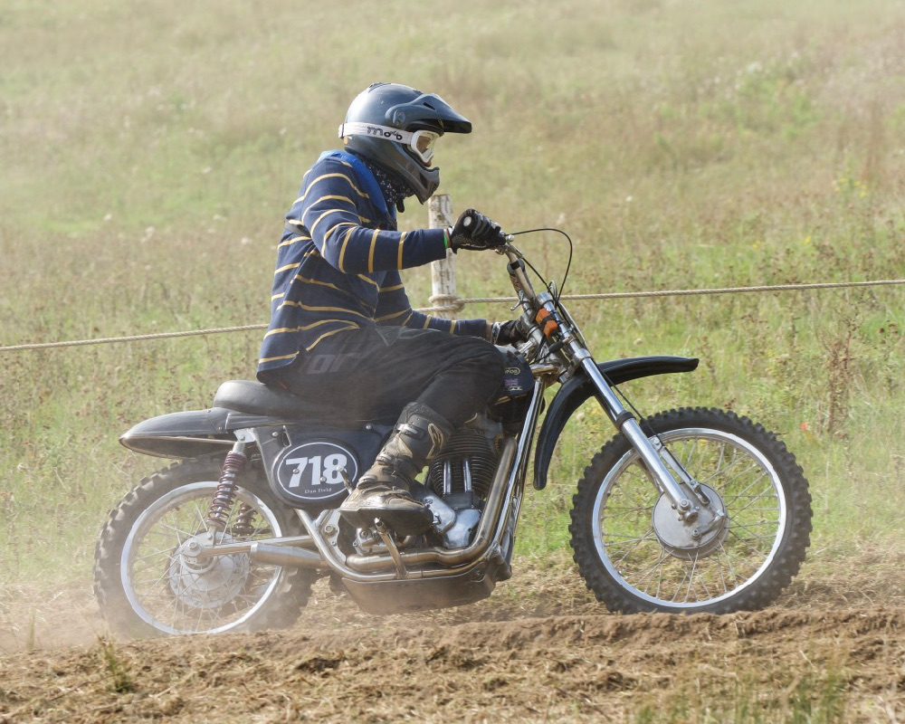

Dave, I was worried I’d be spending most of my time fettling but actually it behaved superbly! The track was bumpy hard and dusty but it handled remarkably well, in fact I got a 6th in the first race!
I think the only think I need to work on is the footrests which sit about 1 1/2 inches out from the chaincase and gearbox, I need to bring them in and drop them a little. It’s fair to say that my internal organs were well shaken but I came off the track after each race with a smile on my face!
Here are some pics.
