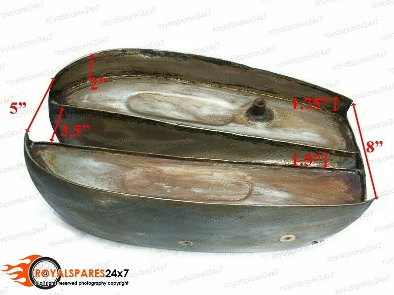

Anyone know how I can tell the difference between a wideline & slimline featherbed petrol tank, maybe by letting me know the width of one of the other. I have attached a photograph from an advert for an Indian slimline tank giving measurements but are they correct?

Not sure since it's over 50 years since I had a wideline but my guess is that this tank is for a wideline as their tanks are secured by the strap over the centre top so don't need the captive nuts below.
The 8" rear width matches my…
The 8" rear width matches my slimline, so would it fit a widening? But the screw sockets on the side don't match the chrome strip on the slimline.

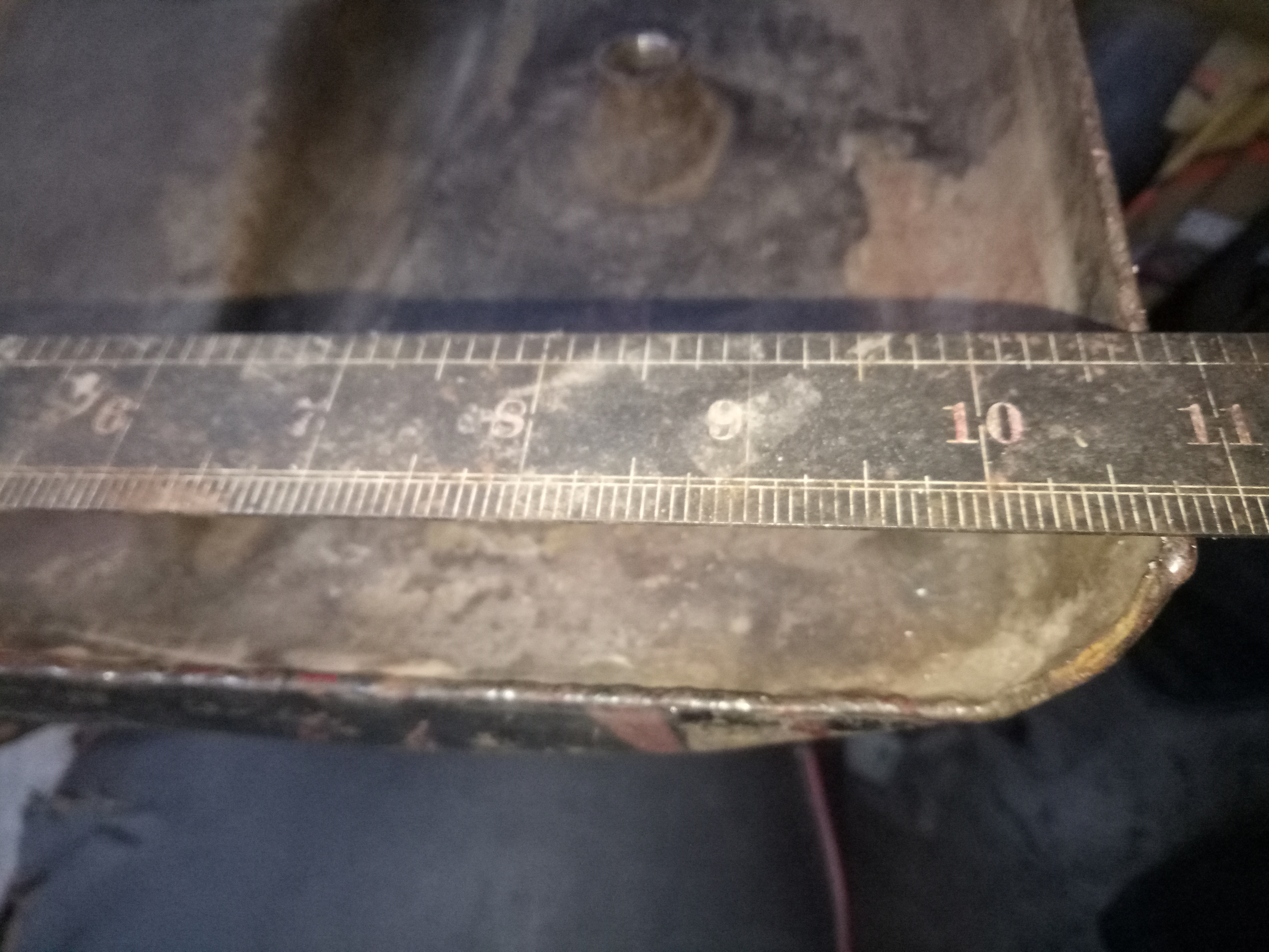

Paul, I have just measured the rear width of my 1953 wideline model 88 tank and it is 10.5" across. Photo attached.

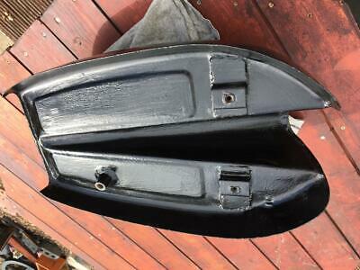

Your tank looks like a semi finished slimline tank. It should look like the one in George's photo.

I have just taken the dimension of my wideline tank at the rear and it is the same as Ian's as shown in his photo, i.e., slightly over 10.5".

On the dimensions, but a slimline tank has/should have two threaded brackets near the front where it is bolted to the frame, and a hook on its rear (where the seat touches the tank) for the rubber band to hook over.
see below for what it should look like.
