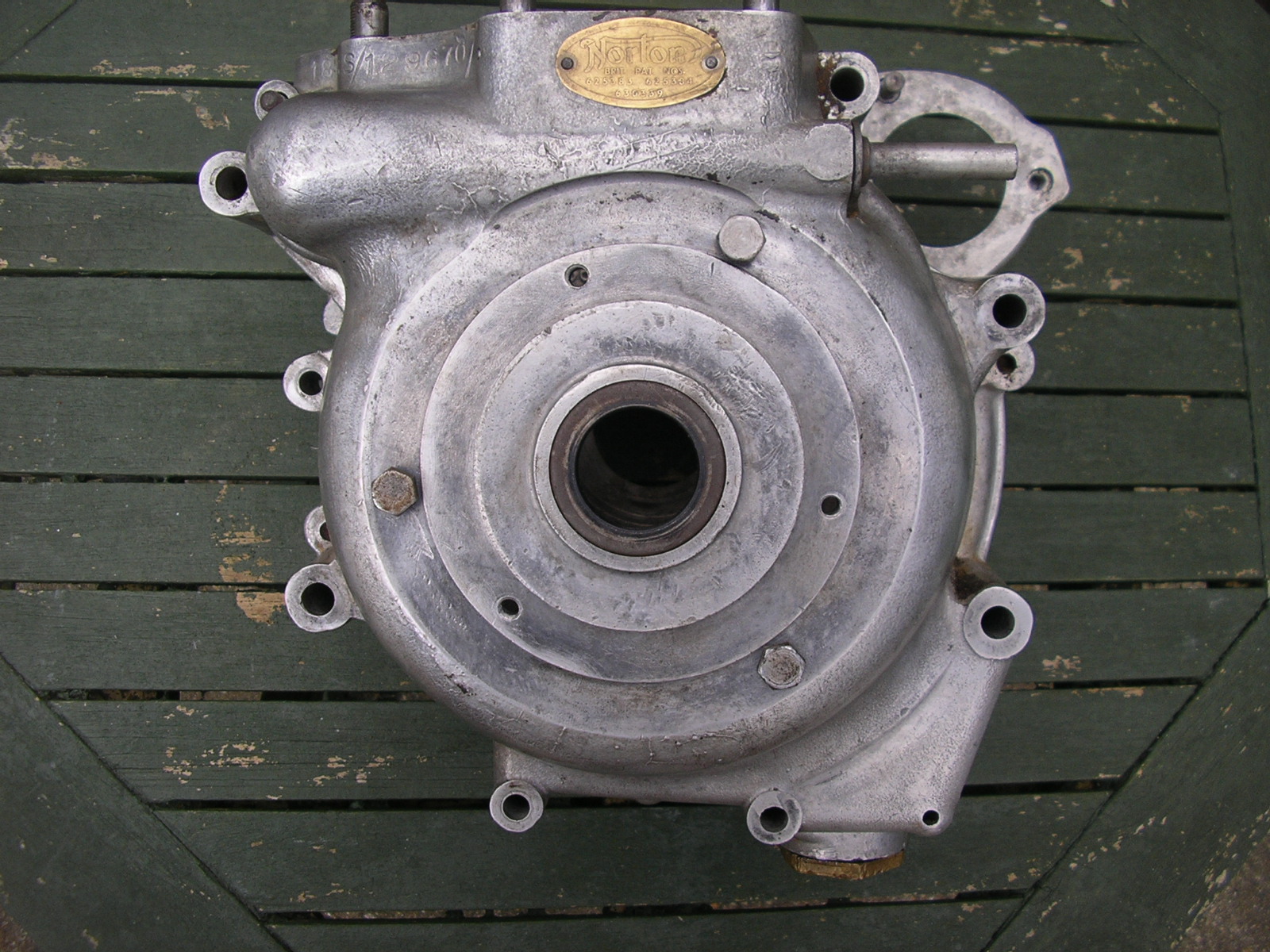

Attachment shows oil seal in its crankcase housing after all the primary parts and crankshaft have been removed.  You do not need to go to this extreme. Just remove the chunks as as described by Robert above. I use a thin screwdriver to pierce and lever the seal out. Be careful when doing this so that no damage is done to the alloy lip behind the seal. Use just the tip (1/8") of the screwdriver.
Use plenty of grease when sliding the new seal over the crankshaft to avoid nicks or tears. Some people add threadlock goo to the seal to help hold it in position. This should not be necessary with a good make of seal on the likes of a 500cc or 600cc motor.
