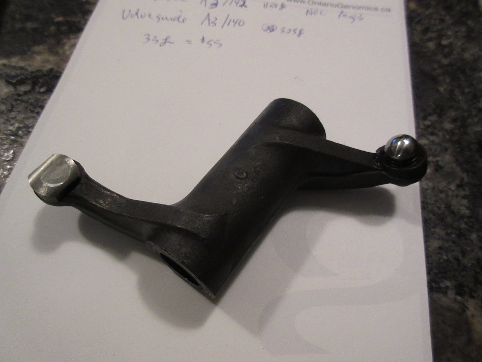

My 1951 ES2 is currently in pieces as I sort our various "issues"
My mechanic friend has advised me that I need new valves and valve seats on the exhaust side and fortunately the NOC has stock
He also pointed out that the intake side Rocker has extremely worn pads where it contacts the push rod and valve
apparently it has been improperly adjusted at some time in the past 66 years...surprise-surprise eh
the Rocker arm ball end fitting is worn to a bit of a point
The pad at the valve end is deeply indented...probably well below the case-hardened surface so simply dressing out the damage seems like a short term solution. Replacement of the part is ideal
I can find the rocker arms on line but these don't have the pads and are not in need of replacement.
the 1950 Norton parts list shows Rocker arm ball end, part number C3/104 and the Rocker arm Pad part number C3/105
Does anybody know of a source: new or used of these parts ?
Does anybody have a rocker arm with acceptable pad and ball that I could buy to scavenge the parts?
Alternatively do I need to find somebody who can build up the metal then do the appropriate hardening process?
any advice would be greatly appreciated

Further progress: Spoke with Mike P by email and he was very informative: just grind and resurface the pads and he made suggestions about appropriate valves and guides from RGM Norton so I am much relieved.
thanks for the input.
Grant

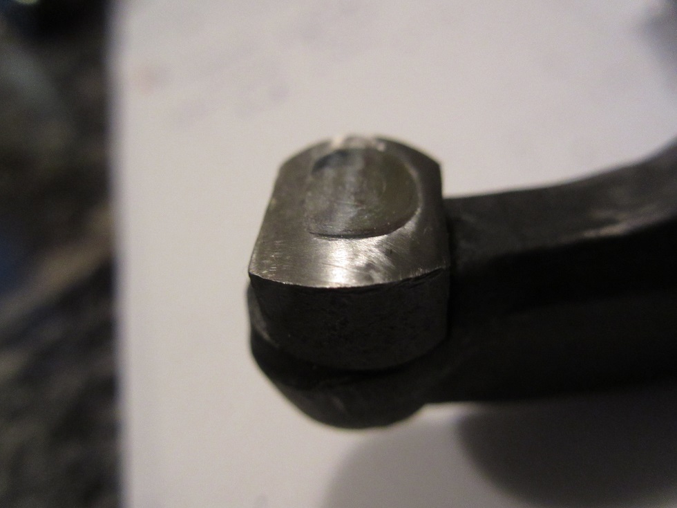

RE: my worn rocker arm pad…
RE: my worn rocker arm pads ( wear from valve stem contact)
Problem Solved ( at least one of them is )
Valve Train Industries here in Ontario did a lovely job of resurfacing my rockers. $32 for both which seems a bargain to me.
See the photos attached of the lovely workmanship.
Grant MacNeill, Toronto
Note: Mike Pemberton tells me that my deeply pocketed valves changed the contact angle at the valve stem-to-rocker arm contact angle which speeds the wear. He is a very helpful and informative guy.
