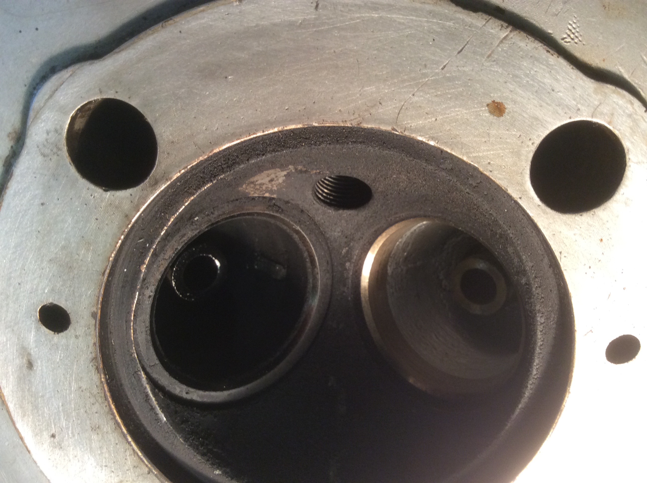

The piston top, the cyl head and valves all have what appears to be baked on oil. Removing the exhaust valve showed the outlet tract in the same state with the end of the guide still oil wet.
one of the threads described a worn guide as the compression failure and this does seem to be the case as the valve head or valve end can rock the stem from side to side in the guide So it seems that this is the problem.

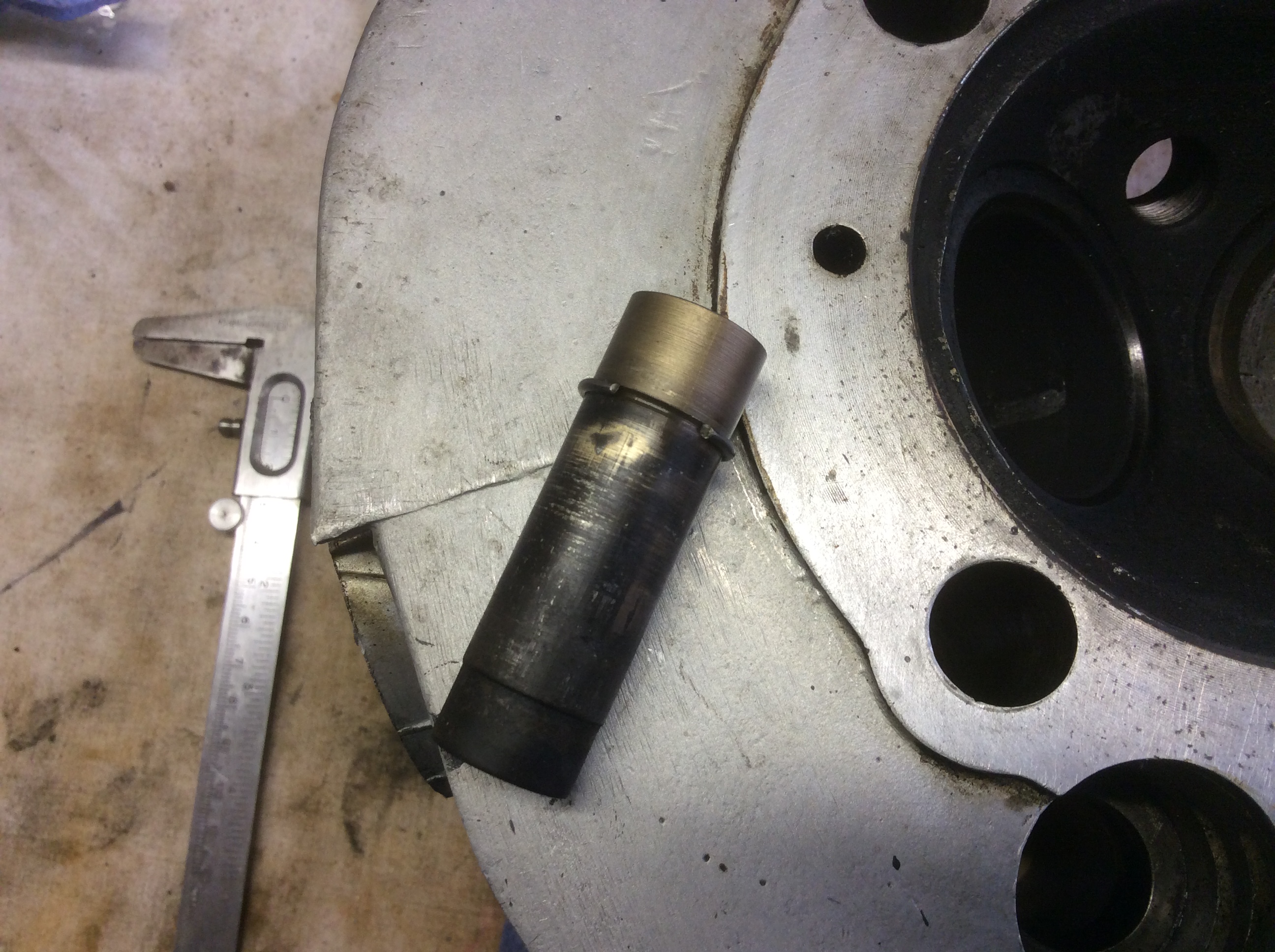

1. Both guides are bronze. What are the pros and cons between bronze and cast iron ???
2. The guides are held in place with a circlip. RGM illustrate this type as 1959 onwards but it’s cast iron. Is this circlip guide the only one suitable or could the guides with the ridge be used ??
The guide is correct size..5/8” OD and 3/8” ID, again as per RGM spec.
3, can the guides be mixed? Eg. Bronze with cast or do both the exhaust and inlet have to changed as a matched pair.
4. Both of the guides do not have the tapered end as those illustrated....including the RGM item. Am I correct in thinking the taper would provide improved gas flow.
5. Having heated the cyl head to aid removal of the guide I then found the valve a good tight fit in the still warm guide. Is this how the assembled bronze guide is supposed to function??

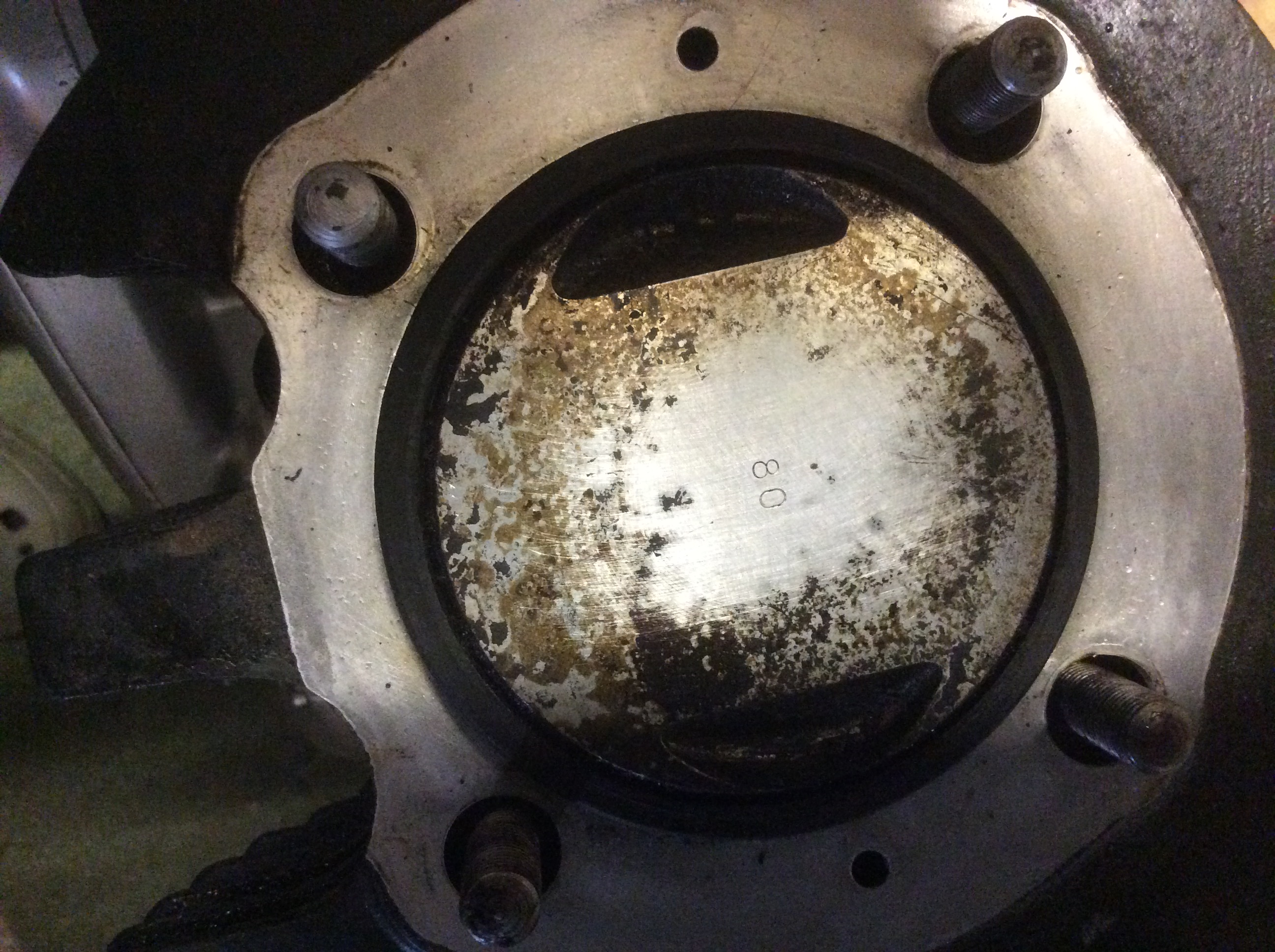

And finally as a slight change to the thread....I cleaned the piston top to check if it was oversize and did not find what was expected. The piston is marked 80.....does this mean it’s now 80x100 as opposed to the 79x100. Just seems so odd.

If the bore is now 80mm,…
If the bore is now 80mm, that is the same (almost) 40 thou overbore. That seems more likely than 80thou over. And it has no '+' sign.

As you suggest will consider piston to be at +40. Also accept the idea of iron guide as have no intention of racing so bronze not required. Might change both guides whilst it’s apart though.

The shape of the removed…
The shape of the removed guide is wrong, the flat top of the guide will pool oil on the top of the guide and then will be drawn down the guide and burnt, The tapered shape of the original guide prevents a lot of this 'pooling' and can be improved further by machining the top of the guide so their is just a small flat to the top of the guide, say 1.5 mm. Those bronze guides were probably made by an amateur who didn't know how to taper turn. There are a lot of grades of bronze and almost all of them are not suitable for making valve guides out of. Cast iron is the original material they were made from, it is self lubricating and hard wearing and is my material of choice to make replacement guides from. Your head obviously has had replacement guides fitted in the past which has probably ruined the 'fit' of the guides in the head leading to oil burning/loss of compression. It (the head) will need the hole in reaming true and a new custom sized guide making to fit said hole.

Having a load of invoices for bits is one thing, how they were fitted is another. The last three singles heads i,ve worked on for people had loose/badly fitted bronze guides, in two of them one of the guides fell out upon valve removal!

interestingly I have found a cast iron valve guide, suitable for ‘59 onward singles in the NOC shop, item20050, it is exactly the same design as the bronze guide I have removed. Seems at odds to comments about valve tapers!.

Re reading your first post, In 5. i suspect you have burred over the end of the guide when you removed it, so giving the impression that the valve is now a tight fit in the guide. Exactly how did you remove the guide? Punched out after heating the head using a hammer? If so what punch did you use?

Looking at your head, the inlet port looks quite clean. My guess would be the piston rings causing the excessive oil. The piston looks to be a modern replacement with it being marked 80mm and it might be possible the rings could be incompatible with the piston.

Peter, I don’t have whatever fancy pillar drill setup you have for drilling out guides. So, yes the guide was carefully tapped out, a hot cyl head and gentle tapping using the drift supplied as part of the valve guide tool kit supplied by NOC shop. The possibility of any burring was likewise taken care of with a fine needle file of suitable profile.

Hi John. I am still of the opinion that the guide was not sealing in the head ,your photo shows some shiny area where the guide could have been revolving when hot , this would give a smoky engine but not a very oily combustion chamber as the oil gets blown out by the exhaust ,your carbon on the piston is not unusual. The exhaust seat looks like it has had some blowby perhaps the revolving guide is not truly concentric and has caused it to leak and lost compression.The photo also seems to show oil on the guide when in the head ,usual with a leaky guide hole.I think a new well fitted guide will put you right.

I would say the carbon coating is not especially unusual so i dont think you have a real problem with piston or inlet valve, I think its most likely that you have oil leaking through the joint between ex guide and head ,you could try sealing this with silicone .I also think that you could be troubled with compression issues caused by insufficient clearance between ex valve and guide . Usually this shows itself when under load going up hills etc with a sudden power loss. Sounds familiar? I also suspect the guide is a little loose in the head so replacement a couple of thou bigger might be the best.
