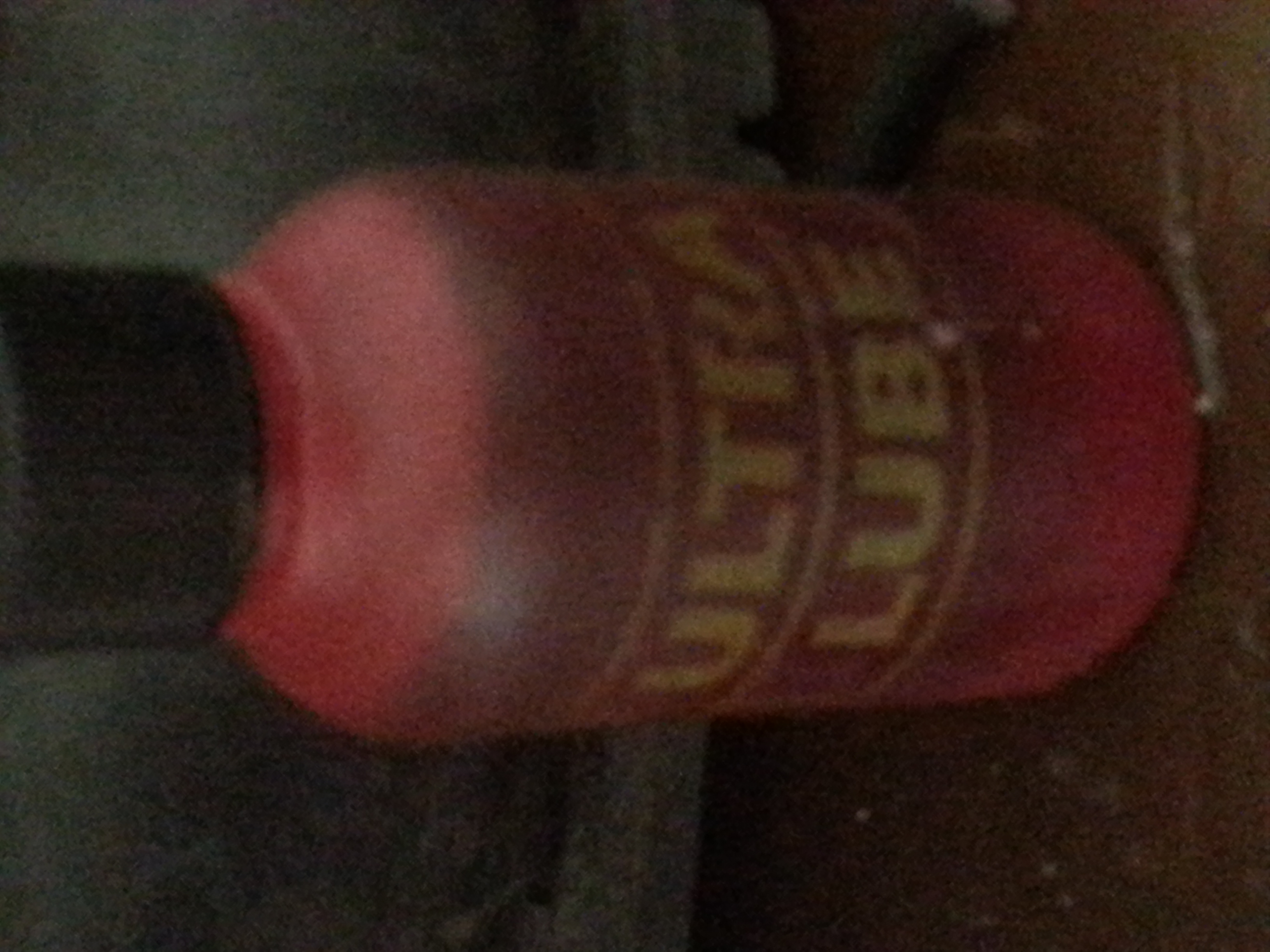

For Engine Builders Red Goopy Lubricant Ultra Lube P100
Lubrication for camshafts and followers, after an engine rebuild, liberally smear this  Ultra Lube P100 on the parts you want to protect, so in the seconds before oil flows through at a higher pressure, the parts are lubricated against damage and  undue wear!
Especially good for Dry sump engines! Recommended by an Old guy in Kent , who built many engines up for both cars and motorcycles.
Anybody else come across it?
