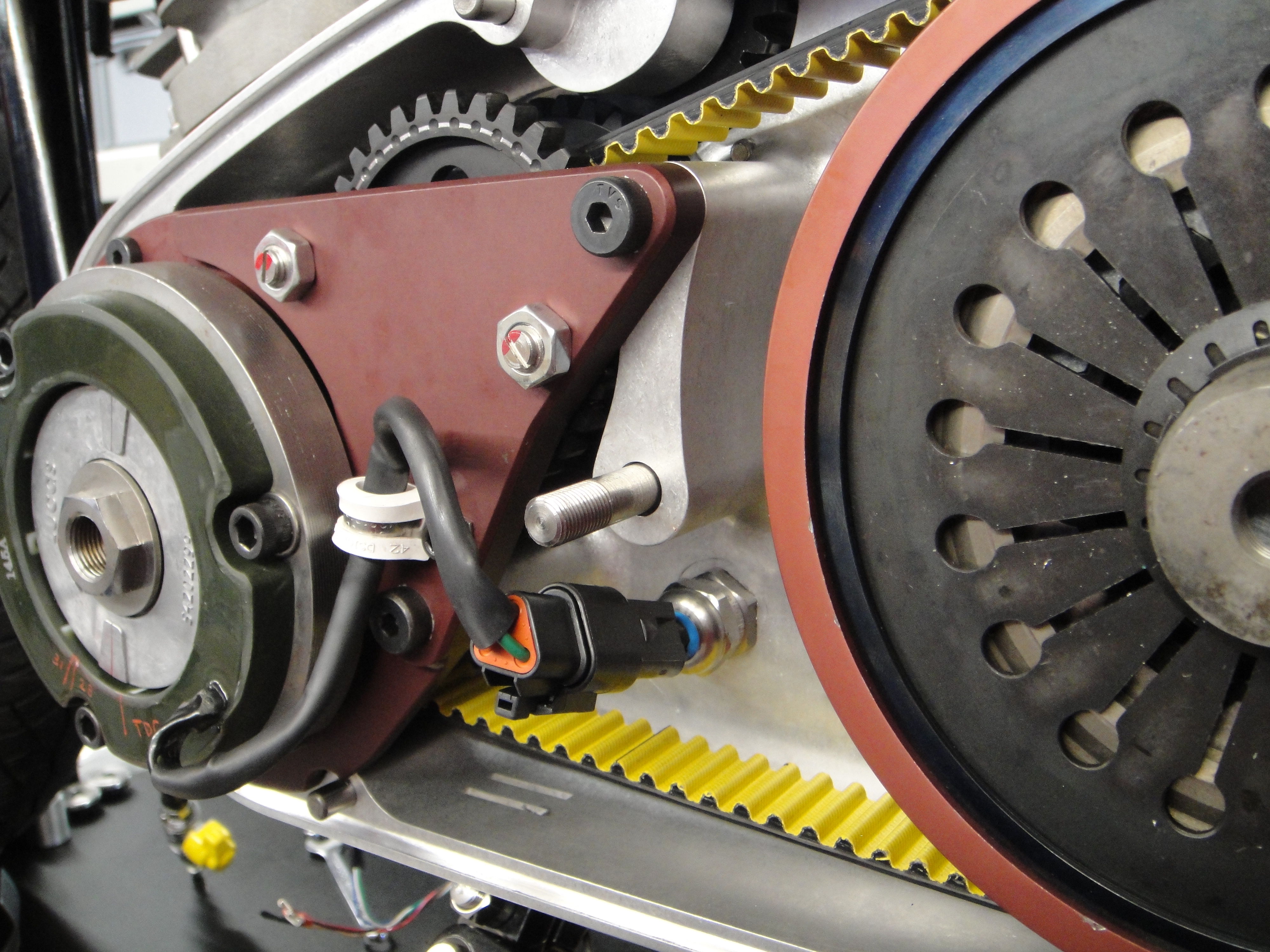

  • + comes with a primary belt drive
  • - you cannot use the standard air filter (cNw were looking at a building a cut down ham can which maintains a classic appearance)
  • + it uses the standard alternator stator (which opens up your options for charging)
  • + wound field motor means positive or negative earth compatibility
  • + off the shelf (Harley style) motor with solenoid engagement

I bucked the pattern, and got the cNw kit, and am really happy with the quality of the kit - I like Matt’s stuff. It’s a project bike, and I don’t have the air filter to consider, plus I was in the market for a belt drive too.

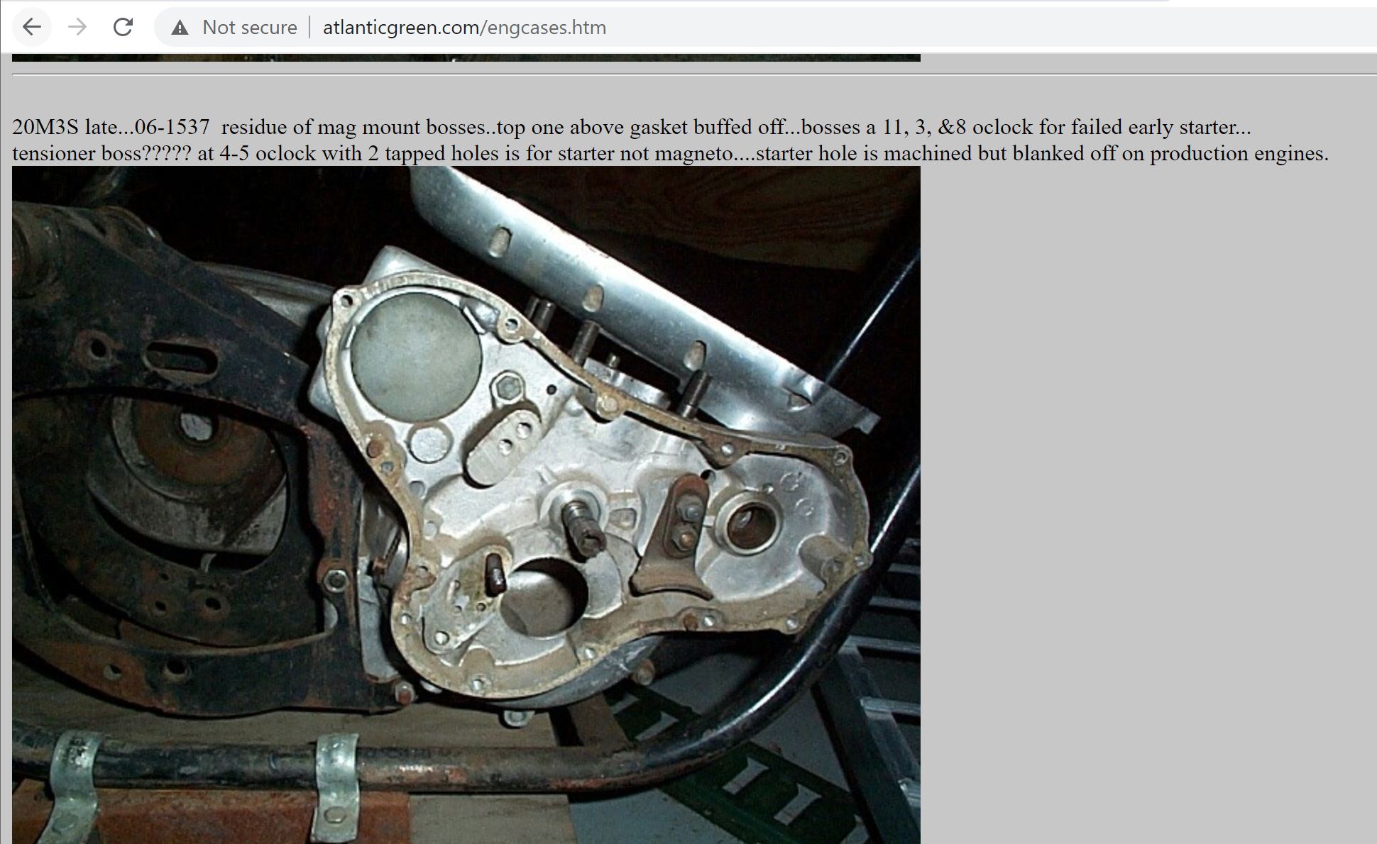

Mine is driveside, Norton tried the timing side but something was breaking so they dropped the idea in 72 and started from scratch again to give the MK3 design. Triumph tried timing side too and chased breaking components by adding strength to each broken part until the crankcases broke themselves and went no further.
