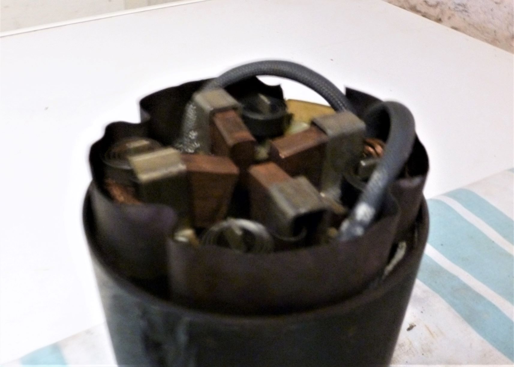

I’ve cleaned up the starter motor on my Electra, so it now spins. But I am missing the Fibre Insulating Liner that should be inside the commutator end cover. Can someone please tell me what material I should use?

Here are some photos, very poor I am afraid, which are of the Electra starter motor and as Joe Lucas sent out (I believe)
Bear in mind that this insulation could be critical. Should one of the brush wires touch earth you have the full power of your battery through the starter cables!!
