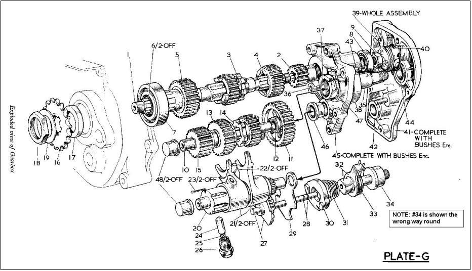

Electra/later gearbox rebuild
If, when removing the inner cover, all the gears fall out - don't despair.
It all fits only one way round - except (I think) for two items:
1) Item 15, Layshaft 4th gear. As Peter states above, its important to fit it the way shown - gear teeth against the back wall.
2) Item 29, Actuating plate. It is stamped 'OUT' on one face, you place it with the word 'OUT' facing you.
Note - Item 34, Distance piece. It is shown the wrong way round in the factory drawing.
