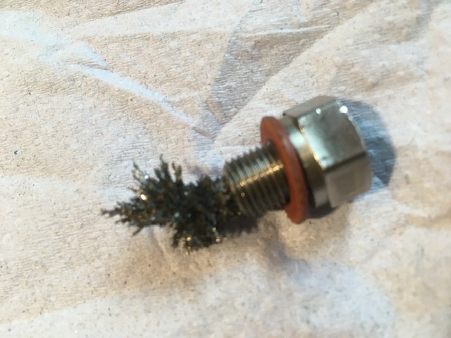

In the prep, put a pipe cleaner up the return and overflow. Use a magnetic drain plug also..

Hi Neil. Yes, I do use a…
Hi Neil. Yes, I do use a magnetic drain plug- this is what it looked liked:
That was after my engine problem. I had already cleaned it twice so the photo shows it in its ’best’ condition. Unfortunately the amount of steel debris overwhelmed even the powerful magnet in the drain plug so a lot of it ended up sticking to the inside of the oil tank. And of course, the magnet can’t help with the aluminium dust - that just mixes with the oil to produce a nice silver paste.
However, the oil tank is now spotless inside, so I guess that’s progress.
