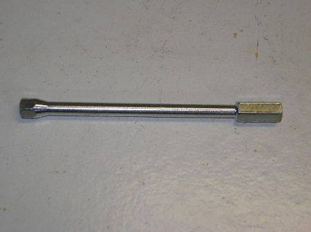

William,
From your last comment - "Magneto next but the bottom nut on said item looks a nightmare to get at "
Once you have got it off, a common modification here is to replace it with the long nut from BSA A7/ A10 bikes and never have to struggle again.
'Nut' looks something like this:
RGM sell them, as well as most BSA and old Triumph dealers too.
