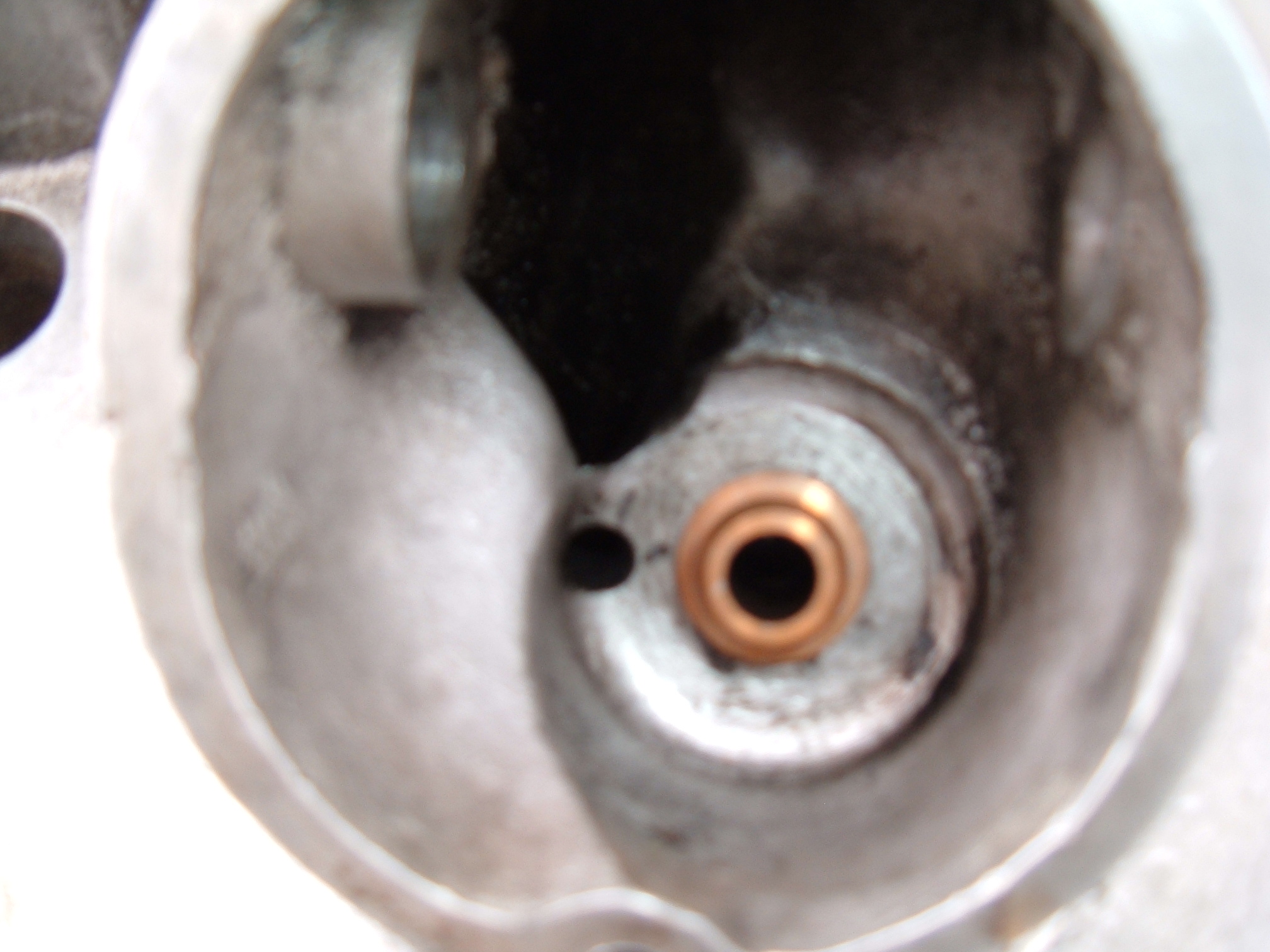

Hello Robert Well this is the first sign of poor oil feed to your cylinder head rocker feed the right option you now have is to remove the cylinderand replace it with another or have the all the spindleholes milled out to have an interference fit for bronze bushing, with oil hole in it and then fit with new thackerywashers and get the oil ways blown through including the drain hole on the inlet side next to the valve springs has shown on my photo below I do hope this fixes your problem have a nice time we wish you well so good luck yours anna j
