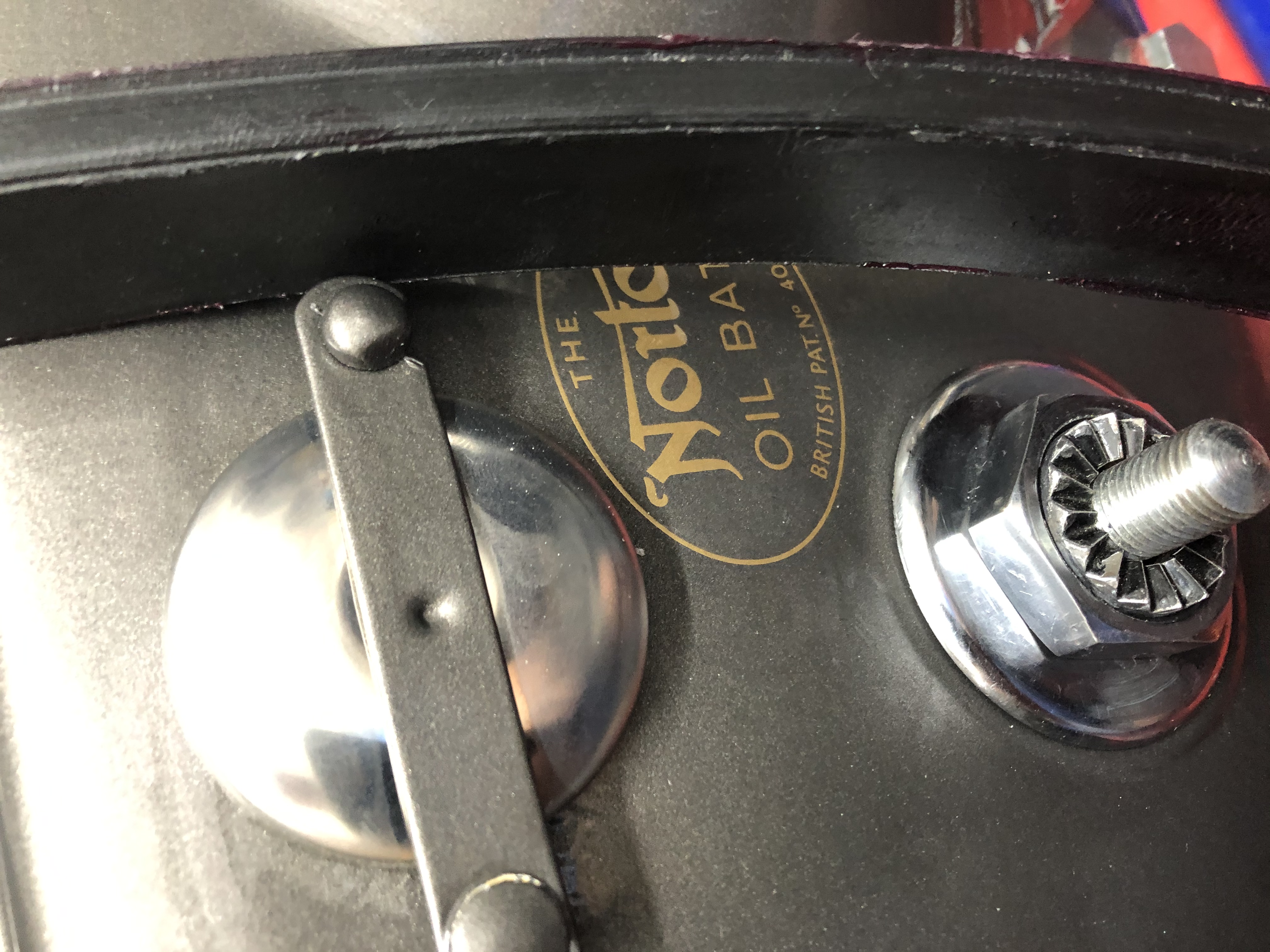

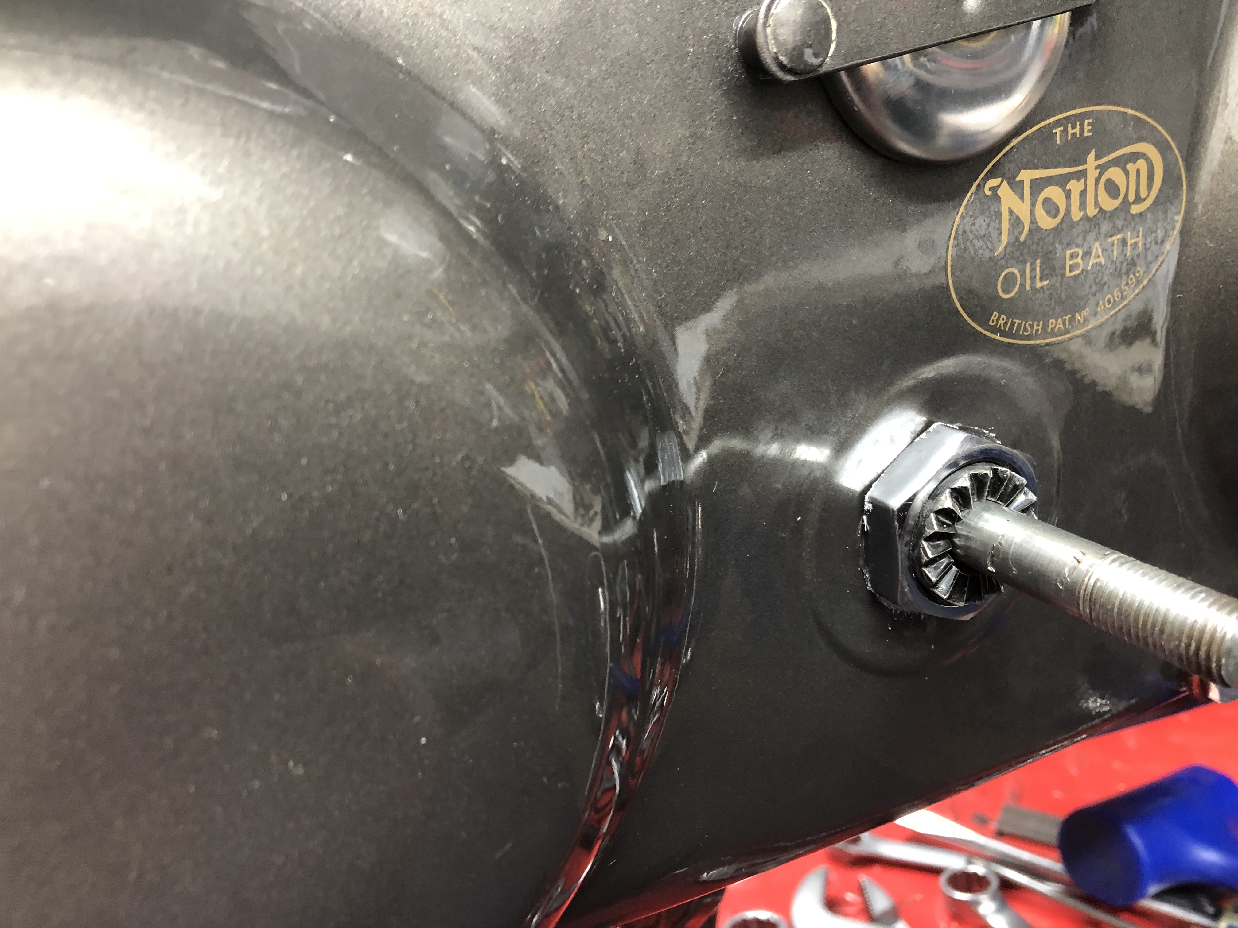

I believe I have built the engine/plates etc correctly. The rear chaincase fitted a dream. The alternator and clutch and chain - no probs. But... the primary chaincase cover - with rubber seal lightly lubed with red silicon grease will not go on far enough to allowing me to get the rubber seal/finisher washer and chrome nut onto it’s thread.
I’ve tried without the rubber washer and finisher and I can get the nut on - just. Very fearful of warping the cover.What am I doing wrong? Photos attached.

Looking at your photograph I think you are only around one thread away from the outer being about right.

My pic showing the centre nut on is without the rubber oil seal and chrome washer! With those added I am a looong way off getting the centre nut to catch a thread!
in fact, if I remove the rubber band completely and fitted the outer casing the rubber oil seal, chrome washer and centre nut and they all fall into place with a couple of threads showing as proscribed.
Its as though the rubber band is not required at all!!

This chain-case was notorious for being bent in by the chrome nut being put on then the foot rest hanger tightened after, this bent the out case inward. IF then some one tried to take this inward bend OUT and in-fact went a bit too far!! Then the outer case would stand proud in the middle?

Just spoken to machine shop who straightened outer case for me - quite possible they pulled centre out - thus losing required threads on hangar tube.
They suggest fitting without rubber band so that can get nut on and slowly - one turn at a time tighten up - check with band fitted and repeat. Keeping an eye on bowing whole casing.
This fits Al’s theory and is something simple like Robert suggested.... and Pete Lowell’s “joke” turns out to be a fact!

I’m now about 1 thread of getting the nut on with its rubber washer and chrome finisher - with big sealing band.

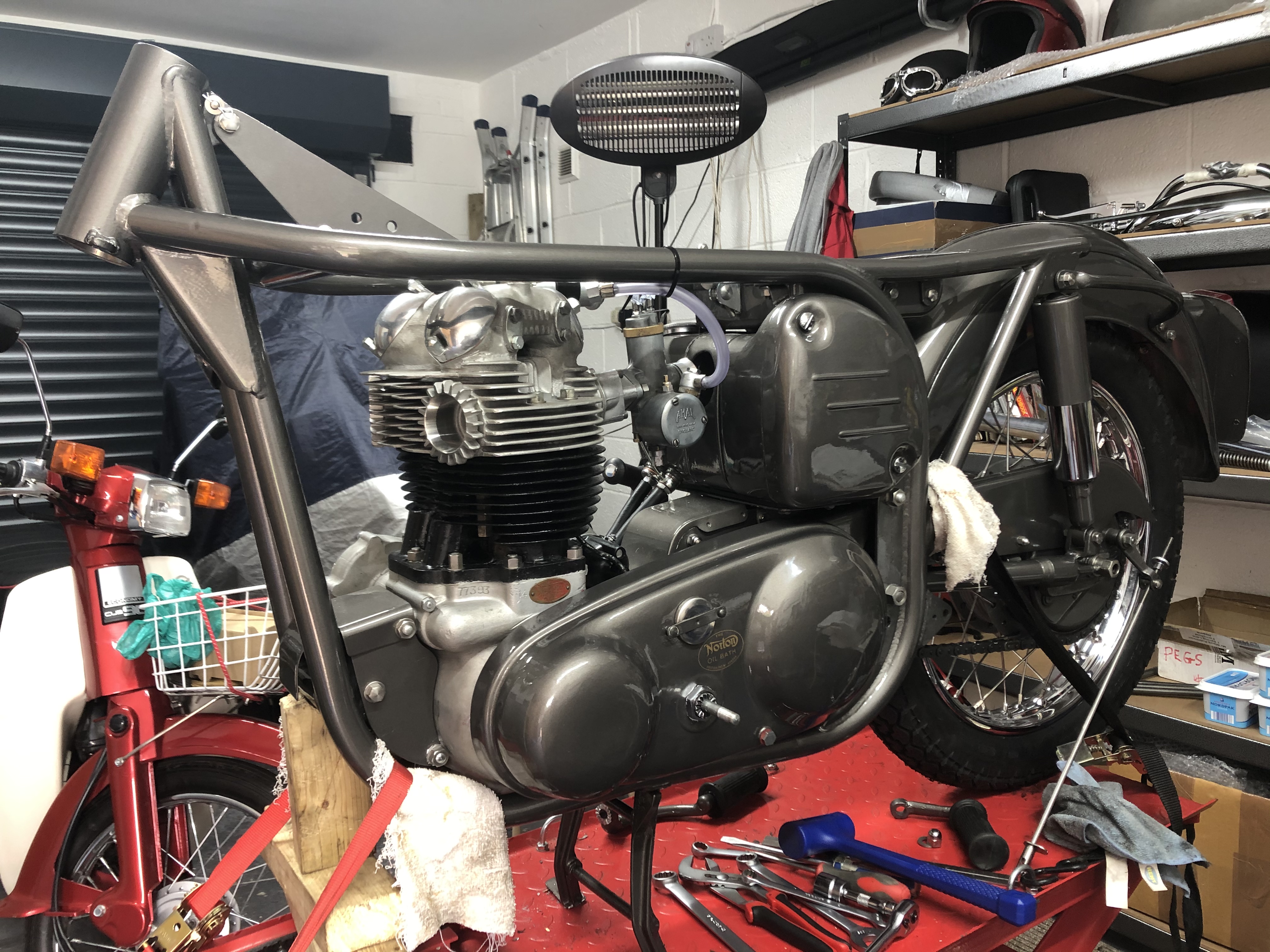

Thanks Al, gradual wind on/off of an old nut and suitable washer “reshaped” the outer chaincase until I could get the pukka rubber seal, chrome finisher and chrome nut in place. With no detectable distortion of the outer case. See pic. Get the forks on now!
