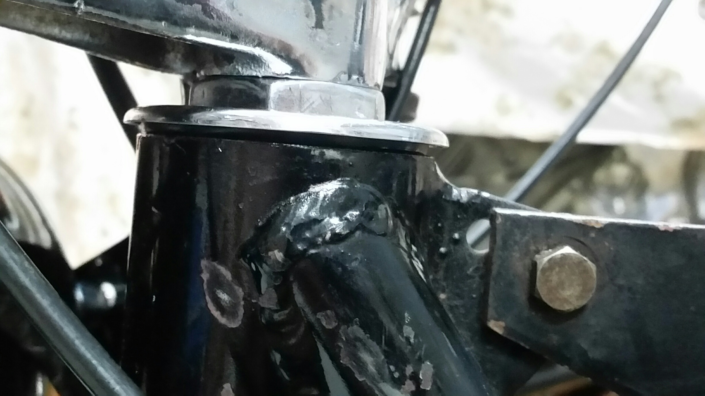

The tapered bearings stick up above the headstock slightly and there's no easy way to keep to weather out.  They are also very difficult to get into that sweet spot of zero play and zero tightness.  I found that after seemingly getting them just right, 200 miles on I would get front brake chatter when stopping rapidly from speed and I would then have to re-adjust the bearings again.

The only frame I've ever had with open bearings, like those of a bicycle headstock was my 650ss, not very nice and certainly no distance tube.                 In the frames of my 51, 56 and 57 f/beds the bearings were neither ball journal as such or taper roller.                   The head bearings on these frames had the appearance of a normal ball race from one side with the word thrust on the edge of the outer track.                  The reverse side was open while still retaining the fifteen balls, an angular surface ran down to the ball track.           The bearings were assembled into the frame open side out ,packed with grease followed by a heavy felt seal , again with no distance tube. With careful adjustment these bearings gave no trouble at all.  Special care was needed when removing these bearings as they would fly apart if you caught the centre track with the removal drift.

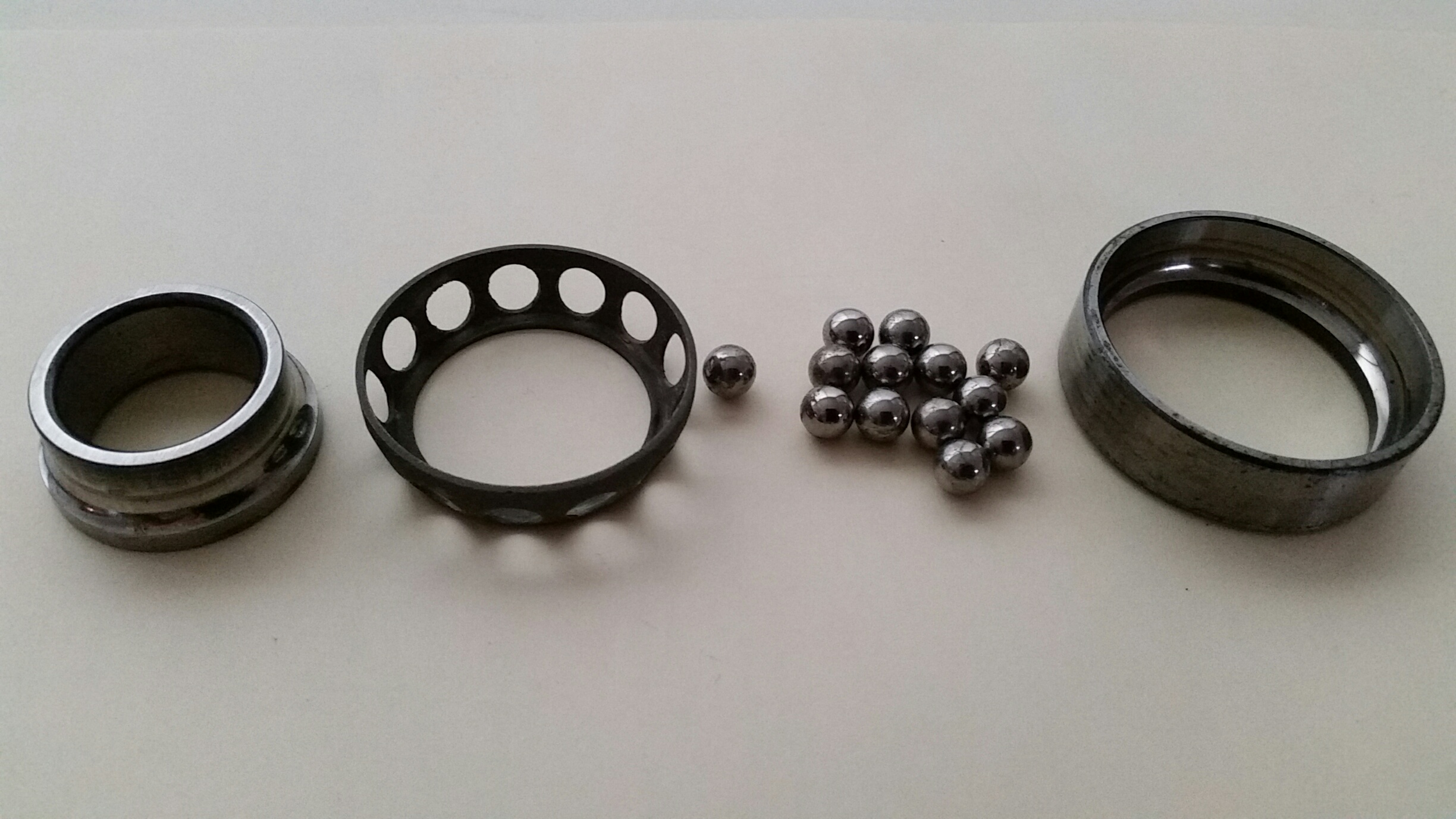

I read somewhere that Norton Bracebridge St fitted Angular contact bearings up till the early 1960's . Which would be those that I scrapped. Did not notice that. I use that type of bearing in Bevel Ducati's and they are expensive.  As said above the ball races need to be a snug fit to the stem otherwise there will be chatter that will not adjust out. Think I would measure the stem before buying the bearings.
The reason my taper rollers were too tight was because I didn't know exactly how to fit them in that situation. But the reason I interfered with them in the first place was that I replaced them because  they had 'brinelled' slightly. That is because the angle you turn the head on the road is so small that they wear in the dead ahead direction. I believe this is more if an issue with taper rollers but don't have enough experience of trials.
After sleeping on this ,I have concluded that if Norton thought that this application really needed the more expensive angular contacts ,who am I to think I know better?.As these bearings were superceeded by cheaper cup and cone by AMC ,I will stick with tapers which are designed for both Radial and Axial loading . Those in my 99 have survived 30 years and are still perfect(despite having no seals) The sealed  ball races in the SV 650 failed after a much shorter life . The reference to Angular bearings came from Roy Bacons very usefull Norton Restoration Book.

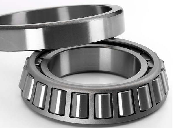

.SKF says: “Tapered roller bearings have tapered inner and outer ring raceways and tapered rollers. They are designed to accommodate combined loads, i.e. simultaneously acting radial and axial loads. The projection lines of the raceways meet at a common point on the bearing axis to provide true rolling and low friction. The axial load carrying capacity of tapered roller bearings increases with increasing contact angle α.”

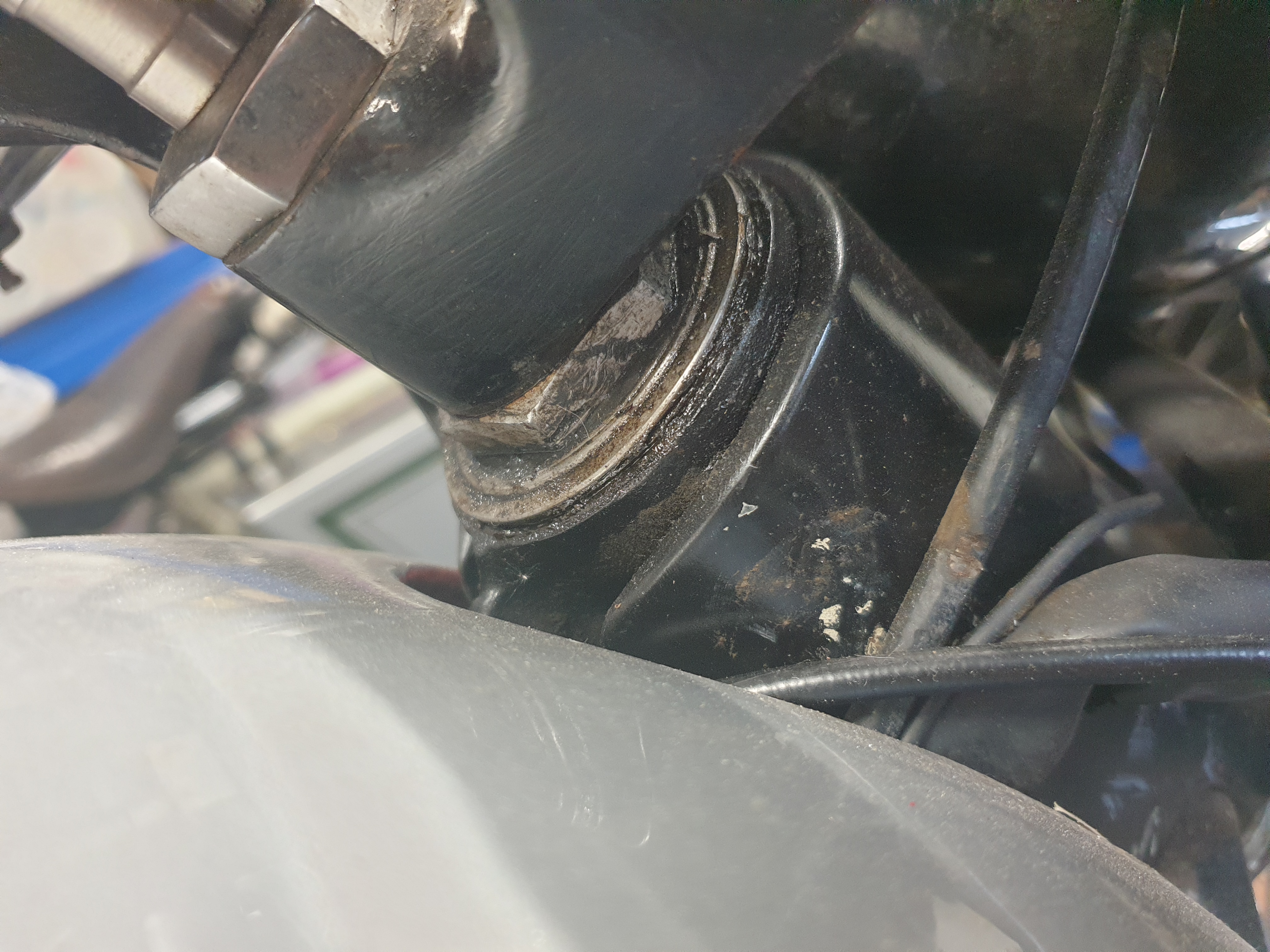

I have been following this topic with interest as I am in the process of fitting taper roller bearings to my Mercury. I expected to find the original cup and cone when dismantling but found instead an SKF roller bearing, 7205B, see attached photo. It has been there a long time as the grease has completely dried and looks like something you would find at the bottom of a chip fryer. Anyone else come across these,
Cheers,  Terry Blenheim
That has the look of an angular contact bearing.    After checking ,it is.   I wonder if it was fitted from new. 2 of those fitted in opposition  would seem ideal apart from not being suitable for seals.

Hi Terry Blenheim, in your post of the 20th/May you say you were suprised to find an angular contact race in your headstock. Your photo clearly shows it to be a ball thrust race as fitted to my 51 Featherbed and exactly as I described in my post of the 15th, oddly enough Robert Tuck has confirmed the photo as being of an angular contact , am I seeing a different photo?
Hello Ian,  my original post didn't identify the bearing as an angular contact type as at the time I didn't realise that is what it was. Subsequent posts have filled in more details about the various types of bearings used by Norton and it seems likely that the SKF bearing on my Mercury is an original fitting. I have fitted taper rollers and am struggling a bit with how to effectively seal them.
Regards, Terry
ps only one photo posted.
If you enter 7205B into a bearing  cat you will find it described..I have used Angular contacts in Ducati Bevel drive MotorsI have also read that Norton Bracebridge St fitted angular contacts ,but without further research I can't say with certainty these were or were not fitted..But they certainly would be more suitable for the load directions.The Information came Via John Hudson who for some years was  a service engineer and  Service Manager.  A roller thrust race bearing is used in my 99 clutch lifting gear. Helping to reduce drag.
Robert, the photo I'm speaking of was described as an angular contact bearing. It wasn't , it was a ball thrust bearing as I described in an earlier post as being fitted to my 51, 55 and 56 F/beds.                                                            I really can't understand what all the fuss is about fitting head stock bearings.          Members are asking " how far should my bearings protrude from the headstock"      The head stock has a bearing housing at either end, any outer track fitted into either housing must bottom out, whatever sticks out sticks out.                   Assemble the bottom and top bearings ,yokes and felt seals if necessary,  adjust bearings till satisfied, job done, what could be more simple.                        Distance/spacer tubes,  never yet seen one on an 88 or 99 or my 650 ss

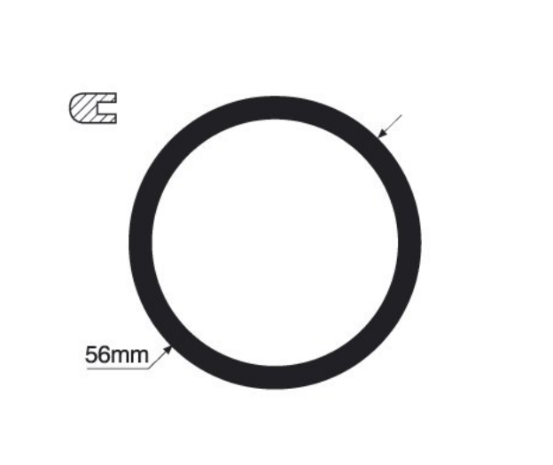

Hi Ian,  Following from previous post I have found what looks like a suitable sealing gasket. It is a rubber seal originally for a car thermostat (Toyota Camry 4 Cyl). Sold in Australia under Tridon brand, part no. TTG34. It compresses nicely over the outer race and fills the gap as you will see from attached photos. The gaskets retails here for about A$8 each.

My experience of fitting taper rollers is that they need some extra packing to allow the correct fit of headlamp brackets etc. effective seals may stiffen the steering and make it unresponsive.
Mine has this cover. I assumed when I first had the bike that it was standard, but then found taper rollers. I changed them after MOT advisory about slightly notchy steering. I now assume this was previous owner addition.
I am still pondering the differeces between my Nortons, The Atlas is going to get some Tapers and  a balance check. May have to do the Syd Lawton trick with the wheels offset to counteract the heavy Alternator and clutch.Also like to find out why the 99 has such quick steering,possible a shortened wheelbase
Hi Robert,  I take your point about possible stiffer steering with the seals in place. I am hoping that the application of light grease onto the seal surfaces will prevent this. I hope to give the bike a run in the next week or so.
