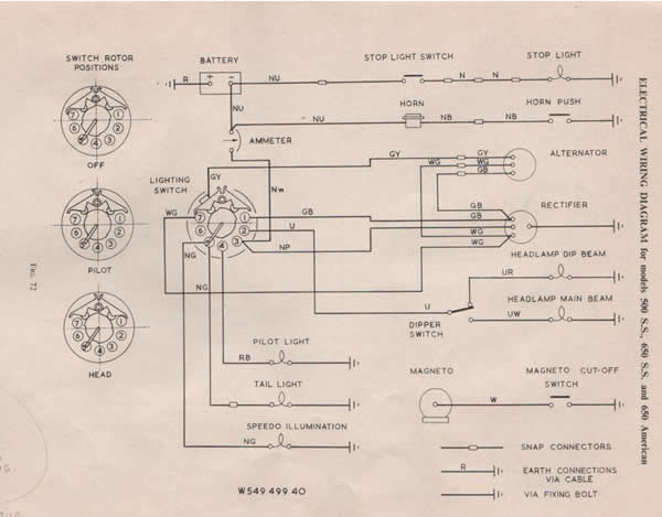

Fitting a Podtronic on a 650SS. All the instructions says it's simple!
My alternator has three wires. Currently the green/yellow goes to the the bullet connector at the top of the sprung caliper thing on the switch. Instructions say that this wire now connects to one of the yellows on the Podtronic. Can I/Do I now forget that particular connection to the switch? I believe that it switches in another coil on the alternator so I probably can???
I understand that the black wire from the Podtronic (+ve earth bike) will connect with the old Brown/purple off the rectifier which goes to switch connector position 3  which in turn goes to the battery via the ammeter. That one is fine.
However, one of the double green/browns off the old rectifier goes to switch connector position 1. Does this connection get scrapped as well as it is the other wire for originally switching in another alternator coil or do I need a double connector off the new podtronic yellow to run a replacement wire to switch connector 1?
Lastly, one of the double white/greens off the old rectifier goes to switch connector position 7. Again, does this connection get scrapped or do I need a double connector off the second of the new Podtronic's yellow wire to run a replacement wire to switch connector 7?  I can't work this one out?
Sadly none of this covered in the instructions. Any help gratefully received.
Wiring diag attached.

The RM 19 or earlier stator has three wires. To use 12V the GRN/BLK connects to the GRN/YLW the other wire is WHT/GRN, this makes the RM19 a two wire stator in line with the RM21. these two wires connect into the two YLW wires of the reg/rect. All other alternator wires to/from the PRS8 or 88SA are removed. The RED from the reg/rect goes to Earth and the BLK becomes the BRN/BLU which feeds the battery via the Ammeter.

What did the extra white/green wire from the old rectifier to position 7 on my switch do?  (see my wiring diagram)
Very good question, I am glad you are watching. The GREEN/WHITE is actually from the Alternator and goes to SW7 the other side of the rocker part of the switch goes to the GRN/YLW on the alternator SO when the switch is in the off position the WHT/GRN and the GRN/YLW are connected together. This shorting out of part of the alternator reduces the alternator output-no lights-ignition only.
Once you put side lights on this switch function becomes open circuit partially increasing the alternator charging. All part of 6V in the early days (late 50s). Later on, from the factory this function was dropped, I would have thought to increase the charge in Ignition only position.
Very few people have even seen this function let alone worry about it. This was one more function of the PRS8 and shows why we had 19 terminals!
