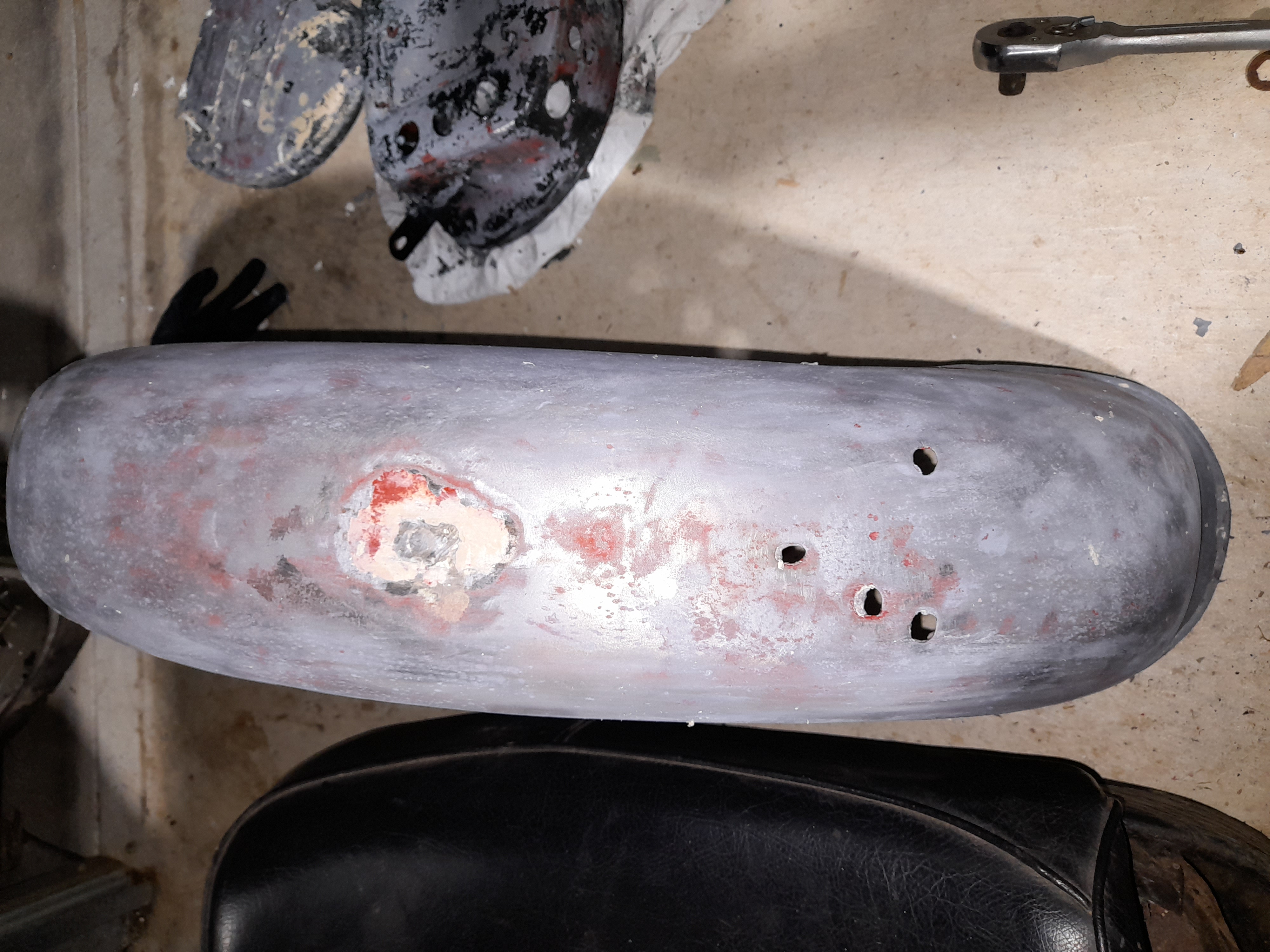

The 62 Model 88 Im restoring has a rear mudguard thats i think is beyond repair. Does the Atlas or other models have the same mudguard? A Dominator mudguard seems to me hens teeth!
I believe all slimline models have very similar rear guards (Deluxe excepted) with variations around the dzus bolt for the rear seat retainer.
You think yours is beyond repair- how bad is it? If its truly rotten, that is probably the case, but if there is enough sound metal, you should be able to get something done by a good tin-basher. If you are in the SE, I can recommend Drew Roberts at Heritage Motor Works (details in the Service tab on here). He repaired my Electra rear guard, and also did an amazing job on a SL petrol tank.
If your guard is painted rather than chrome, that can hide a few bits of grot!
Im in Western Australia and have a great shop working on the bikes bits.
Maybe im just underestimating the work of a good panel shop. Maybe i let them at it. Im worried because the dzues fastner hole has been welded up. The guard may have to be the very last piece to restore so they can line a new hole up where the seat sits.
So you're not local to SE then! From what I can see on the pics, the guard seems to be fairly solid, no gaping rust holes. I used to work in a car bodyshop years ago, we had an Aussie panel beater who was very good. He said panels for European cars were few and far between, seemed there was very much an attitude of if its broke it can be mended.
The only issue Drew had with my guard was where the bridges on the underside went, these had allowed rust holes to develop on the surface where water had got into the gap. Not terminal, just more work, so I abandonded the idea of re-chroming as I'm not going full resto on this one.
Your comment about leaving the Dzus hole until you have the seat on as an alignment aid makes perfect sense.
I had wideline mudguards neglected for 37 years, much of that outside so I had them blasted to get rid of the rust. This left the front one looking a touch like a colander!  The blasters etchant primed them too - the green type.  That preserves plain steel like nothing I've ever used before!  Both guards are still rust free after 11 years - no other primer or paint.  The front colander was actually still structurally quite sound so I glassed it on the inside with a woven glassfibre, which is much stronger than the tissue type.  The guard is nice and firm and just needs filler skimmed on the outside.  A good rub down, a coat or two of filler primer to get rid of the orange peel effect caused by rust pitting and a few topcoats and it will be as good as new!  I bought new pattern guards, which I will have chromed - one day!
