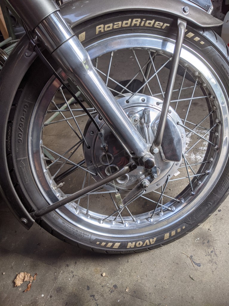

Nice front wheel picture by Bob, having the same tyre and the alloy wheel I now have something to aim for with my mudguard around the wheel/tyre. With help from Mick we might get there. Cheers both.
Hi Alan, just be aware that I have heard that several owners have not been able to fit the 90/90 tyre due to clearance issues on the mudguard stays.
I believe the standard rim on the Dommi is a WM2, whereas my rim is a WM1 - which gives a slightly narrower profile (1/4"?) to the tyre.  According to the Avon site, my rim is out of spec for this tyre but after several thousand miles, I can honestly say that the handling and steering has been faultless.
