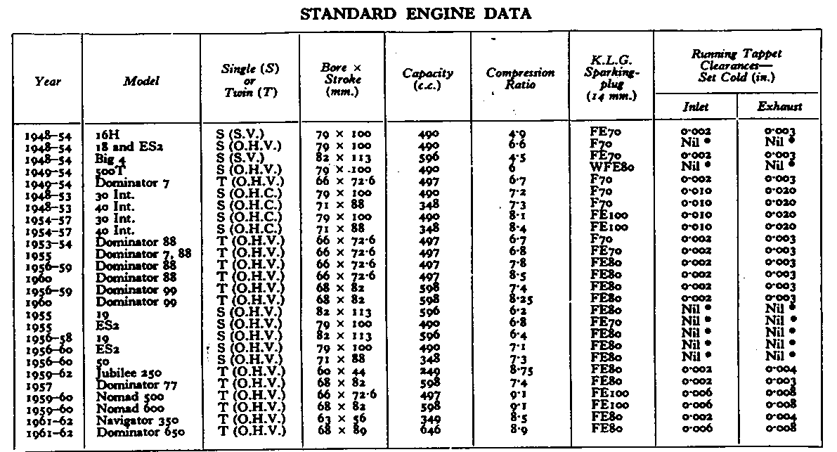

Hi George.......your question is almost impossible to answer when checking all the usual sources for information. As you have found out yourself there are numerous suggestions and some  contain errors as they do not appear to allow that for the fact that early Dominator engines had all-steel pushrods inside the barrels. Whereas by 1957 these had changed to pushrods with alloy shafts which need a greater clearance due to differences in expansion of the respective metals. Checkout the attached well respected Garratt Service manual page which contains such mistakes.
I would suggest 0.002" and 0.003"  (In/Ex) for the early engines with iron heads and all-steel pushrods. I note that BMS suggests 0.005" for the Ex.
But 0.003" & 0.005" for Alloy heads and Alloy pushrods.
