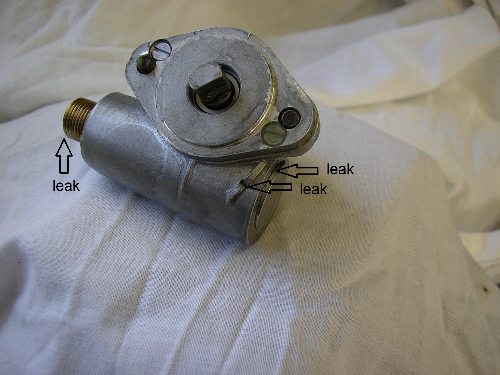

I spent over £550 with Gaggs buying the complete clocks, cables and drive box kit for my 650 twin. The speedo needed 4 repairs in its first year of use. The rev counter gearbox leaked oil from its cable end and worse still from the alloy plug in its gear end. This was held in place by a  solitary split pin which allowed it move and then half drain my oil tank.

I have found a photo of the Gaggs rev counter drive, This shows the dodgy points. You can even make out the wobby end bung held by the split pin. Gaggs were very good and repaired the speedo free each time but blamed the damage on the drive cable........which they had supplied!!!
