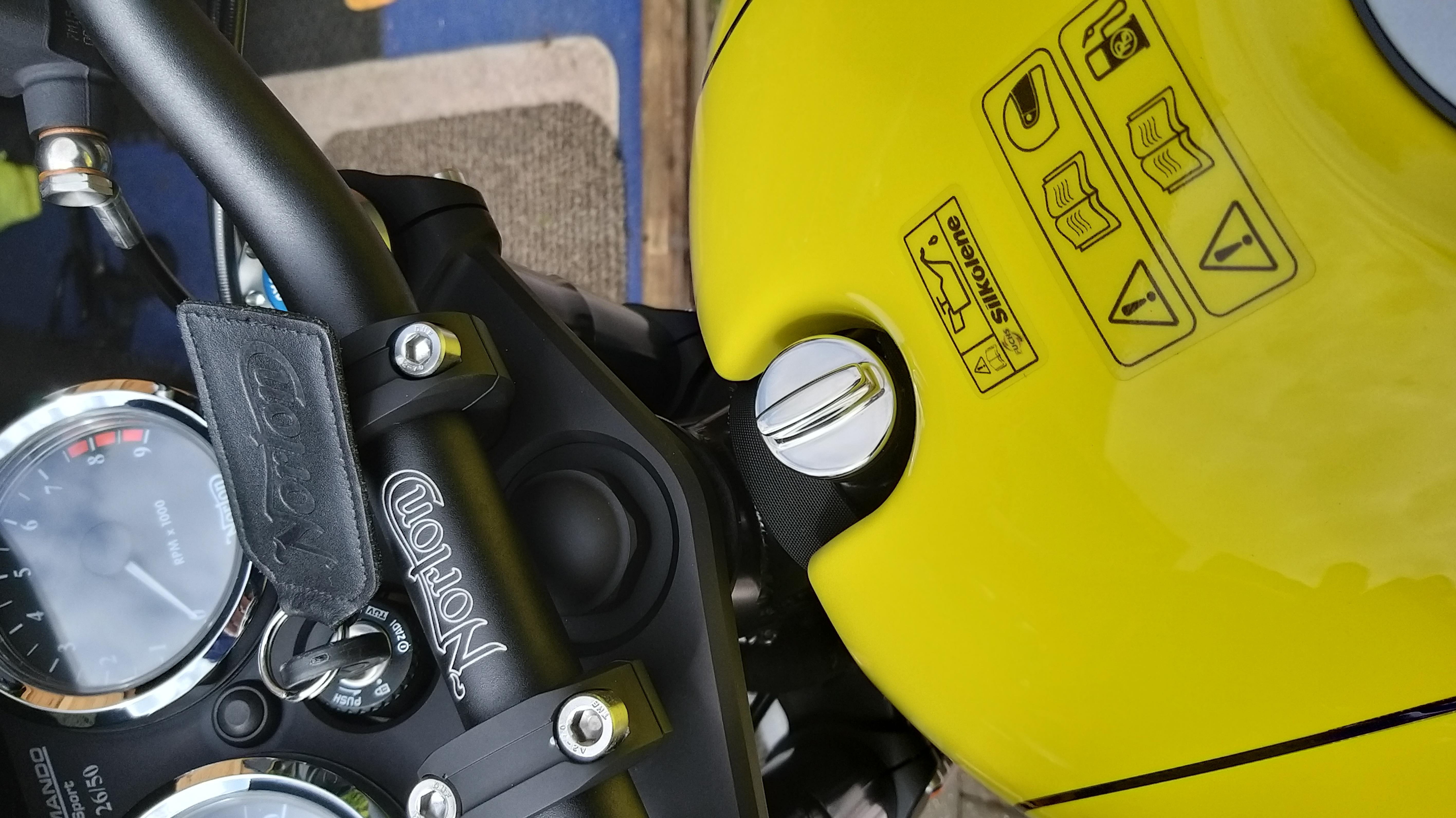

Hi All,
Can anybody help with the above?
The cap is absolutely solid and all I want to do is check the oil level.

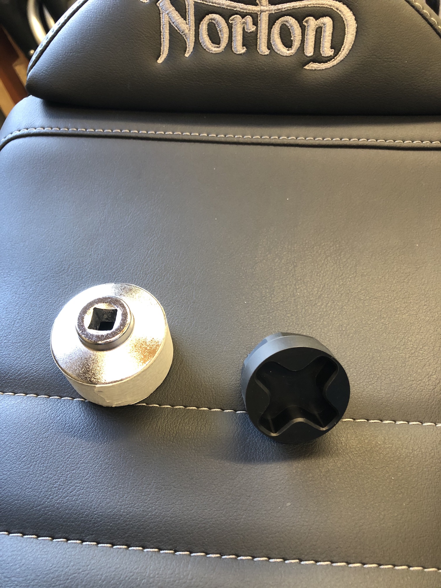

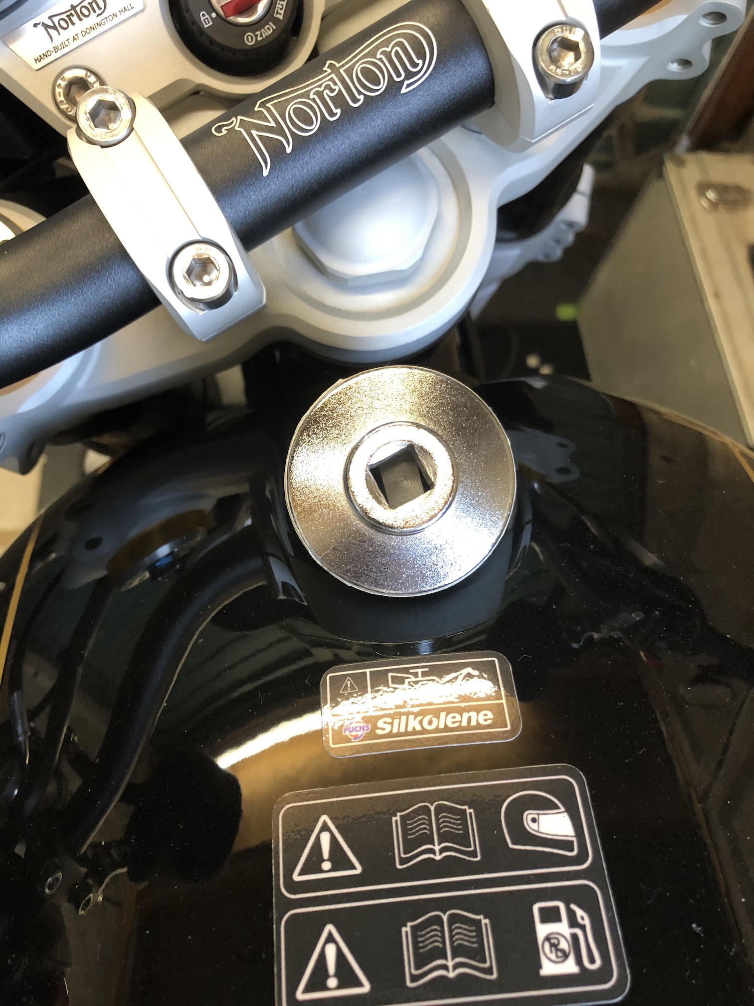

As promised Barry,
Pictures of my Theil Motorsport Oil Filler cap tool and socket. The Socket was a Sealey SX114 36mm Low Profile Oil Filter Socket and i had to bore it slightly deeper to go over the tool, if you bought a standard depth socket i guess it would fit without machining.

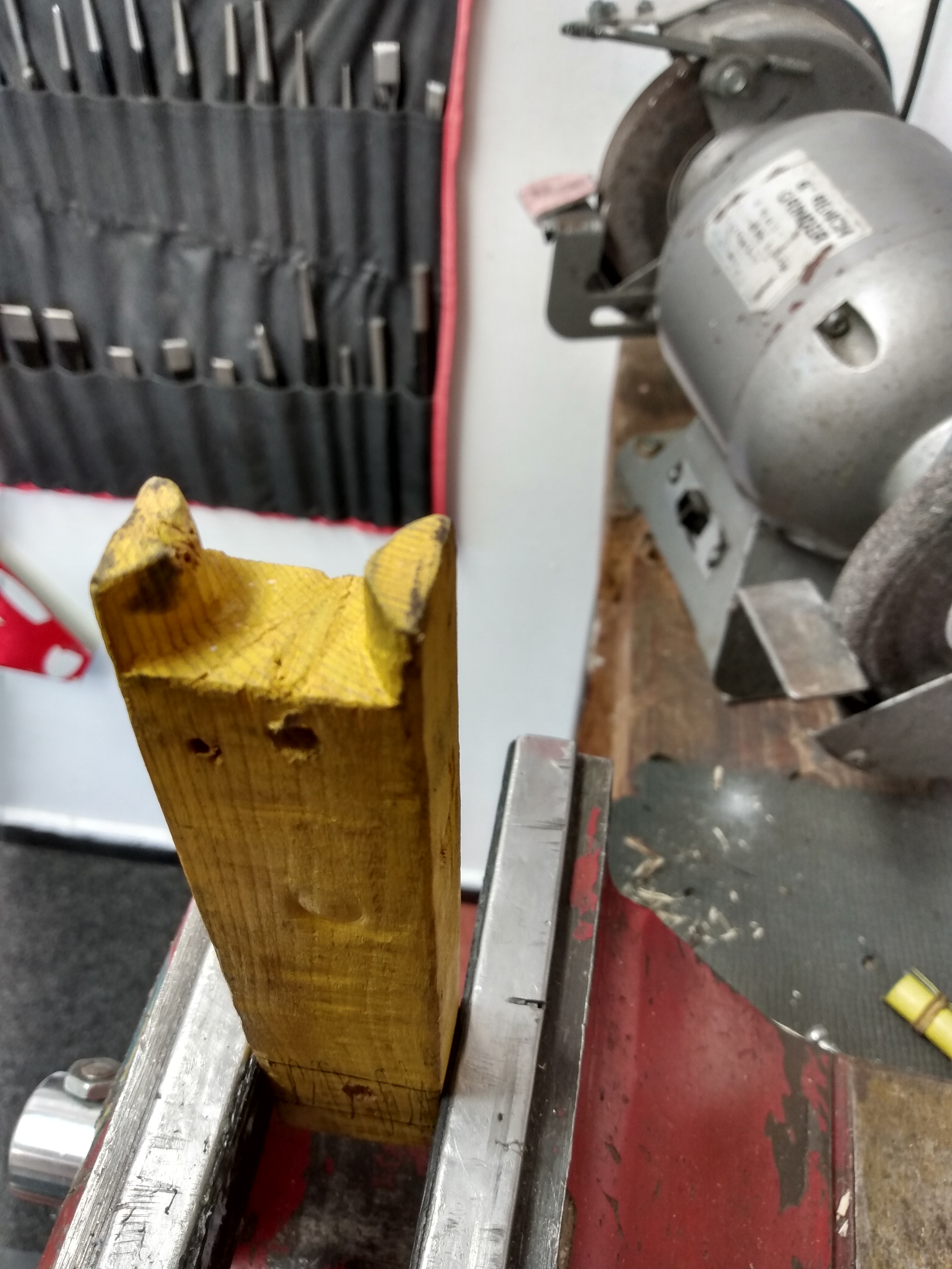

I had the same problem with my 2015 Sport, the problem is there is no torque setting in the manual so people assume they need to tighten it with a five foot extension bar to be on the safe side.It has an 'O' ring so only a little 'nip' is needed to secure it, I  tightened it with finger pressure only at one time as an experiment and it never came loose over the course of a days riding, obviously no one in their right mind would do this every time, but it was just an experiment you see.
Here is a pic of the tool I made out of a piece of "2x1" timber I had lying around, cost me nowt and has never failed to 'Open Sesamee'. It's painted yellow because I kept loosing the damn thig.!
Unbelievable! Having to resort to Stone Age technology just to check the oil on a twentyfirst century motorcycle. The designer should be made to whittle one of these tools to be supplied with each bike.
I also made a wooden one, cutting a cross groove into end of a piece of scrap oak. Works very well. Thiel... note the CORRECT spelling, also make some vg silencers/ exhausts  and other parts for the 961. Good firm.
