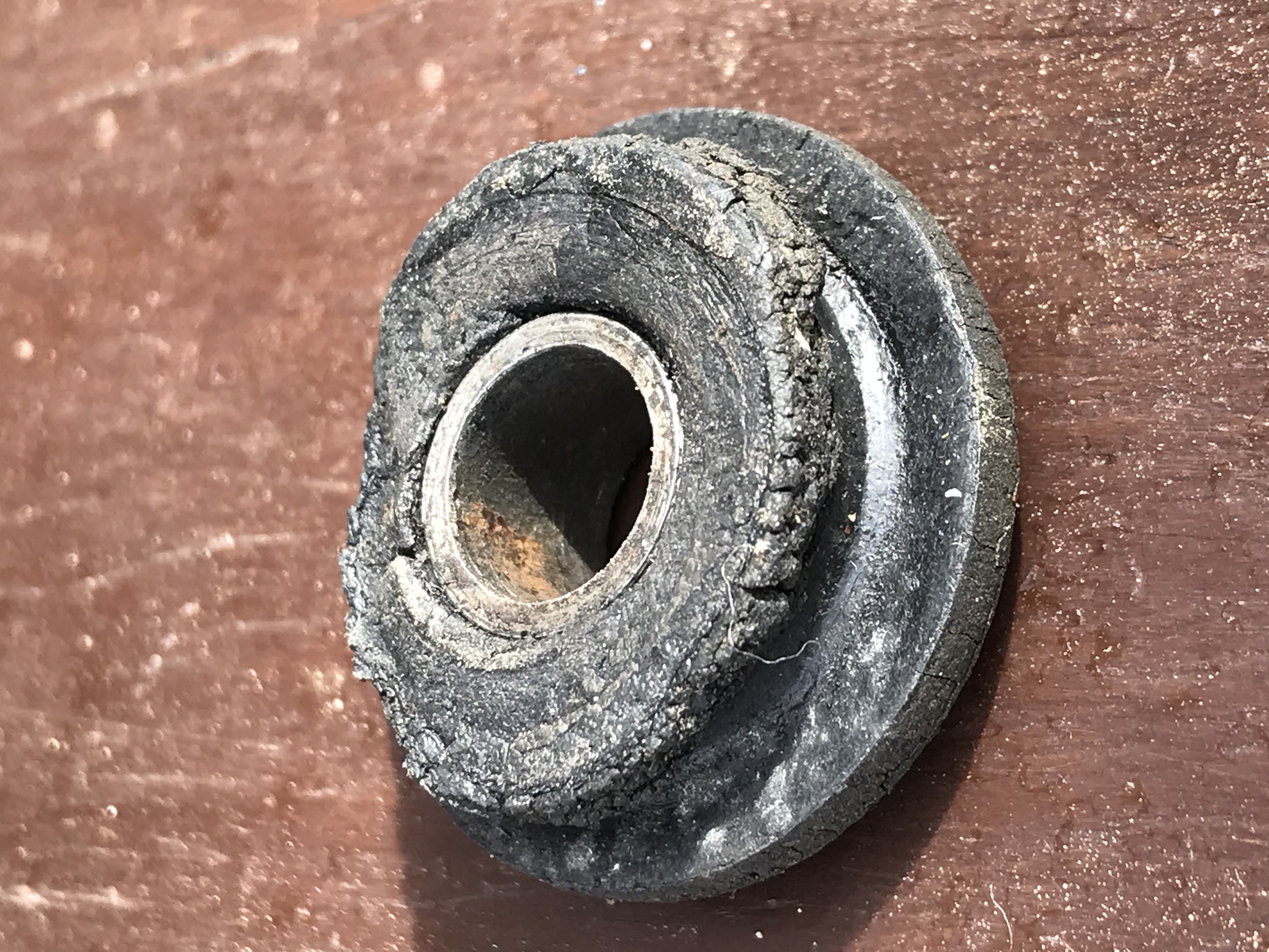

Does any one know where the right deluxe anti vibration oil tank mounting grommets can be bought, borrowed or otherwise? The grommets are quite model specific and have a steel bush in the central hole. I have tried several Companies that sell grommets, but none of them have anything with the right dimensions. Mine have perished to the point where I'm worried the tank could fracture. Not an unknown problem!

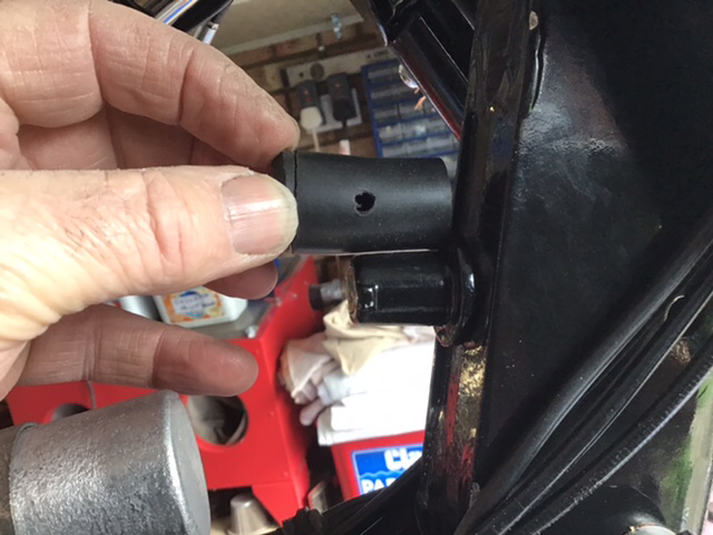

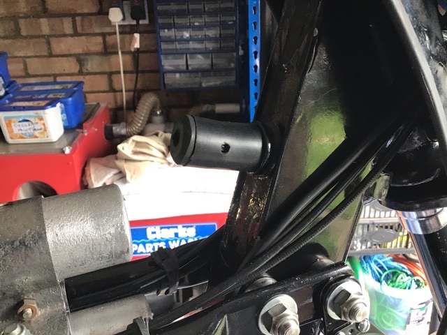

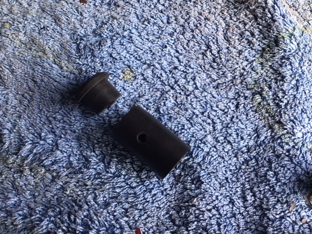

Ahh, the infamous front tank mounting - there’s a thread of mine (early last year I think) about this.  I resolved it by using the NOC part pushed into a tube of tight fitting rubber - see photos
Bruce

My grommets are rather worn out, but these are the measurements I believe will do the job.
Outside diameter of grommet. 27mm
Hole in panel 19mm
Panel thickness 1.5mm
Grommet thickness 10mm/11mm, probably 11mm
Steel bush length 9mm
Steel bush outside diameter 11mm
Steel bush inside diameter 8mm
As the steel bush outside diameter is 11mm and the bush is a snug/interference fit in the grommet, the hole in the grommet will need to be 11mm.
The outside diameter of the grommet is probably the only measurement that can be played with.
