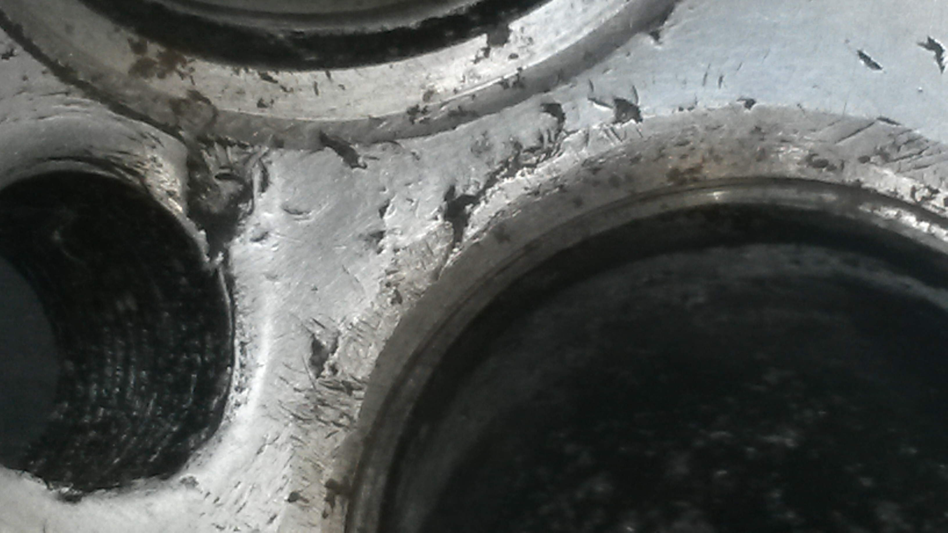

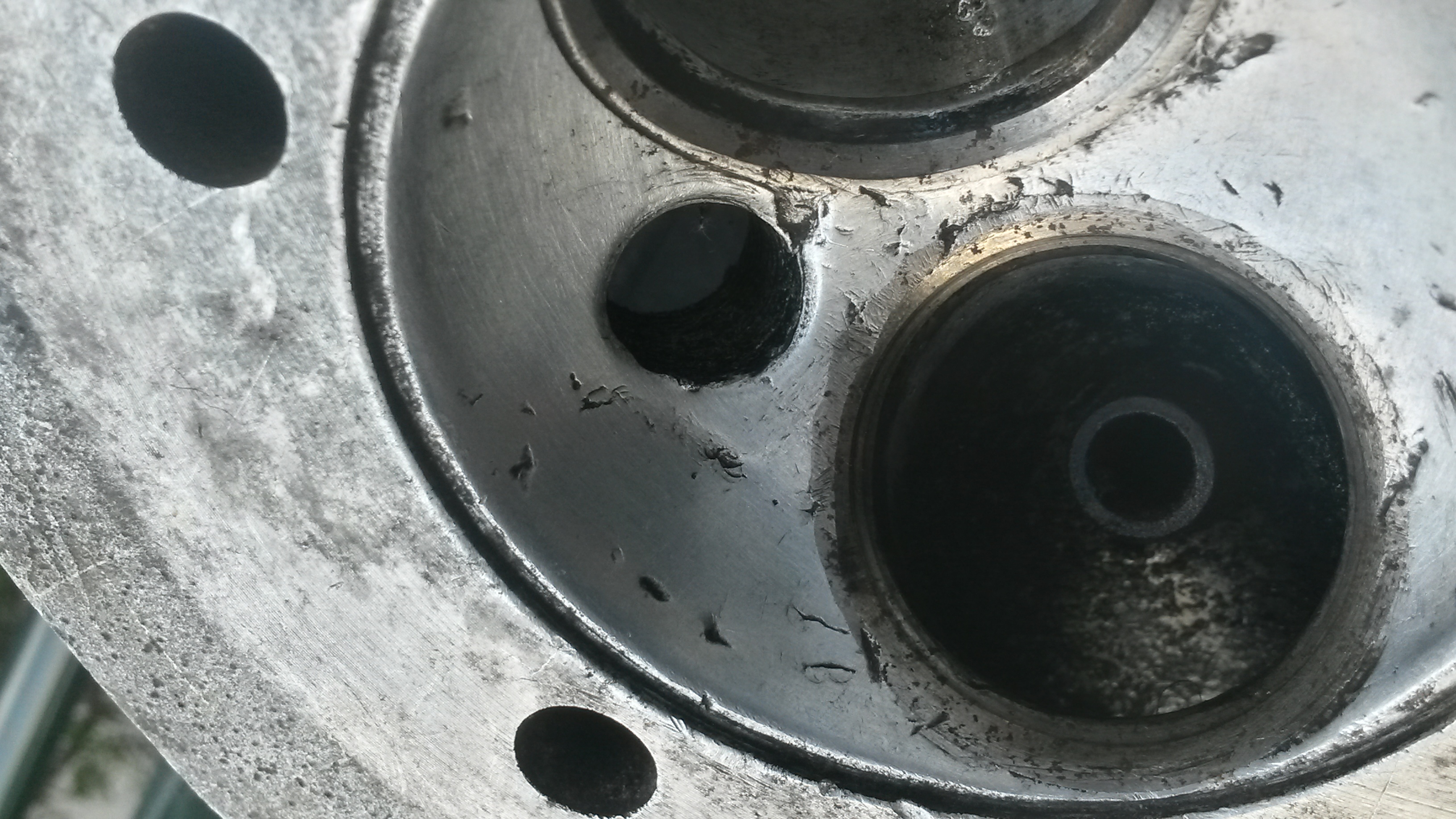

I've just taken delivery of a second hand cylinder head and if you can spare a minute or twoI'd like you to have a look and comment to see if it's suitable for use. One of the combustion areas is fine but the other appears to have suffered a bit of damage around the valve seat area and spark plug hole, there is some depth to the damage. What doyou think I should do. Thanks in advance, Mark
Attachments 2.jpg 4.jpg technical2-heavy-I wouldn't bother going a…
Oh dear, is it really that…
Oh dear, is it really that bad? I think they have two other ones in stock so should I get them to send another one before I name and shame?
Worth a try, if bought fro…
Worth a try, if bought from a dealer. "Not of merchantable quality" comes to mind, along with "Not fit for purpose". If they will not accept return, including delivery charges, certainly "Name and shame" (not only on the club site, but on any others that will accept posts).
Oh dear, Mark. That looks…
Oh dear, Mark. That looks to me as if it has dropped a valve head in. It's clearly been welded to rectify some of the damage and then been cleaned up by hand rather than machined.
It probably could be re-engineered but the costs would be out of proportion and most post-war Norton heads are not so rare that it would be warranted. If it were some sort of ex-works racer, for one season only head then it might be warranted.
Sadly, most old bikes and bits are close to junk. They always have been. What has changed is that we now expect to pay more than a fiver for them..

I thought for an instant that I was looking at some moudly Swiss cheese. Not in the best of nick is it? What is the outside like? These itmes are repairable.....but probably not worth doing. You can pick up a reasonable standard complete 88/99 head on this website for £100 or less.

There obviously has been a poor attempt at repairing this damage but as these parts become more rare, this one is salvageable, It would require some good quality welding, dressing and new valve seats and guides but not beyond it by any means. These components have probably been abused for over half a century my a string of home "experts/butchers". You are unlikely to get a pristine item and some of the damage to the surface of the combustion chamber, whilst not ideal, would probably not make a lot of difference to the performance of a "run of the mill" motorcycle, and let's face it, these machines were just that, everyday transport.

If it needed remedial work it should be in the description. The worst thing about that head was that someone had attempted a repair, but very poorly. Who knows what damage lurked beneath that dodgy repair, was it cracked between valve seat and plug hole? No way of telling now. I must confess my original post was a fish for comments, I knew it wasn't fit for purpose as soon as I looked at it.

I wouldn't bother going any further with it; it looks horrible. How do you make a head look like that? I can't see how you are going to get the valves to seat properly with all that damage.
I think it's back to square one and maybe a frank and business-like discussion with whomever sold it to you.
