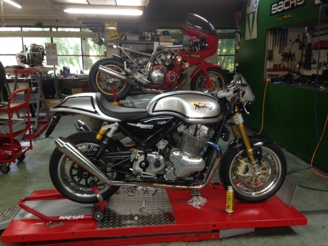

Thank you Terry
I did order some from South Bay Norton.Be careful, the pictures shownon their webpageare the pipesof the old and discontinued system (Dominator Sport). Attached foto shows the look of them.
Raphael
I got the pipes wihin 6 days fromLos Angeles to Switzerland. Good service and they sound awesome.
Raphael

Terry, you express exactly what my first impression was. The design of the pipe is like this because theupsweep angle is dictated by the same angle of the top back subframe.
I am getting used to the look and will have following advantages compared to the original pipes:
- all stainless steel, thus lower risk of corrosion
- better ground clearance
- distance between chain and right hand muffler is bigger, thus chain should not touch the muffler
Regards, Raphael

norton961se-jpg
