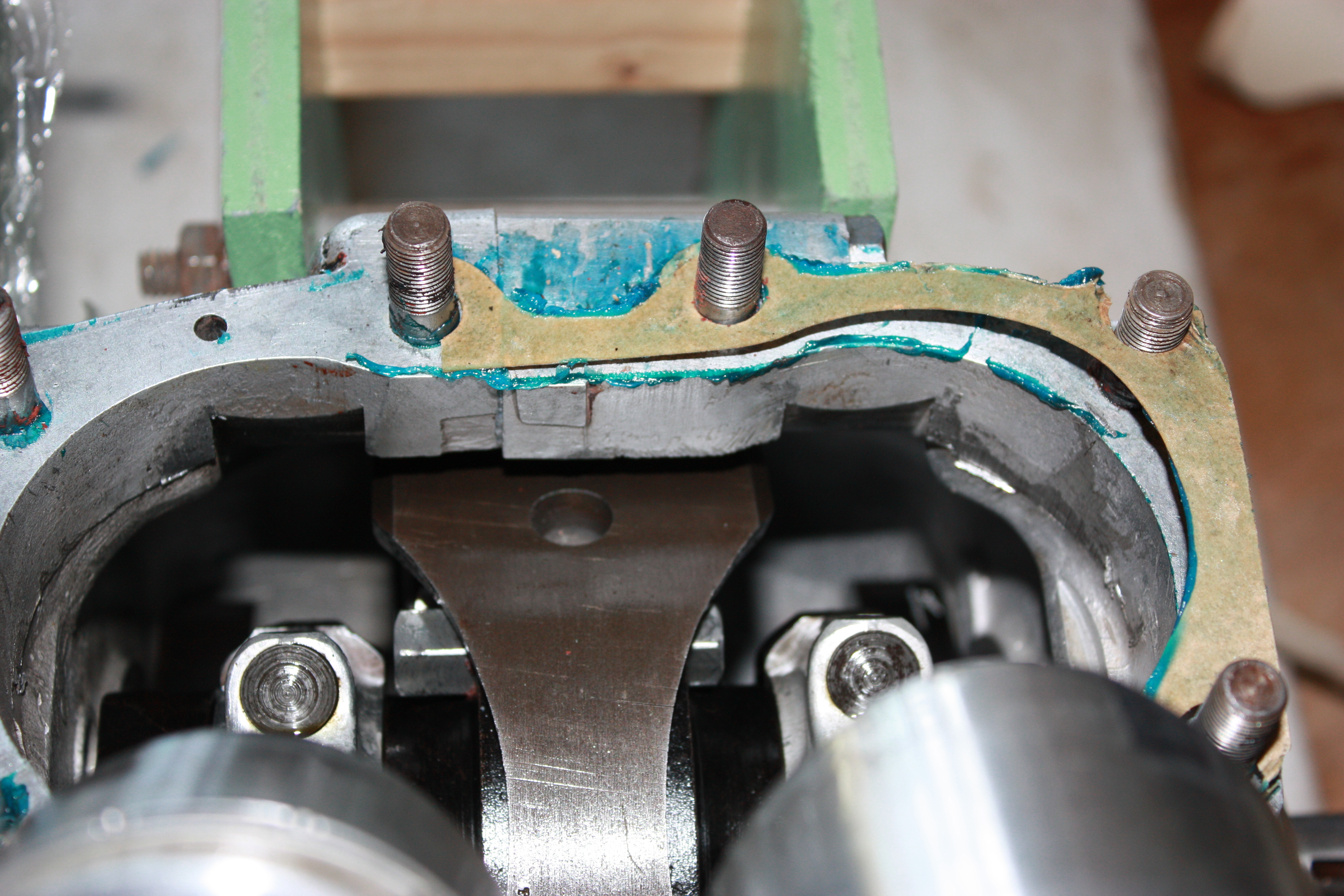

Ive taken barrel off & found that the pistons have ground into rear of crankcase, the left hand which appears to have scuffed most has left the gudgeon pin free but the right hand gudgeon pin is seized. Can someone make sense of why the pistons have touched like this .
I have enclosed a couple of pics to hopefully show.
That's really odd. The…
That's really odd. The piston skirts should not get near the case . I'm wondering if you have mixture of parts. What are the case numbers. The pistons do not look too damaged in the important areas as long as no cracks.Some photos of the engine may help. A wild guess, 650 /750crank in 88/99 cases and 99 pistons?. A conumdrum.

I have however found that the barrel wont mate with the casing leaving it about 10mm off, it is also rocking on timing side cam barrel extrusion, I must have forced it down with bolts, so this could be a reason? looking down the conrods look central .
The bottom spigots should go…
The bottom spigots should go into the crank case. So it should not be possible for pistons to touch cases..unless barrel is back to front!
A photo of the inside back…
A photo of the inside back face bottom edge of the pistons may help. David, if 99 long skirt pistons are fitted then they will go further down than the barrels and hit the casting flash in the cases. If you are right I will buy you a beer next time we meet.!.

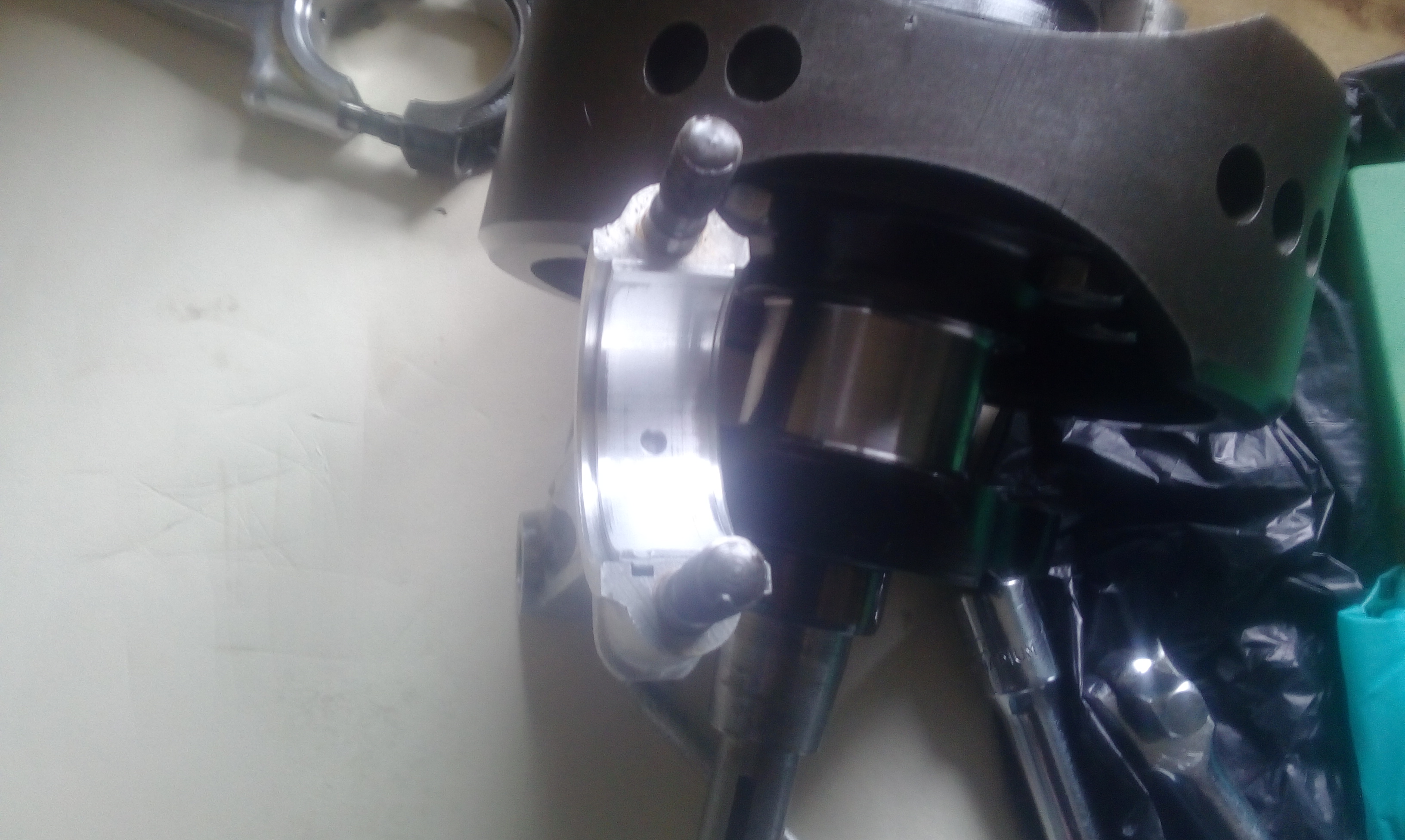

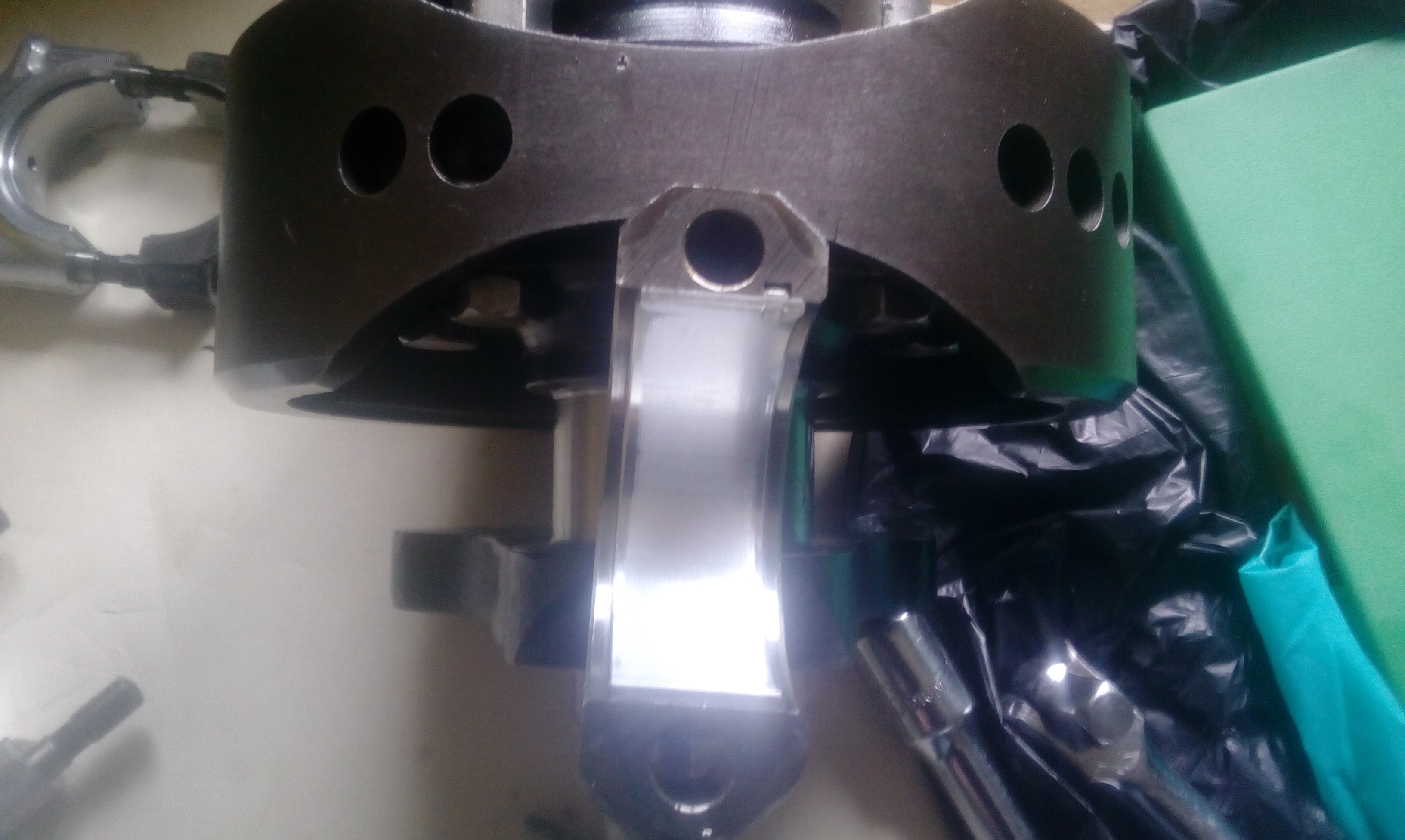

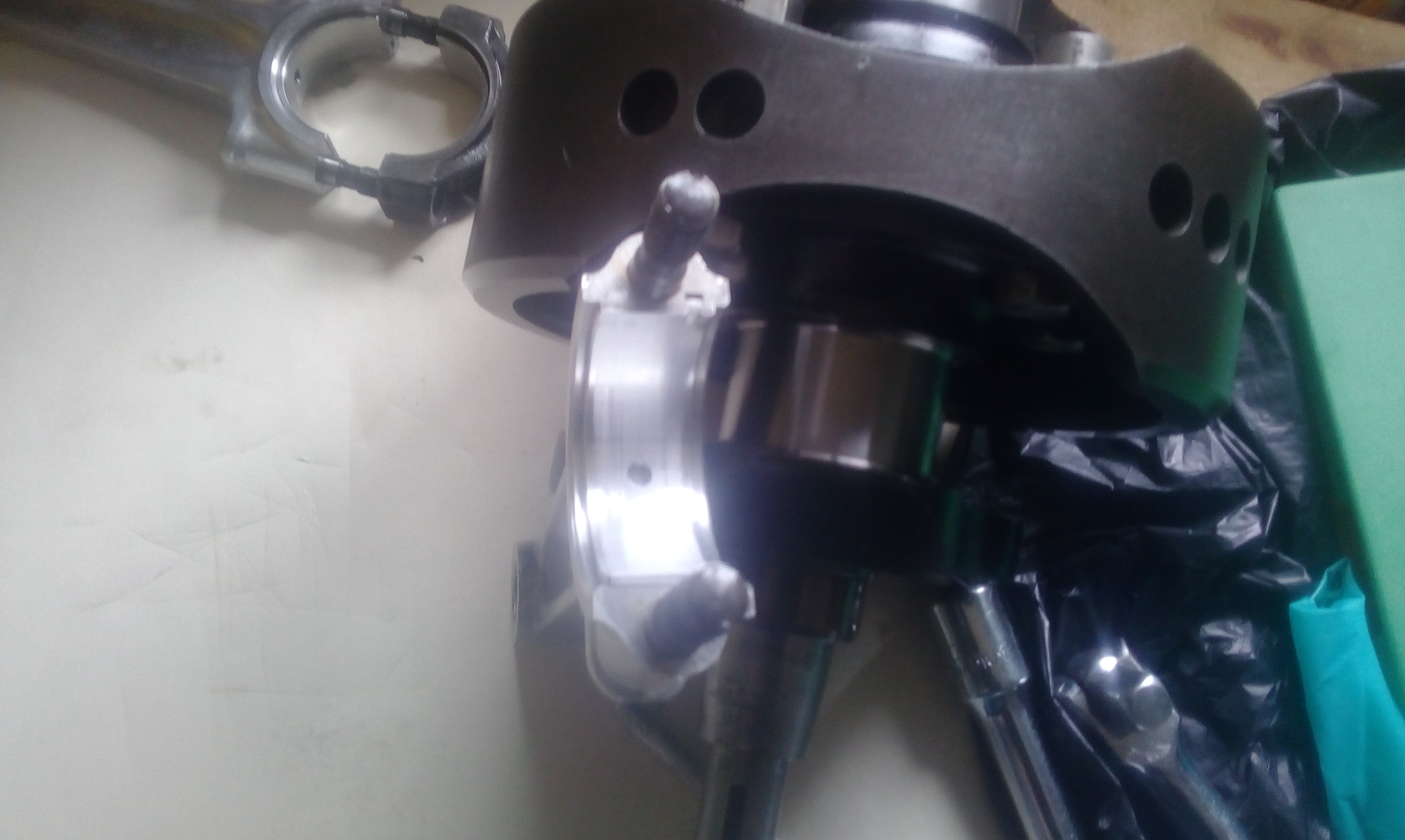

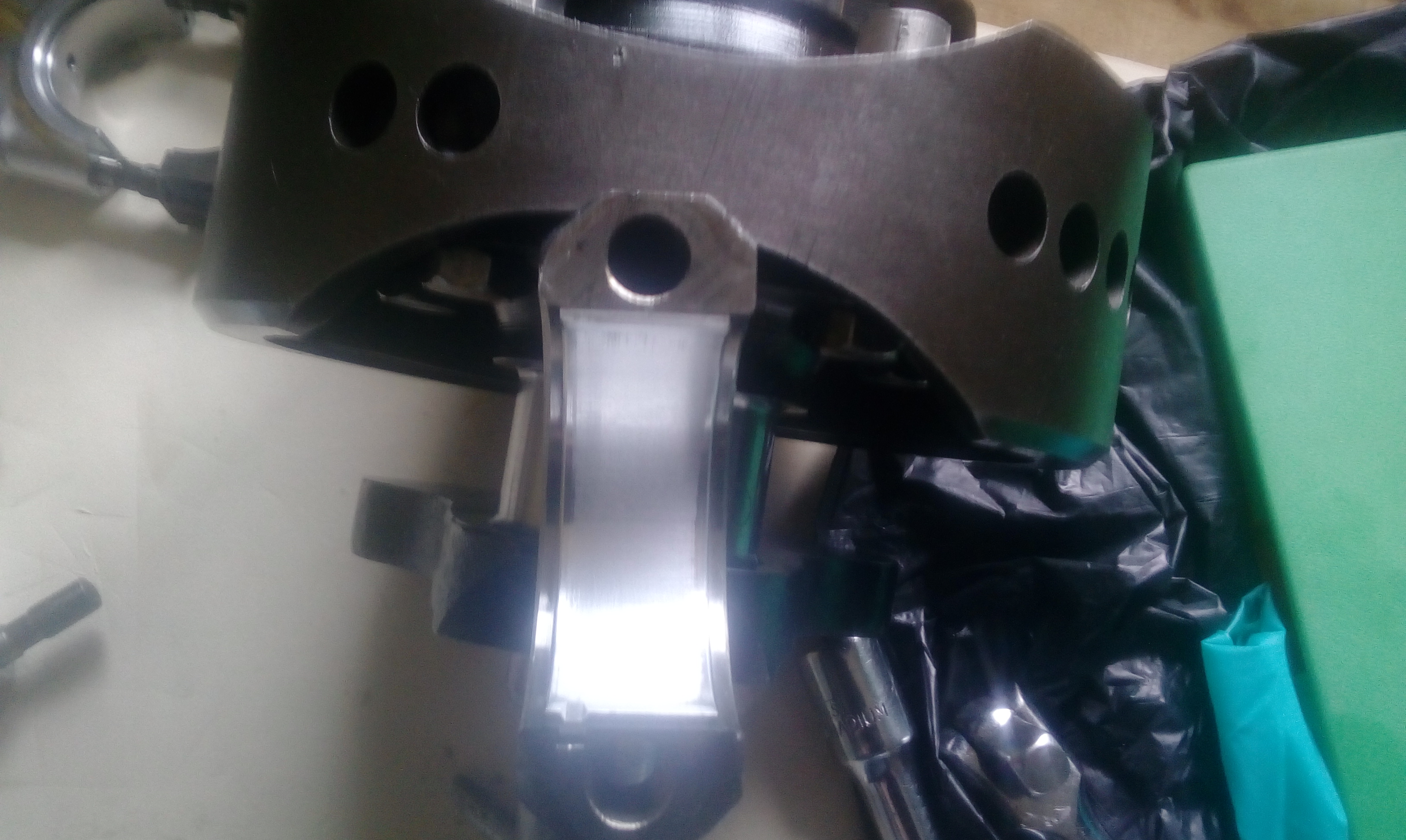

Big end shells
I have ground the case to accept barrel, I have discovered that the pistons are larger at the bottom I found that they were tight but after moving them I believe they will be ok I guess the reason is so they don't flap about which is probably a bit of an exaggeration.
Because the conrods didn't go round absolutely smoothly feeling a very slight binding in a place or two I have broken them back down, I can see some shining up but I'm at a loss as to what it means, I cant go back to the machine shop for them to have a look as they will be closed, so Robert if I sent some pictures would you be able to give me your opinion on how they look?
Sorry to be a pain. Cheers
All pistons are tapered with…
All pistons are tapered with the bottom largest as the heat from the combustion chamber makes the top of the piston expand more at running temps. The shine on the bearings is where they have contacted the crank journals, did you lubricate the shells with assembly lubricant before torquing up the con rod bolts.

I have no doubt that the…
I have no doubt that the rods are slightly oval, Something that happens over time. The Ideal would be new rods. And they are availiable,if a little expensive. The next best thing would be to get the rods re-sized,but as you say,not practical at present. You could give them a thorough clean ,and the back of the shells to make sure there is nothing there. I am guessing the shine is near the ends of the shells where they meet?. In the old days they would have "scraped" the bearing to releave the tight spots, I don't think you can do that with the shell facing you have.If it were mine I would scrape the rods (not shells) at the tight areas a thou or so till it all turns freely.Also give the crank journals a polish with very fine carburundom paper. All at your own risk. I have done this before and no problems but its usually frowned upon!.You could get a plastigage Kit thro the post to check bearing/journal clearance.Also check the big end caps not switched.
After looking at the pics…
After looking at the pics hopefully you can see shining areas do you still think that they are oval?

Those shell photos are…
Those shell photos are exactly what I expected to see. Running too tight , no clearance for the necessary oil boundary.
