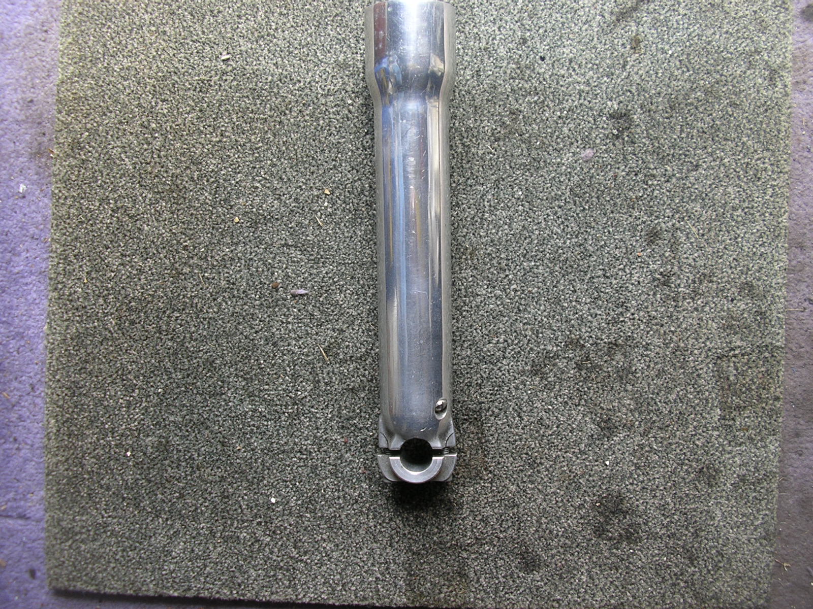

Hi All,
Noticed this hairline crack on the pinch-bolt fork slider on my Dommie 88.
Has anyone had any success in repairing this sort of damage - or will I have to fork (sorry) out for a new one??
Thanks,
Aston

Dresda were offering a service for cracked sliders - they took the bottom off and fitted caps as per BSA/Triumph.
Mick Hemmings used to put a fibre washer in the slot before nipping up.
The attached photo shows my Dresda Slider clamp conversion. I did not actually like the end result due to the spindle hole size and position.  Finding that the spindle and cap were both able to twist under heavy braking.
Originally I had taken the broken slider to an Aluminium welding specialist for repair. This chap offered a basic welding job for around £50 plus VAT.but would leave me trimming the rough finish in order to make the leg presentable. He offered to do the same grinding and polishing for nearly £150 plus the dreaded tax. In the end, after going for the equally expensive Dresda conversion and not liking the result, I purchased a new Dominator slider from Andover Norton.
