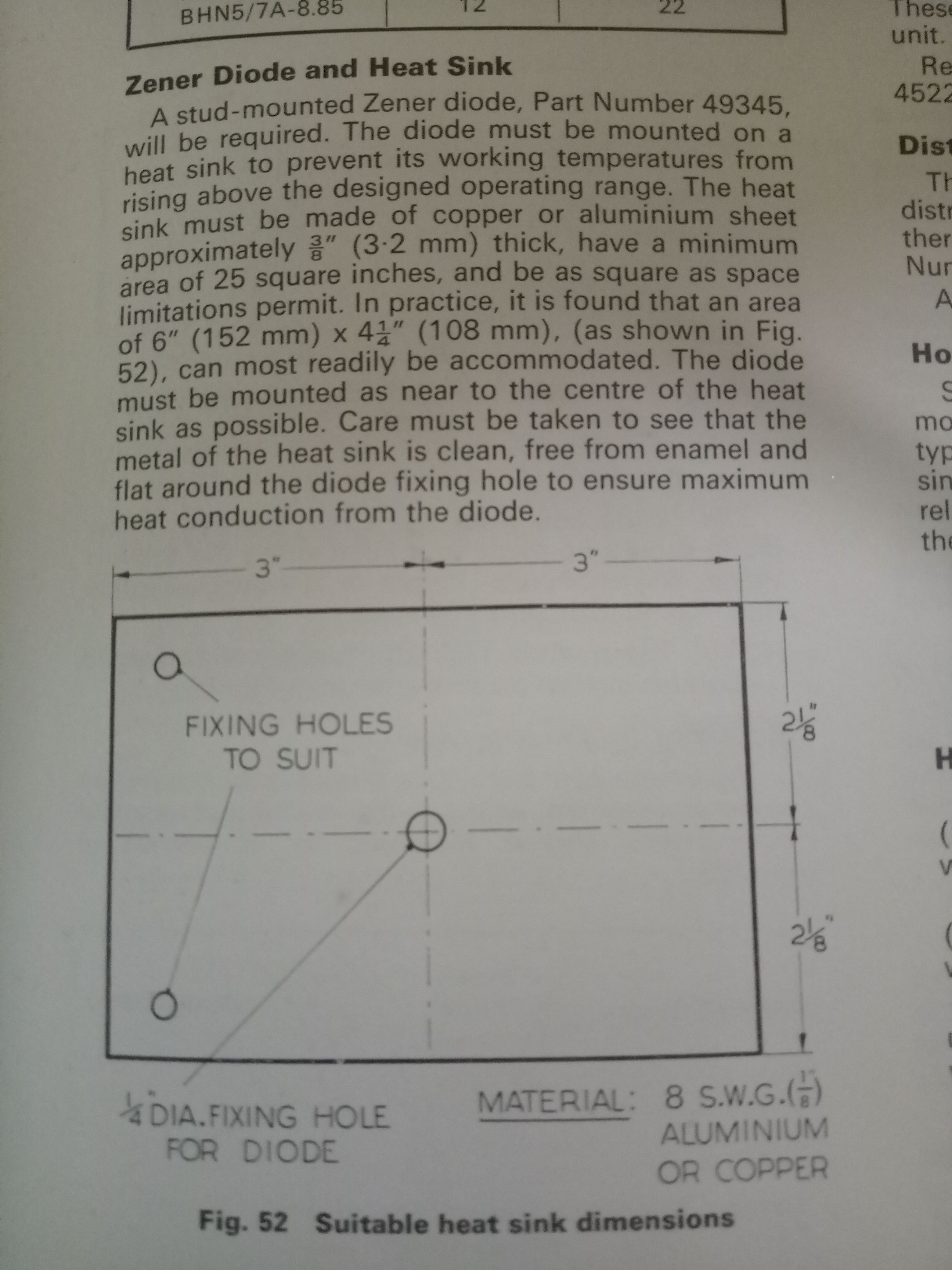

hello i want to make new cooler for zener diod can somebody say what is diameter of circe?

Glad that a sensible maker would look at the drawing  and not read the text! 3/8" thick is a big bit of metal!
Well spotted George.  Another factory publication with a typo.  Not uncommon.
For my 650SS, I calculated the surface  area from this article but used an alloy wheel removable centre from a locally made Oz car.
Has worked perfectly for 15 years.
... if I was making one I probably would go for 3/8" thick. The Z plates on Commandos which were used as heat sinks are pretty substantial!
