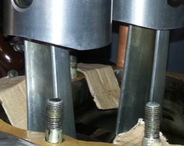

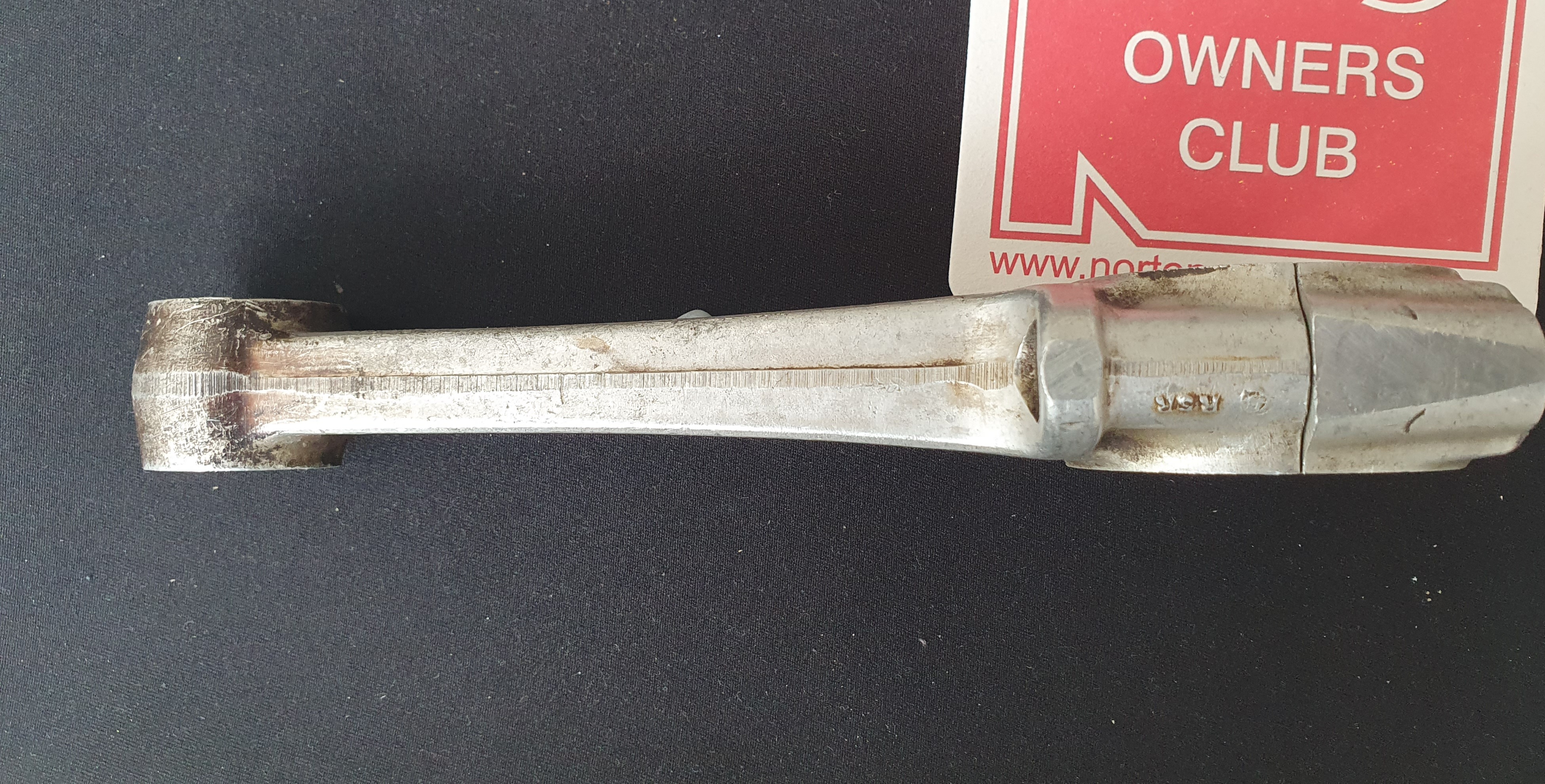

Were Dommie conrods polished at the factory?  I have an old pair which are not polished and have fettling marks across the edges.  The ones in the 88SS are polished.  I wonder if that was by previous owner? I remember that at least one of my books tells us to protect the edges of the rods from picking up nicks from the edge of the crankcase when the barrel is removed.  Just curious.
In my experience,  they all look like your first picture, 88ss included. Any that are polished have been done by POs.
In his book about Dommy tuning Paul Dunstall talked about polishing controls to remove stress-raisers, so obviously they must not have been from the factory.

On the matter of polishing, it is many years since I last read Irving's "Tuning for Speed", but I think it says when filing off the flash along the shank, to do so in a single direction only, ie not simply across or with an up & down motion.
If you ordered a new Norton to Sports Special Specification from 1958 onwards, for lots of extra cash you would get an engine with all kinds internal 'go faster' goodies. This would include HC pistons,  polished cylinder head ports, polished crankshaft and polished rods.
This Factory extra was available up to the close of Bracebridge after which only the 88SS and 650SS  were kept on the 'road' models list with the Atlas being added a little later. However, the SS suffix, although standing for Sports Special did not include any significant tuning.
