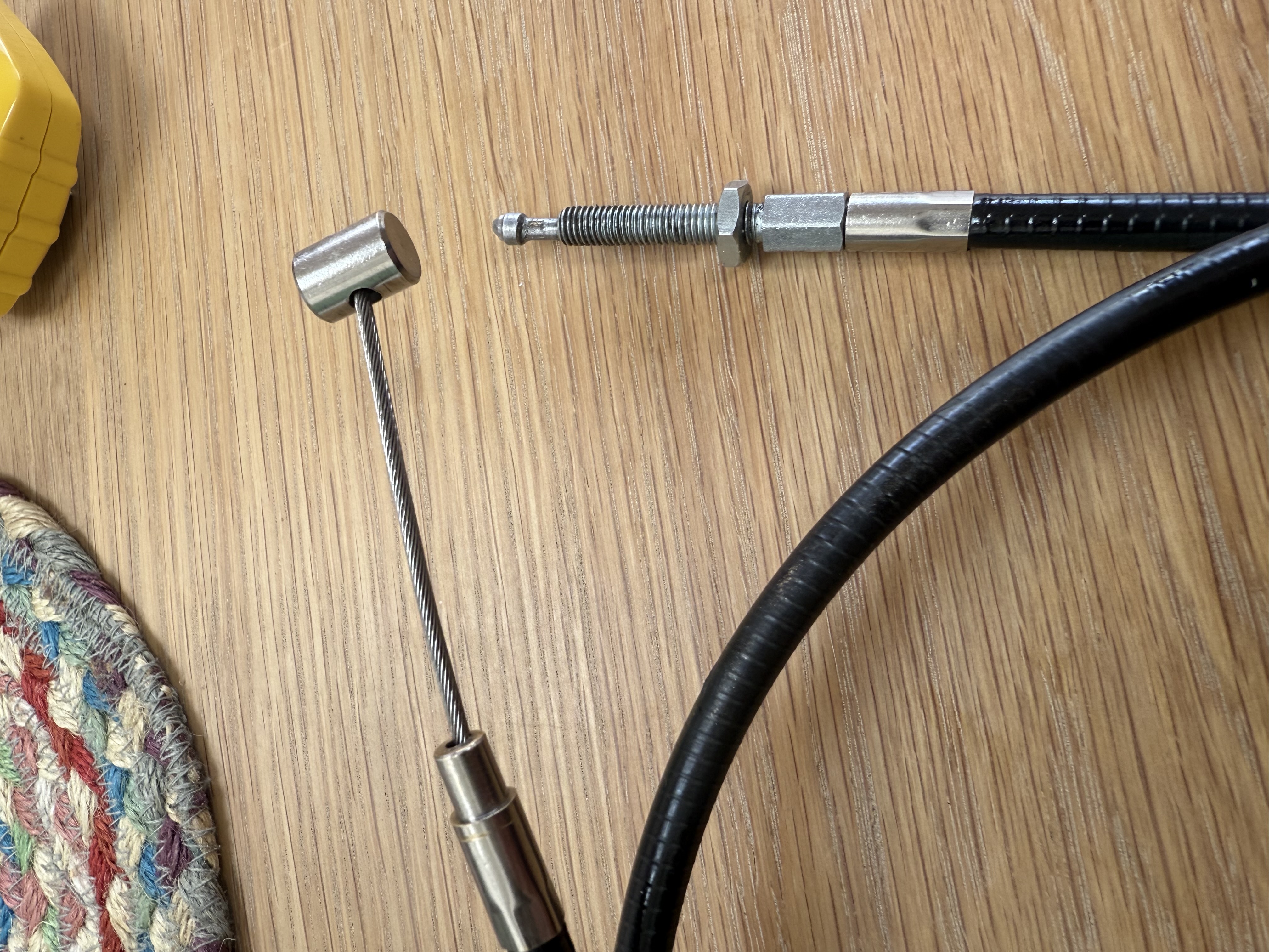

I have just returned from another bedding in run with my recently resurrected 650ss bitsa. I was making progress in top gear on a nice straight road when I noticed extra slack in the clutch cable. The cable still operated the clutch but I eased off all the same. A couple of pulls later the whole thing was loose and no clutch was available. The lever was flapping about and I thought the cable had snapped. This was a worry as it was only 150 miles old.
Anyhow - I managed to limp home as the roads were quiet and the junctions clear and I only had to push the last 100 yards or so. Onto the bench she went and long story short the cable is not snapped and to be seems intact. It doesn't even seem to be stretched.
It's a miracle!! Apologies for the clickbait by the way....
The clutch itself is a standard chain drive primary unit and was adjusted correctly (IMHO) as per the manuals. In use the 'bite' point was within the first inch of pull which includes the 'slack' built into the pushrod adjuster. Whilst heavier then I'm used to on more modern machines, was acceptable at this stage in the bikes resurrection. I've also been having issues finding neutral which means I have been holding the clutch in at junctions etc.
The cable is now off the bike. It came from AN and there are two inches of cable visible from the end of the ferrule to the first part of the barrel when the nipple is tight to the thread. The only work on the bike recently was to tighten up the primary drive chain which was too loose/noisy. Other than that this is the first clutch related issue so far. At least today most of the oil stayed where it should so progress is being made!
Any ideas? Is it sensible to continue to use the cable for example?
Thanks for your time
Kit

OK. After due puzzlement and looking at the AN pictures of the cable, I've refitted the cable using a more sympathetic cable run and allowing for better curves. This seems to be better set now.
The nut and adjuster were in place (my first thought too) and the pushrod also looks fine - this was also a new item from AN so can't think this was the issue. I forgot to mention that I have new plain plates on the bike, new 650ss springs and that the clutch basket is in relatively good order. The driving plates were ok and I've not noticed any slipping. If anything there was a slight bit of drag on the clutch earlier today. Primary chain is set at 3/4 inch of movement and doesn't seem too tight. The clutch is back at full extension so I'll need a new primary chain at some point.
After refitting the cable the clutch action seems lighter now which is weird. In fact it's all a bit weird to be honest. Only thing for it is to have another run out at the first opportunity, but not to far!

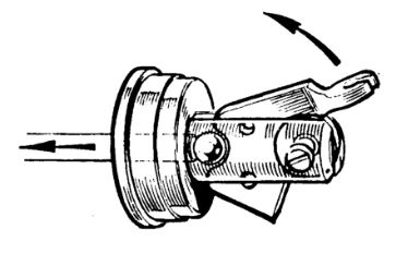

Other Possible Issues
There might be problems at the actuator end of the gearbox mainshaft.
The shaft nut may be coming loose or the actuator locking ring unwinding.
Also the actuator arm can sometimes slip and drop down off the ball bearing.
Everything seems in place -…
Everything seems in place - the actuating arm remains in the correct position, remains solid and has not moved around - i.e. it remains in line with the cable The ball bearing also seems engaged.
I'm wondering if the cable jumped out of the adjuster on the handlebar under tension but at the time there was zero pull on the cable and it was flapping about like the cable had been cut.
The only way to be 100 percent certain of course would be to a. Strip off the chain case and the clutch (again) and b. Open up the gear box and check the actuating arm - but it does seem fine when viewed through the the inspection 'hatch'. The clutch and cable seems fine now it's been refitted.

Ferule movement
Check that the cable outer end ferrules are crimped securely. Maybe either or both were not secure until the weight of the clutch pressure squeezed them into place.

Update & Thanks
Thanks for all the pointers. Just returned from a 40 mile round trip with no issues - other than rider errors anyway. The clutch cable is much lighter and easier to use and the bite point is just right. As an added bonus neutral is much easier to find so sitting in traffic lights is much less stressful.
I can only assume the original cable run was tight somewhere. On inspection there is some scratching on the outer cable about 8 inches from the gearbox end. The ferrules also might not have been properly bedded in. Time will tell but the set up as things stand is pretty good and certainly much lighter than of old. My left hand is very happy.
