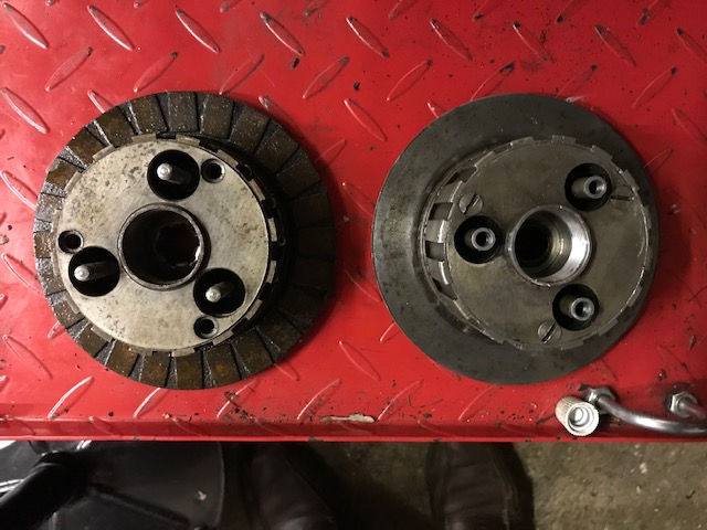

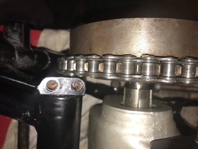

I’m currently building up a 1954/5 prefeatherbed swinging arm ES2. I have fitted a laydown box but cannot get enough clearance behind the clutch for the chaincase. I have two clutches, one is better than the other in respect of fit. I have measured the depth of the splines in both  - see the pic below  . The one on the left has an RGM spider which I guess is AMC . The clutch with the RGM spider gives approx 2mm more clearance than the other ( 17.5 vs 19.25 mm deep splines) so I fitted the RGM one and checked the alignment with the engine sprocket, it appears to line up with the middle offset sprocket. However you can see in the other pic that it gives only just enough clearance to miss the swinging arm mounting, there’s no room for the chaincase. If I fit the other clutch, the primary chain fouls the mounting. Prior to fitting the laydown box it was fitted with an AMC box, that gives more clearance and it was using the largest offset engine sprocket.

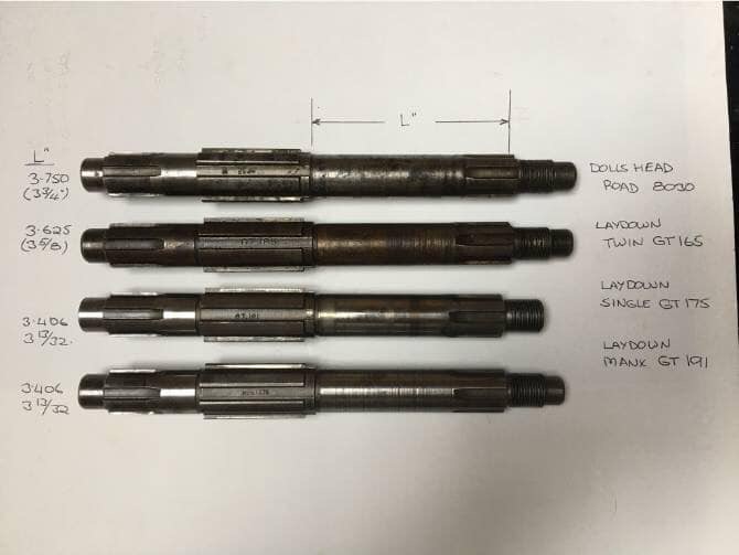

Curtesy of Geoff Clatworthy -
Shafts
That makes it look like I ended up using a twin mainshaft ?

The single has the shorter GT 175 mainshaft and the twin the slightly longer GT 165 mainshaft. The 165 is only 0.070" approximately longer overall.   Lay down gearboxes also use a GT 172-3 mainshaft sleeve gear not the N 8032 used in other  boxes.

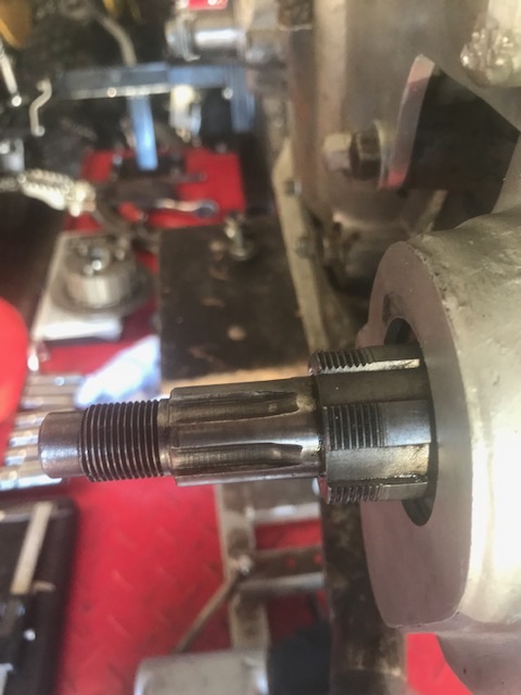

I think I’m going to have to take the gearbox apart to see what is in there. Do you know what mainshaft is in yours? And if possible it would be helpful to know the distance between the gearbox face and the top mounting lug on the gearbox,

There is no quick way to determine what shaft is fitted to my '56 19S but photos of the clutch in situ show that the mainshaft does have the plain section at the end - which is missing from the GT175 example shown on Geoff's photo of the shaft variants. As Duncan has suggested maybe the sprung frames require the longer shaft to clear the swing-arm pivot? My engine sprockets are offset to the outside, which might support that idea.

Geoff has commented that he’s got the Manx and single picture reversed so the single should have the plain section of shaft, but I wonder if this a common problem resulting in the twins shaft being fitted to the singles?! So you measurements are very helpful as they should confirm what I can expect if I go down that route.  I’ll measure the mounting in a mo.
