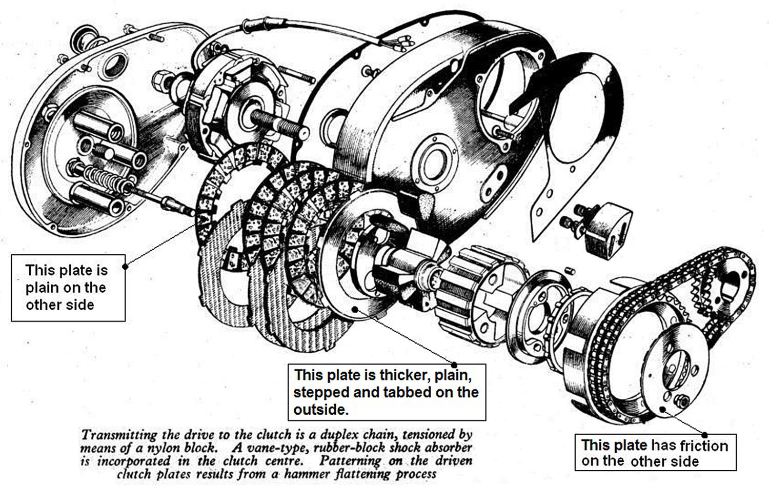

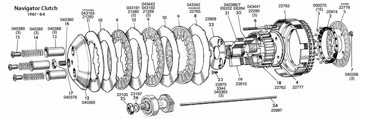

Early Navigator clutch
I have added a couple of images I doctored in Photoshop to try and get an accurate image of the early Navigator clutch as none of the Norton images are correct. Hope these might be of use to others as well, I reckon if there are any faults with them someone will come in and correct them.
From the rear
Hope this helps,
Stan
Looks like the plates are the same, anything else?  Things like spring cups, pressure plate, shock absorber rubbers and so on.

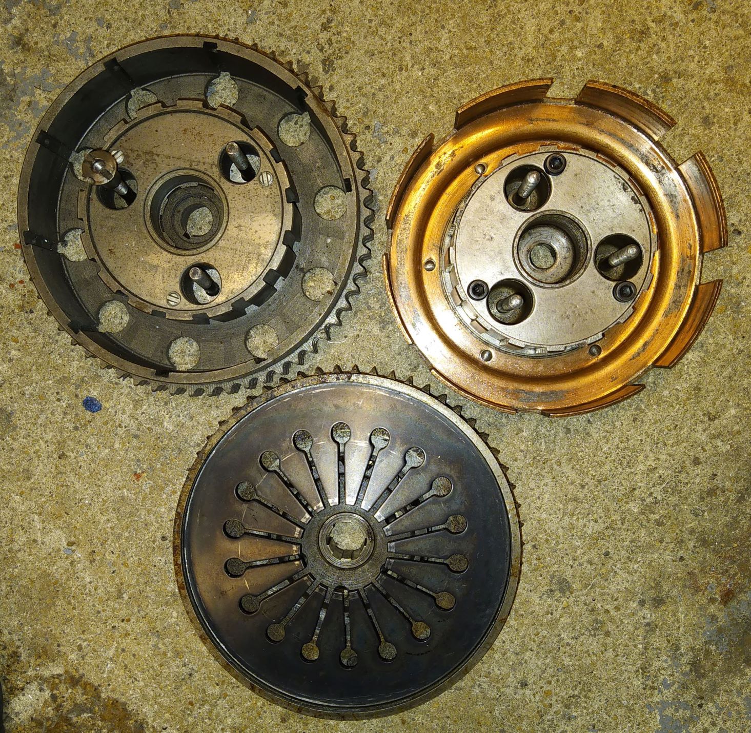

The reason I speculated that the light and heavy twin clutch are similar is that I had a light clutch sat on the bench alongside a Commando and a Triumph T140 clutches.  I was surprised to see the light clutch diameters very similar to these.  Not a very "scientific" way of doing things but it did pique my interest, hence the question.

The Dominator clutch & Lightweight clutch do share some components, luckily. However, its difficult to be precise as both changed over the years.
But two items differ for certain - 1) The clutch centre has 3 different fitments on the Lightweights, none of which fit the Dommi & 2) The clutch basket inc sprocket has a single row sprocket on the rear, while the Lightweight item uses a Duplex chain.
The plate sizes are the same for both - someone above thought they were different - not so.
The only sure way to see what fits what, is to use the parts list booklets to compare the two.

Attached is the photo that got me speculating about the clutch.  T140, Commando and Lightweight clutches together, drum diameters very close.  I'm a big fan of the Commando's diaphragm spring, surprised it hasn't found its way in to more bikes than it has.
I've modified the lightweight clutch to take different springs to make the handlebar lever action lighter.  Doesn't really need it but wanted to try.
