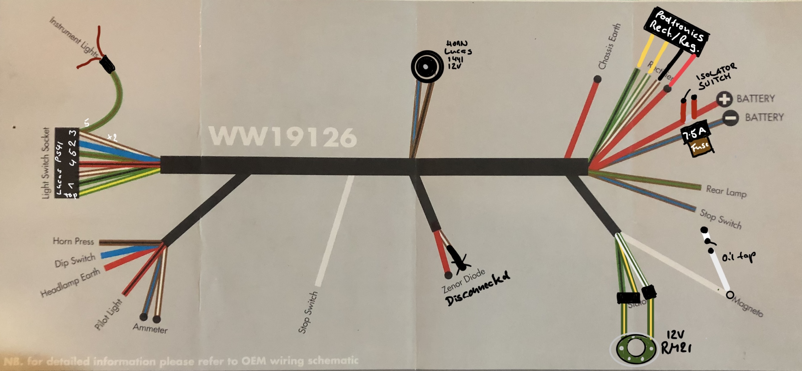

The green/black and green/yellow should be joined. That's one side of the AC generator. The white/green is the other side. Each side goes to one or other of the yellows. The red should be +ve, and black -ve.
The green/white goes to one of the yellows on the Podtronics and the green/black goes to the other yellow of the Podtronics. The green/yellow goes to the light switch socket according to Holger’s and my wiring diagram. My wiring harness is new and that’s where the green/yellow is going. That is curious.

You don't need the light switch to cut out part of the alternator if you have a modern rectifier. You need the same two outputs as Holger's diagram shows for RM21 by joining green/black with green/yellow to provide one of the two outputs so it behaves like RM21.
Thanks for pointing this out, I now see to join the green/black with the green/yellow to provide one of the two outputs so it behaves like RM21 in Holger’s diagram.

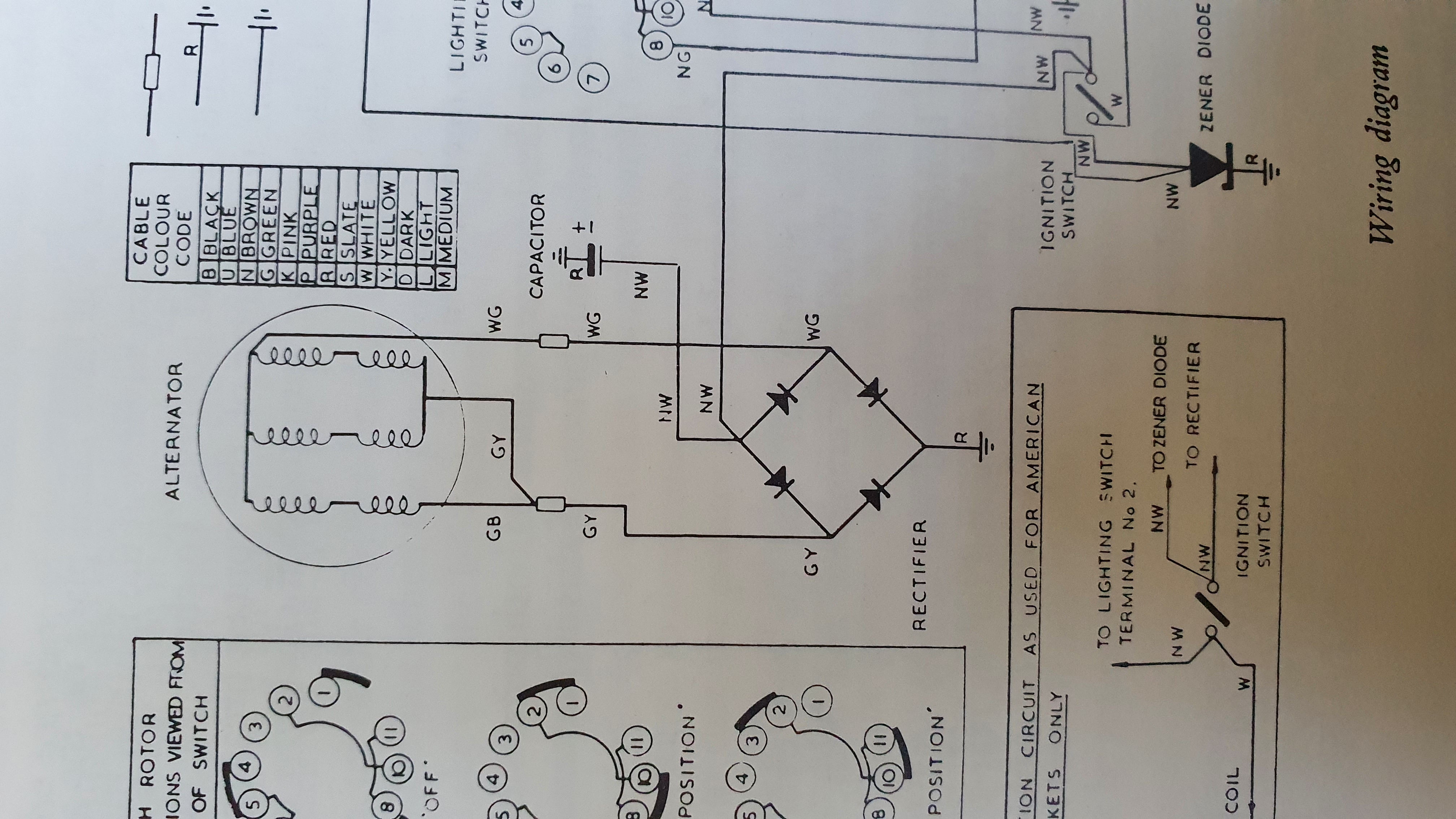

The common is the white/green.  If you look at the photo attachment with my earlier mail, you will see that the green/yellow has two coils working side by side together, and the green/black has one. So resistance between wg to gb will be twice as big as it is between wg and gy. Sounds like yours is probably OK (but I don't know values)

The second wire going to the other yellow wire is the green/white, which starts directly at the alternator. Usually GRN/BLK and GRN/YLW need to be connected on the harness side if you have a two wire alternator like the RM21. I assume the wires of a three wire alternator should connect with the respective alternator wires as intended, alternatively all remaining wires (except the GRN/WHT) are joined, emulating a two-wire alternator.

Back to the above posts re wiring. There does not need to be any light switch wiring/alternator wiring involved with the light switch  GRN/BLK plus GRN/YLW to one YLW    WHT/GRN to other YLW. on the reg/rect.
The WHT/GRN goes to one of the yellows and the GRN/BLK-GRN/YLW goes to the other yellow.
The GRN/YLW going into the main harness is disconnected.
