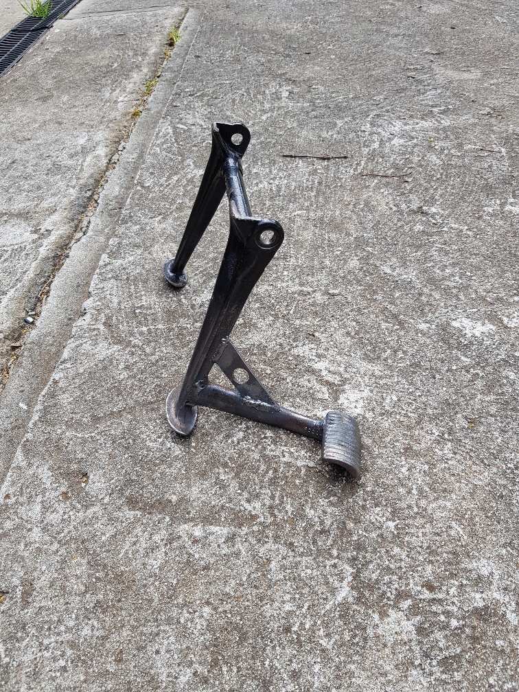

Ian,
I agree the ES2 is a pig to get on the centre stand.
I welded an M20 BSA brake pedal to the stand and the transformation was miraculous!
So much so that I find it hard to fathom why the factory hadn't thought of it.
It might be possible to do…
It might be possible to do something similar to a featherbed stand.
Heaving

That looks...
... like a great mod Don. I may consider it for the future. Fortunately I have a prop stand so only rarely need to use the centre stand.
