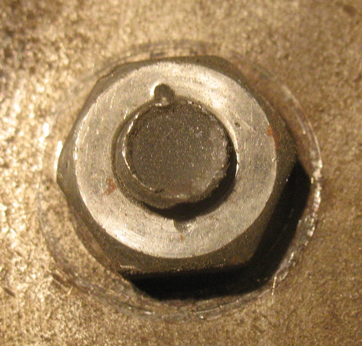

My understanding has always been that you "centre pop" with a "centre punch". That is, you place the point of the punch on the joint between the bolt and nut threads and give it a stout whack with a hammer to distort the thread and prevent further movement.

So if I have understood this correctly .........you centre pop with a centre punch but off-centre because the thread is on one side.
Generally on most Norton Twins this is done to the crankshaft nuts and the oil pump screws. Are there any others???
Clutch thread studs
The threaded studs that hold the cups and springs in the clutch are centre punched from the rear of the basket - just done an ES2 and a N15CS.

Centre popping bolts to me means using a punch to make a mark between the thread and whatever its screwed into, to stop it coming undone
